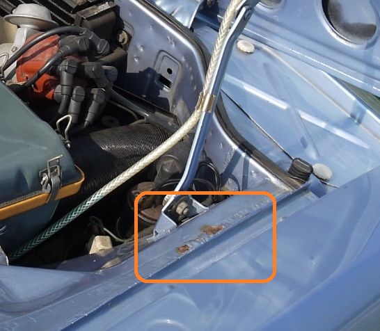

Rust bubbling up on the inner fenders is concerning:

Rust bubbling is very disappointing after so much metal work.

I've seen rust bubbling up on very recently-restored cars. All has to do w/the prep.
Blast, etch prime, epoxy prime, paint w/lots of time in between.
Oeps!! I did see only small sized pictures before...
The inner fenders do have some serious isues!!

Should the inner fender rust be a deal breaker necessarily ?
I think that “rust bubbling” is a bit of a stretch. The fender design is terrible with that water damn and no with no exit path. It looks more like peeling paint and superficial surface rust to me.
