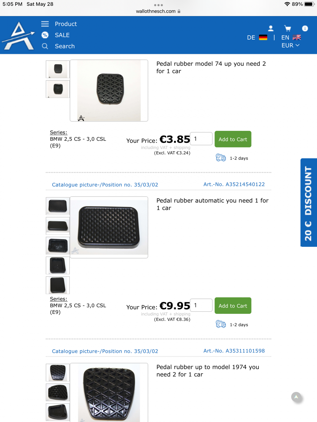

Chris is right. I’ve done this conversion three times. You don’t need the pedal box just the pedals. Both pedals. You can’t use the auto brake pedal. Also be aware that 74 and later clutch pedals have a larger clutch return spring mounted on them that slips into a notch on the pedal box. Earlier style (pre-74) pedals used a spring that simply hooked to the pedal box. Pictured are a set of 73 pedals I sold a few years ago. Should go without saying but only pedals from an e3 or e9 will work.

There are indeed THREE different brake pedals for our coupes….All three have a different shape.
Early
Late
Automatic
