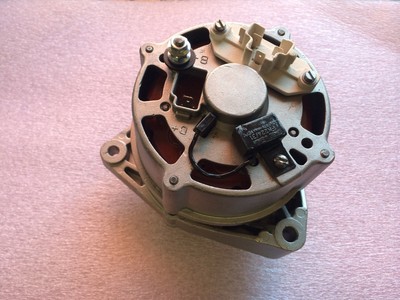

Red generator light on. I had the alternator tested at a trusted auto electric biz, and it is no good. The tech said it would be more expensive to repair it than to buy a rebuilt one, but he did not have a source for it.
My car is an early 1972 Bavaria with the 3.0.
I checked eBay, but none of those specified for a Bavaria looks like mine. One for a 2002 is the closest.
Where do I find a rebuilt? Even a known good used one would be fine.
The back of mine looks like this...

Original Alt is 55AH, 2002 is a different mount and was 45AH. You still have an external regulator based on the three prong terminal. You can change to a single wire Alt which is internally regulated if you want. Check AutohausAZ or eBay for rebuilt ones but they are pricey. Jim at Mesa Performance in Costa Mesa can ship one to you, he knows which ones fit.

It looks like it has a terminal in addition to the big B+ terminal...
I'll email them to see what that is for.

This is tougher than I thought it would be (maybe tougher than it should be?). I emailed AutohausAZ and asked why the back of the alternator they specify for my 1972 3.0 Bavaria looks different than the one on my car. I enclosed a picture of the back of mine for them to compare with theirs. Mike Gallo (Customer Service Manager) responded that the one they specify for a 1972 3.0 Bavaria (the one Chris linked to in post #3 above) will not work on a 1972 3.0 Bavaria (?). He did not say why it wouldn't work and said they do not have one that will work on a 1972 3.0 Bavaria.
I called Jim at Mesa. After some checking he said he could get one. $200 plus core plus shipping of both new and core from/to SoCal. He also said the one he can get is internally regulated and will need wiring changes (Jim could provide the instructions).

Looks identical to the one AutohausAZ said would not work (even though they specify on their web site that it will work). For $250 plus $20 shipping, I'd rather do Mike's inexpensive replacement. I'll admit it...I'm cheap. :(
(BTW, the listing states that it only fits a 2800 Bavaria...not a 3.0 Bavaria. I know they are probably wrong)

I went to another auto electric shop here in Bellingham, WA. (Whatcom Electric and Battery). I brought in my old one . They looked it up and said they had one in stock. They brought it out and it looked identical to the $250 one that Chris linked to in post #13.
I asked the tech who rebuilt them if it was externally regulated and it was. I asked about the extra D+ terminal and he said that was used instead of the three prong plug on other applications. The main bolt hole was 10mm. The tech said to just plug my OE plug in and attach the big wire to the B+ terminal. $109 and they switched the pulley for me. :)

Great ending. I think the case of the Alt is used for both internal and external rebuilds, you couldn’t use this one as an internal without swapping out the three prong plug with a diode and brushes.
