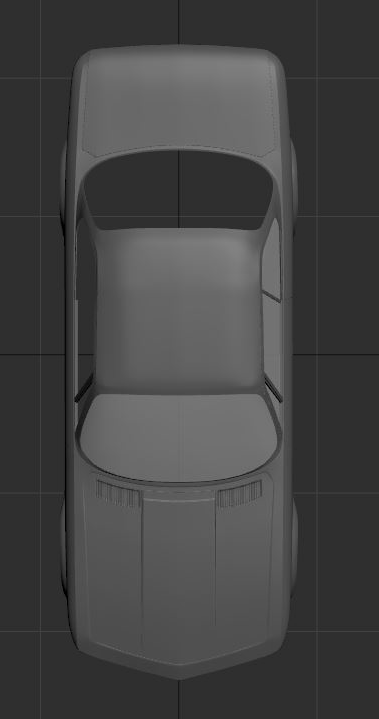

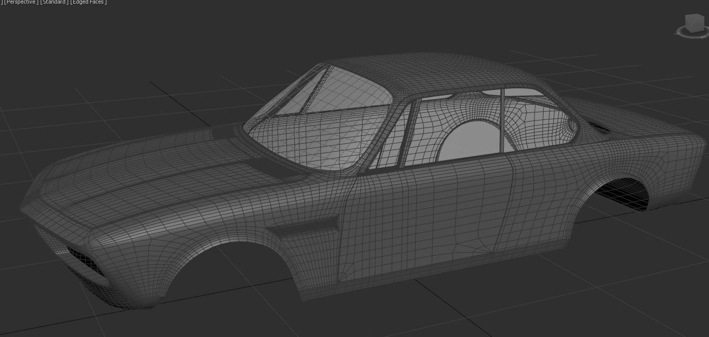

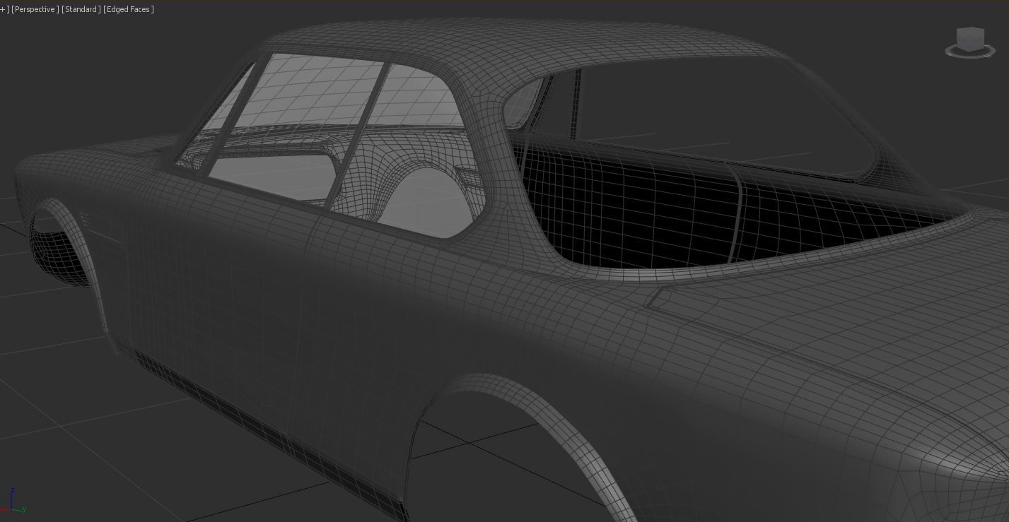

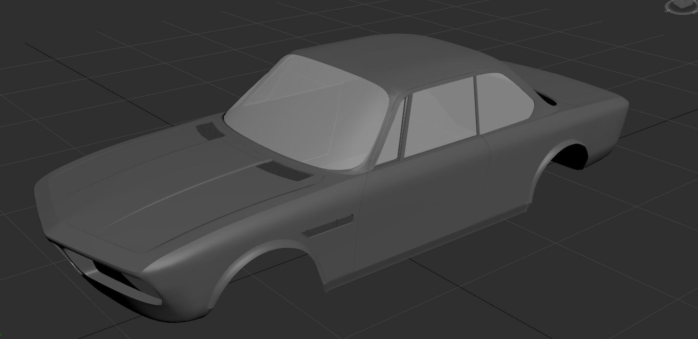

At work, I've been working with a couple of 3rd party vendors for CGI and 3d animation needs like INK and mackevision so I decided to begin a project to basically make a vehicle configurator for the 3.0cs. Starting off with a 3D model and will be going from here. I think material and lighting will be the hardest parts. I'll need to look to you forum members to give feedback since I'm just going off images I find online and a CSL blueprint.
The end product I'm wanting is to have a web experience where users can pick exterior colors, interior colors, wheels, ride height, air dams, etc etc. It will be a long process, the plan is to iteratively work on it and release as I go. Aiming to have the exterior completed maybe by end of next week or so.
Here's some of my initial progress.

As a manager of a large digital design team, I always hesitate to comment on a WIP -- but isn't the character line/crease in the door and front/rear fenders (below the belt line) missing, or is it just not added yet? Easy to miss in pictures without great lighting, but a crucial element if we're planning to use this for subtle color hue changes with accurate directional lighting models.
Cool start - I'm excited to see this come to fruition!

Good point! I forgot about it. Will add :)

Do the front hood and fenders slope down that much? Perhaps an optical illusion with drawings.

I can't tell, but it almost looks like there is a cross-pollination of the front valence chin and a front bumper. The model is following the front bumper lines, but then it is too far back (inset). Here's a not-that-great quick pic of the valence chin with slots.
I think it looks exaggerated when the beltline trim is off.
i'm following this vector drawing and i'm pretty sure it's 1:1 at the moment with this but i can double check. I'm gonna add the belt trim on as well and we can re-evaluate :D
the model is based off of a vector drawing (above) that has the valence chin but not the bumpers.
are you saying the bumper is too close to the body?

I would argue that the blue illustrative diagram is not 100% accurate. And you may want to take a look at the valence trim you'd modeled compared to this blue illustration - there is no drop in the center. Keep up the great work!
I would agree that the illustration isn't the most accurate, but unfortunately it was the best i could find haha. hoping with the help of people like yourself, i'll be able to come up with a better one :D
thanks for the input!
