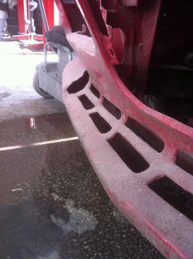

I am restoring a 1972 3.0 csi with chrome bumpers, and when I removed the bumpers I noticed the grill part was bent inwards towards the radiator side. IMG_4864_resize.JPG
This is wrong isn't it?

Back to the CSi , I have fixed the nose piece to some degree. But I have more questions for the experts here.
z
there is a gap between the piece that covers the tops of the headlights in the engine bay and the body itself. I am guessing this piece should not be flat. or is my cars whole front piece bent?
does any one have a close up photo of a decent one?
thanks

Hi!
My recommendation would be to cut out the "grill" part with a saw or grinder in front and drill out the spot welds at the rear, Then "massage" the nose back to its original shape with a piece of shaped wood and a hammer and weld back the "grill" part again after it has been straightened out on a bench.
