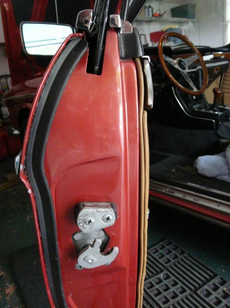

A while back I decided to investigate aftermarket door seals that might be appropriate for our cars. After a good bit of searching, I came across one that 'seemed' to fit the bill. It is made by Steele Rubber Products, and is very similar in profile to the seal that was on my car - EXCEPT that it was made of soft foam rubber instead of a rather rigid rubber (maybe mine was just old, probably installed in 1987). Their part number for it is: 70-1111-73 and it is priced at $4.50 per foot plus shipping from North Carolina ($5-10). They also exhibit at various east coast car and hot rod shows (e.g. Carlisle, Good Guys, etc.
So - instead of buying the W & N product, I decided to risk about $30 and see what this product was like (4.5 to 5 feet is more than enough for both doors).
I installed it yesterday, and am very happy with it's fit and appearance. The doors now close (firm push/pull required) with that 'vault like
whuump' sound, and when the radio is on and both doors closed with all windows up, I can hardly hear the radio, so I think the exterior road sounds will be significantly reduced.
Here is a link to the specific product on their site, in case you are interested:
http://www.steelerubber.com/door-weatherstrip-70-1111-73
And, here are pictures of the profile, the profile measurement, and the installation on my door. Hope this might be helpful, as it will lower the cost for door seals by about $125 vs W&N. BUT - BEWARE, it may cost you points on your next Concours de Elegance contest!
PS: I need to clean up a little excess Wurth Rubber Glue on the sides of the seal, as can be seen in the 4th pix.

272
0
Central California
Your door latch...
Could not help but notice that your door latch ( the 'elbow', movable part on your door) is missing the plastic 'cap'. This is essential for proper door closure. Sorry if I have overstepped here. But if you did not know this was missing that part will really ease your door closure. DCG

dascoupeguy,
THANK YOU for noticing that and pointing it out. Maybe I need a picture of a door with the correct plastic cap, so I can go hunting for one.
I'll appreciate any help here.

Update on my seals, which have now been installed for a little over a week. I only closed the doors to the first 'catch' for the first 2 days, in order to allow the Wurth Rubber Glue to fully bond. Then, I closed the doors snugly (as noted, took a fairly firm 'push' to get them to close). Today, after having them fully closed for about 5-6 days, I opened the doors, kept them open for about 30 seconds, then closed them. They closed completely with a gentle push - meaning to me that the seals have now taken a modest 'set' to the door frame, so the sealing is good, and the closure is easy.
I am SOLD on this replacement for the BMW seal!! (can you tell!!! - ha).
