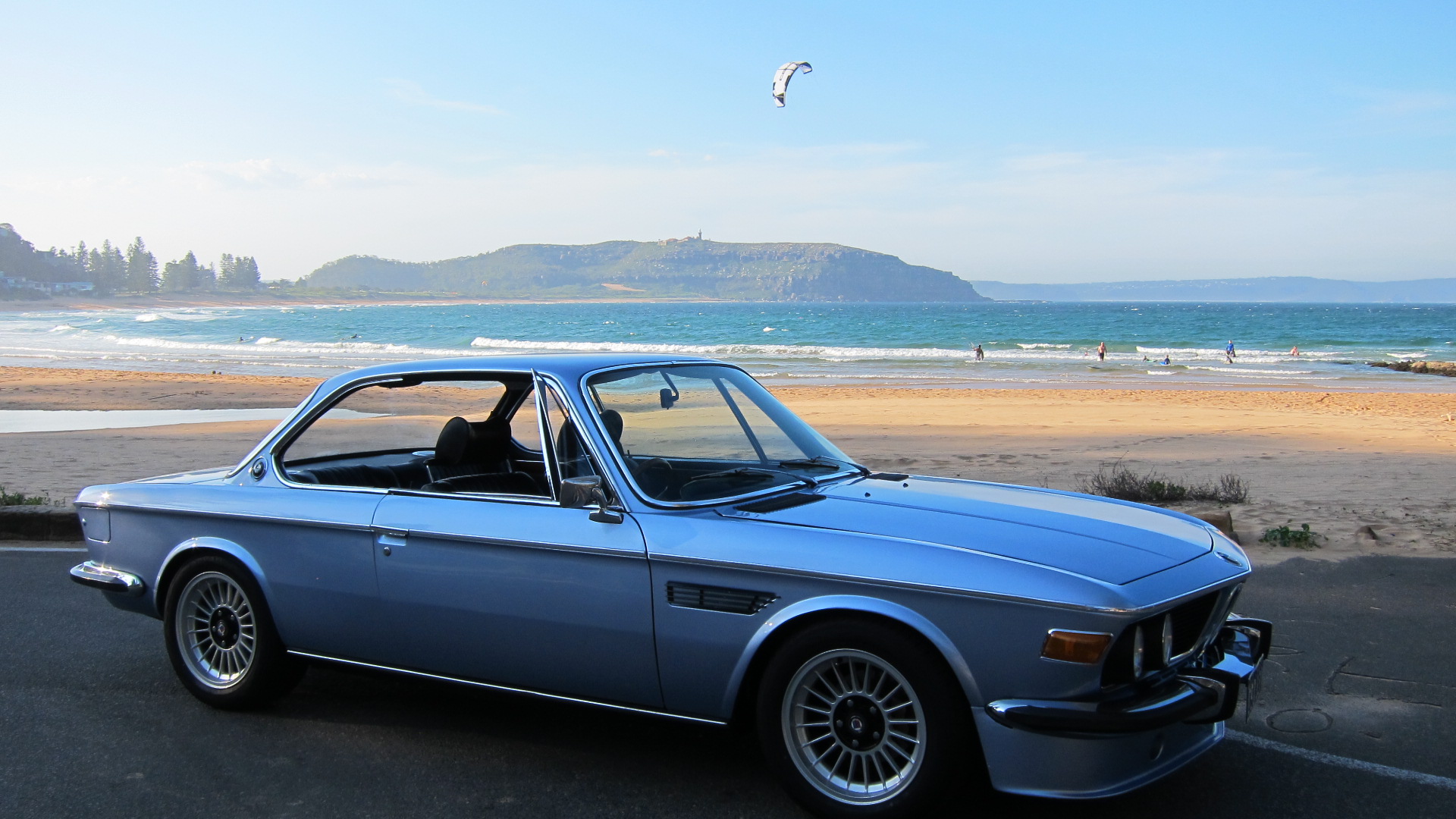

I was wondering the same thing - talking about this photo by member inovermyhead. Windows would hit the wheel well top if they're down that far on my car.

BMW spec, as I recall, is 6cm of window showing at the rear, can adjust the rears to disappear by adjusting the down stop. With the front, the rear edge of the window top trim should stop at the door trim and not disappear.

I always assumed that the windows were supposed to go right down, during the strip out I took all four units apart after marking everything, after cleaning and re greasing following DQ thread put them all back together this is what they do.
All snug at the top and fully recessed at the bottom. I also gave the motors themselves a bit more juice by splicing in to the windows wiring loom a gadget that allows a voltage increase so now the motors run at 19volts. They now drop and lift in about 5 secs instead of the previous glacial movement. See my thread on faster windows for more details.
Cheers. John

Mine is a 71 build for what it's worth, but I seem to remember that pre Resto the windows still went all the way down and after pulling them out all I had to do was a good clean and re lube. I was more concerned on getting the rears back in the same spot in the body. The fronts don't completely disappear into the door 2-3 mm stick up above the chrome door trims and I tried to dial that out unsuccessfully, I then lost it at the top. The tops and the way it fits is adjustable when the doors are re hung. The rear window is completely within the cavity, the highest bit of the glass is again approximately 2/3mm lower that the trim. Happy to post some photos if it will help.
