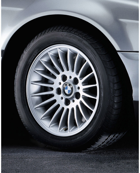

Has anyone put these OEM style 61 wheels on a CS and how do they look?
http://www.bmwtips.com/tipsntricks/wheels/bmw_wheel_061.jpg
they were available on 2000-2001 7 series. Saw a set of them on a 740i and they look like nice wheels and very similar to the classic Alpinas. 16" x 7.5" with a 20mm offset. I found a used set with tires for a very resonable price and might have to try them.

I like them.
I can stand modern wheels on a coupe. I almost got a set of Style 33 for mine at a bargain price. I only don't like the 5-spoke varieties.
I don't know what tire size is mounted on the set you're thinking about, but the correct overall diameter is 24.9" I believe. TireRack.com thinks that a 225-50-16 would fit on that 7.5" rim. If you have to replace the tires, I don't know if it would be such a bargain. Any luck?
I too do not like the look of the more modern wheel design on a CS. 5 spoke wheels look terrible, even 15 spoke and 30 spoke just look off. I am also not a big fan of BBS wheels on a CS. I saw a set of these on a 2000 750iL and had to take a closer look.

Check the offset. Wheels that fit the E9 usually run ET10-ET20. I believe all more modern BMW wheels are more around ET30-ET40
so they simply might not fit and catch on springs, brakes, suspension etc.
So I am just starting my project and picked these wheels up as I mentioned above.
Here is a picture with the style 61s. Wheels are 7.5j x 16 H20 = 20 mm offset
The please note that the car is rough, rustly, stock 73 bumpers and suspension, but I want to share as I think the wheels turned out nice.
Standard 16" tires for a CS, 205/55 r16 front and 225/50 r16 rear. I had to add 7mm spacers in the front to give the rubber some room to flex and not rub on the strut tower. With out spacers they just barely cleared.

That hardly looks like a "rough and rusty" car. Comment, ever the picky one are I: the wheels and tires look in some way too large for the body. Maybe it's just clearance between the top of the tire and the fender lip, which is of course adjustable if you remove the spacers, or with another spring/shocks combo. But then it might rub. My 2 cents, YMMV.
I just took the front spacers off the top of the front shock towers. Lowers it a bit. Lots of things to do to get it to look just right. Are there blocks on the back too on the '73?
The fronts might rub when I get lowering springs, but have not got them yet. I need to get on the back order list for some Carl Nelson springs, unless some pop up here first.... not likely.
