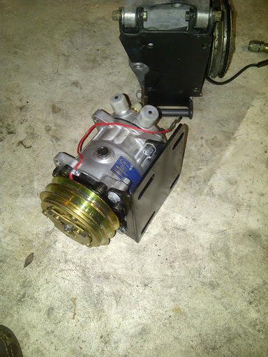

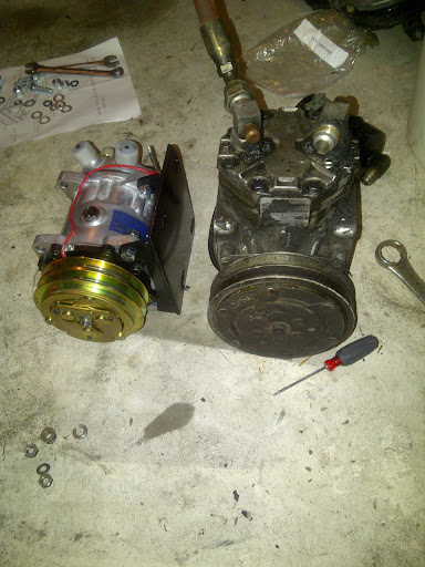

-switch from old York boat anchor to "Sanden style" 709 compressor and York mounting bracket from Johnjoysyl eBay seller ($190 for both and must be at least a 15lb weight savings):

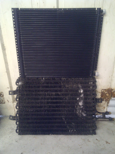

-replace old crusty condenser with modern 16x18" parallel flow version from nostalgicairparts.com ($90):

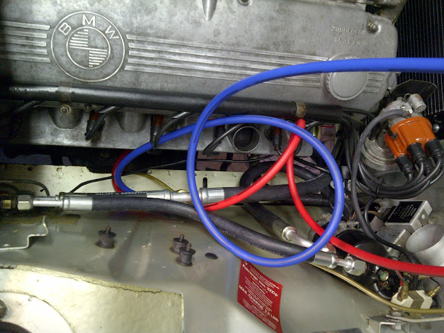

-new a/c hoses from local hydraulic hose shop ($75) - wish they were like the cool oem red ones but such is life (the red and blue shown here are the gauge hoses):

Fabrication included making some bracket extensions for the condenser to fit the existing one seen in this pic:
and having a machine shop extend the compressor mounting bracket bolt slots so the pulley would line up correctly:
The evaporator and dryer have flare fittings, the new compressor and condenser have o-ring fittings so you have to get some hoses made that mix/match the fittings. So for my setup they were:
[FONT=Calibri, Verdana, Helvetica, Arial]1. Compressor to condenser: 40” total length, 45 deg #8-8T O-ring compressor out to 90 deg #8-8T O-ring condenser in. #8 hose.
2. Condenser to dryer: 39” total length, 90 deg #6-8T O-ring condenser out to 90 deg #8-8T flare dryer in. #8 hose.
3. Dryer to evaporator: 19.5” total length, straight #8-8T flare dryer out to straight #6-8T flare evaporator in. #8 hose.
4. Evaporator to compressor: 33” total length, straight #10-10T flare (with separate #10 R-12 port spliced in) to 90 deg #10-10T O-ring. #10 hose.
Total length = hose plus fittings. I installed an R-12 port into the low side evap-to-compressor line for convenience and 3rd degree burn elimination. I thought my dryer came with a high side port but it didn't so at some point I will replace with one that does.

-install condenser after making some bracket extensions from metal strip from Lowes
-lengthen slots on compressor bracket as much as possible (machine shop) and install compressor to stock York bracket on block.

-source fittings and bring to hose shop and have them make up the hoses (they can probably order the fittings you need if NAPA doesn't have them)
-install hoses and tighten carefully

[/FONT]The 508 and 709 is the designation of pistons and displacement, the 508 has 5 pistons and 8 cc or something, the 709 has 7 pistons and 9 cc. Both have the same body size and would fit. The other designations pertain to the type of clutch and fittings and where they are located on the compressor, some come straight out the back, others go up, I chose the latter for clearance reasons. Depending on which refrigerant you are going to use, you'll want it to come with the right oil in it, fittings that come up not staight back, and the correct service ports for your refrigerant (they are different for r12 vs r134), and a double pulley clutch not serpentine belt. The 508 probably takes less hp to run than the 709 but that's just a guess.
The upgrade is like night and day - the compressor is smooth, no vibrations, and silent, only reduces the idle rpm slightly when on, and the new system cranks out frigid air into the cabin - I can drive in 95 degree heat/humidity and be fine inside the cabin, and the system will actually cycle because it gets plenty cold. With the more efficient radiator, there's no going past halfway on the gauge with the a/c on in the broiling heat here.

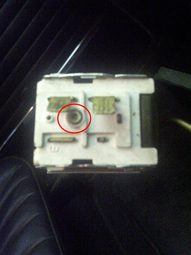

Update - temperature thermostat adjustment
If you need to adjust the temperature at which the compressor cycles on and off, it can be done by accessing the back of the a/c thermostat temp switch (careful with the capillary tube) and using a small hex key to turn the screw. Clockwise will allow the compressor to stay on longer before cycling off, this will allow cold air to come through longer, however allowing too much will freeze up the evaporator. I found that a quarter to half turn allowed me to have the temp switch at half way in hot weather. If I need cold air longer I have more clockwise headroom to play with before the switch maxing out. Experiment with it and you will be able to dial yours in to your climate and delay the compressor cutting off.

A note on hoses and fittings - when you have the shop put the fittings on, try to mimic the way the hose bends and twists through the bodywork - some fittings will be point 90 degrees or so from one another - this will minimize torquing/twisting of the hoses when installing - they are stiff and not very flexible.
