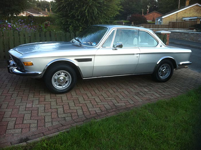

The gap between the top of the wheels and the wheelarch are noticeably more so in the front than in the rear.
I first thought that maybe something in the rear had sunk but it looks more as though the large gap in the front is clearly incorrect (in comparing the gap to the gaps in period photographs).
Any idea what might be going on?
Mighten the only way to correct it would be to buy shorter front springs? (or cut the current ones).
Any help very much appreciated.

Shorter springs are one way to go, but first, did this just happen (something changed) or did you only now notice it?
Sometimes new shock absorbers take a while to "bed in" during which time the ride height may change.
Worst case, the rear is settling from shock tower failure. A careful inspection (perhaps removing the "elephant skin" liner may be appropriate. Tower failure may be aggravated by stiff shocks.
The front of many, if not most, USA coupes was higher by design due to front bumper height regulations. This was accomplished by putting a circular aluminium spacer between the top of the front shock bearing and the body. Most of us have taken the spacer out by now. Spacer height varied but about 1/2 inch.
Another reason for the lower rear might be Jimmy Hoffa in the trunk. Or you're still using leaded fuel, which of course is much heavier than the alcohol blend the USA has been inflicted with ;)

Thanks for your reply. I inspected the rear shock towers and they looked as they should (as far as I could tell). I went for a shorter spring kit on the front (bought from Jaymic here in the UK). Seemed like a lot work for the difference of about an inch or so. Perhaps I forgot to do some important part of the procedure. Does look a bit better though
The difference in hight between an old spring and new shorter one looked incredible (see pic). What gives? Do springs get longer with age?
I'd say springs get softer with age, which means they are shorter when the wheel is compressed by a bump on the road and longer when hitting a hole. Measuring their lengths outside is not a good indication, the short one has to be naturally harder so when installed it would compress less.

well anyway the standard position of thw car is like you mentioned, always a bit more gap in the front wheels than in the rear wheels,
the correct way to check it is if you park your car in an horizontal road, you will see that the waist line of the caris also horizontal, lets say parallel to the road
in that condition you will see that the gap is bigger in the front wheels than in the rear wheels , but that way your car was designed
i will only be worried if the car is not parallel and more, the gap is bigger also,
not knowing how it looked like before the spring change, i would say that you are now in the correct settings, that probably meant that your springs were ...?????
how does it behave and handle ?, as mr.arde says probably your new springs are harder than the old ones

Thanks for the tip, the waistline is exactly parallel to the road. So I'm happy with that.
The photograph in the first post is a 'before' pic (with a different set of rims), but here's a side-by-side comparison (though it would appear I'm incapable of taking a photograph from the same angle twice).
Though I was at first mildly unimpressed with the difference, considering the difference in height of the old springs with the new when comparing them on the bench, it's clearly 'more' correct now and it handles noticeably better. I'm over the moon.
My bet is that someone replaced the original front shocks with good gas ones and pumped the car up an inch which is why it looked like a speedboat. The car looks right to me as it sits and will drop a little as the new springs soften up. What you have for new springs are stiffer than the old ones, so they don't need to be compressed so much to hold the car up. Feels better, hunh?
That's interesting. I didn't consider that. Car does feel better now and it sits just right in my view.

Tires are 205/70/14. I measured the distance between the top of the tire and the bottom of the wheelarch, Now that the springs have 'settled' the difference is almost 2 inches.
I didn't remove or replace the shocks. I assumed that they'd be original but as a sealing washer was missing, someone's definitely been in there before though there's nothing in the history to confirm that.
