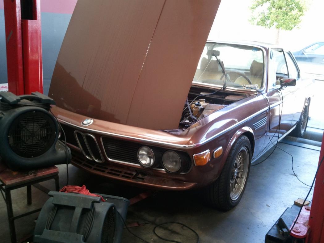

Hoping to tap into your collective knowledge to troubleshoot a problem my modified engine swap is running into. My mechanic, currently in the midst of tracking the problem down, has had the car on the Dyno a few times as he is tuning it and he tells me that it is "running out of power" above 3500 RPM almost like there is a rev limiter. The details of the motor are that it is an M30B35 from an 1989 735i; it has a custom ground cam, Megasquirt, 1.3 motronic, and ITBs and intake plenum from an s38 M5. Initially he thought it might be a restrictive exhaust, so we went with IE headers and custom, freer flowing exhaust, but this hasn't made a difference. He says he has it dialed in; it's running smoothly, cold start is good, etc.; however, above 3500 its running out of power. Any advice/experience is greatly appreciated.

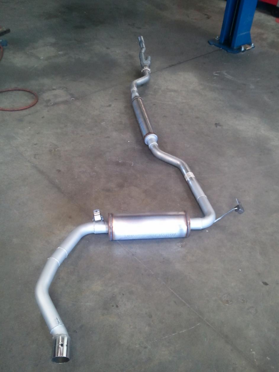

here is a picture of the exhaust that was fabricated. My mechanic states that it is little louder than stock w/o being annoying ; ) Cam is a custom ground from Paul Burke, I forget the specs, but I'll get that info and post.

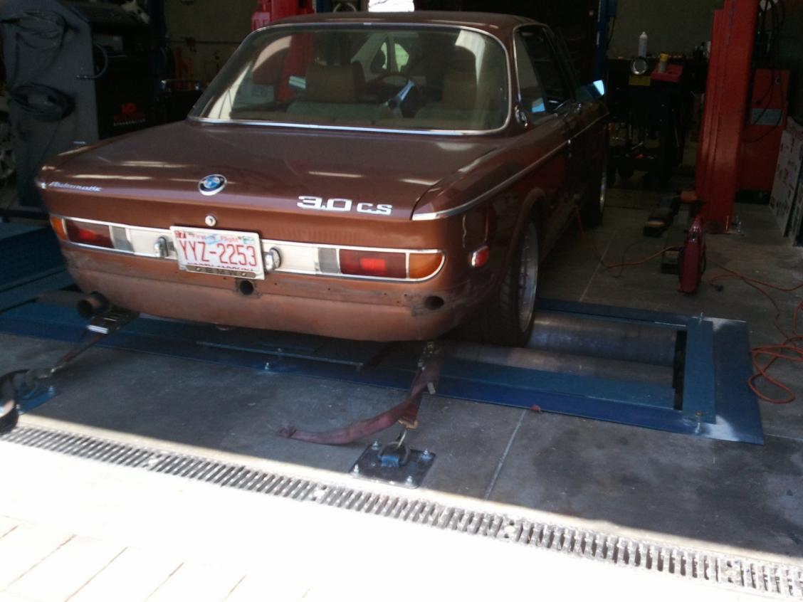

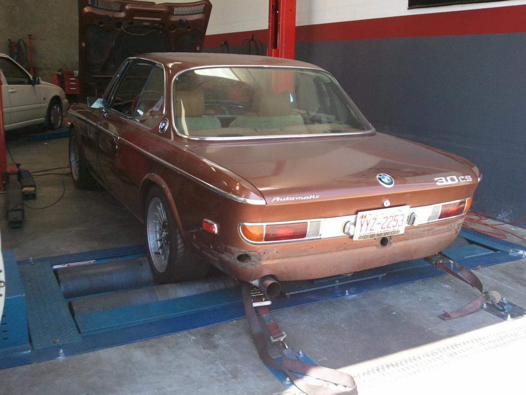

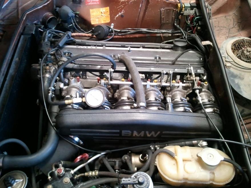

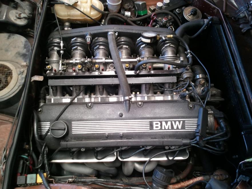

Not much of an update for you. My mechanic is still sorting issues; it runs smooth now but "super underpowered." He's going back under the valve cover to make sure the cam timing is correct, and checking a couple other things.
Attached are a few pics. I've deleted the big bumpers and will have to contend with those huge holes when I get it back.

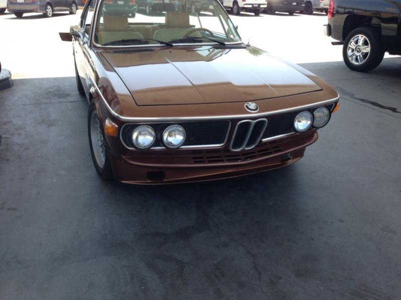

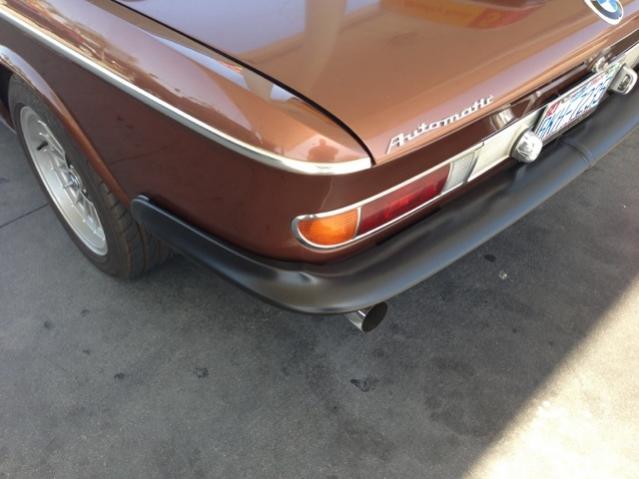

The long journey with my '74 coupe is thankfully coming to an end. Here are a couple of shots of the CSL bumper/Alpina air dam mounted, reflectors deleted, and a shot of the new engine. Left to do are the install of the correct driveshaft and a final tune (gotta get rid of the "automatic" script on the trunk too). Special thanks to Erik Sliskovich aka Coupeking and Don Lawrence (sfdon) for rescuing my project and getting it to this point.
