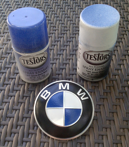

I have read about Testors 1111 Blue as being a match, the local hobby shop also had 1211 which is a spray can version and is more to my liking because I am not very patient or skilled when it comes to this stuff (espescially after the beverages). I used Testors 1245 for the white, and a black satin/semi gloss for the background.

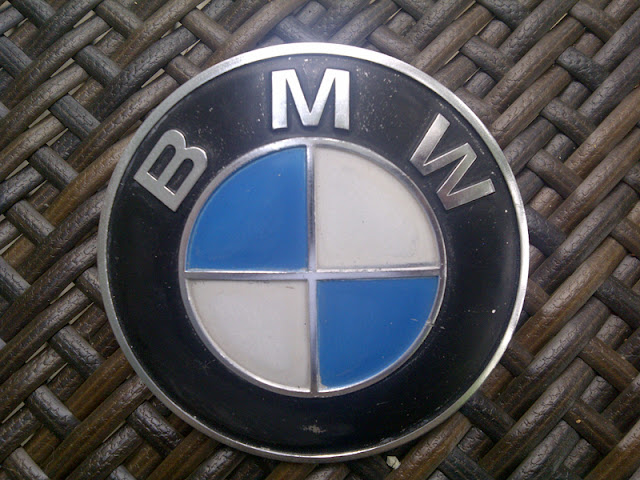

Original faded roundel:

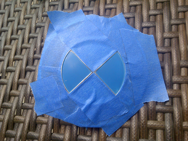

Masked for the blue:

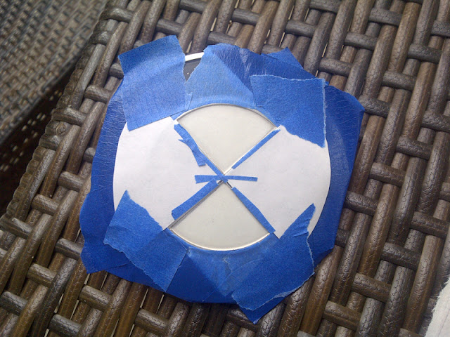

Used wax paper over the dried blue to avoid sticking when masking for the white:

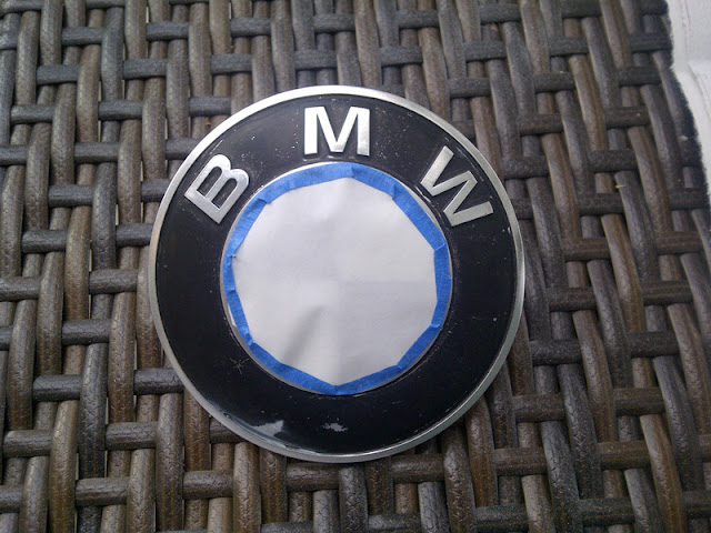

Masked the circle:

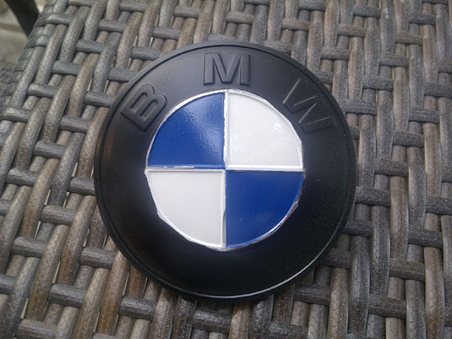

Starting to take shape:
The finished product, scraped and sanded to reveal the metal, a couple coats of clear to protect it from when I open/close the trunk, not perfect but an improvement at under $10:
