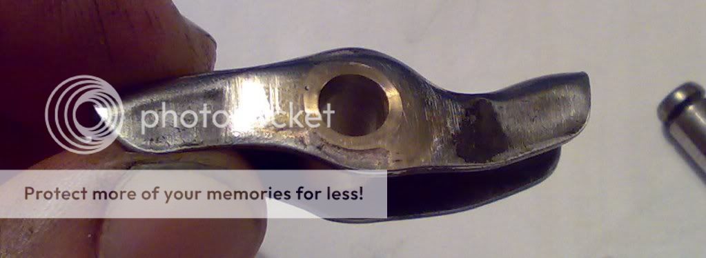

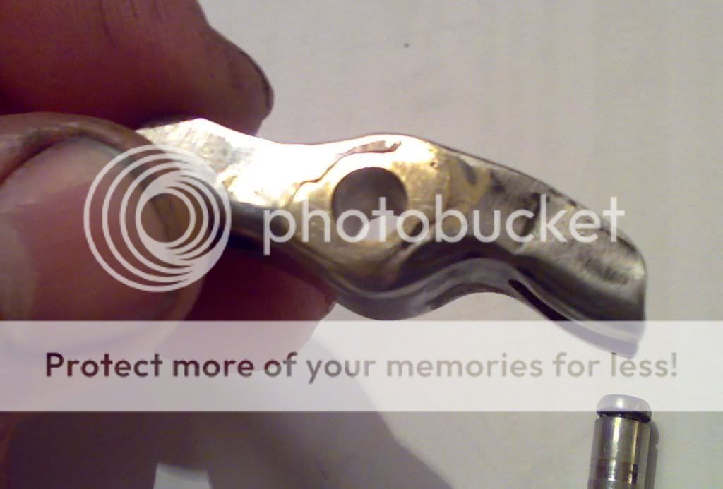

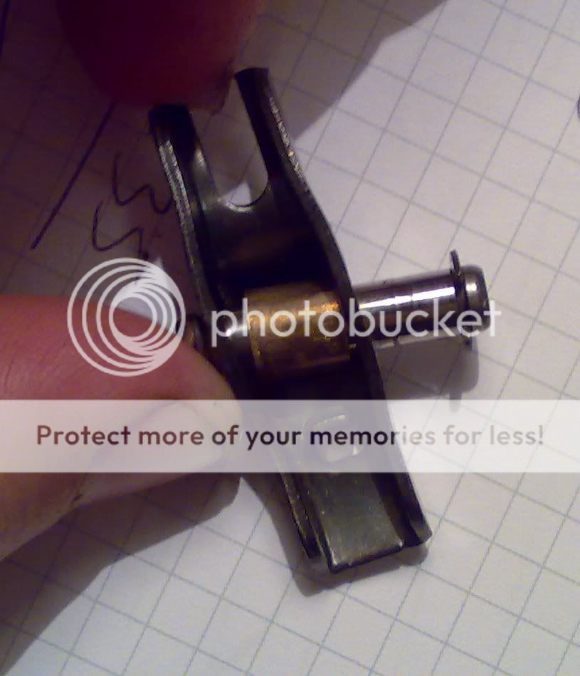

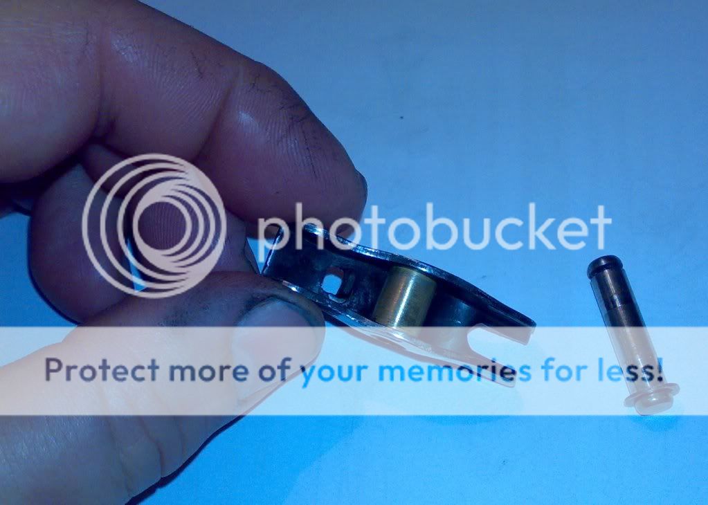

finally after some indagation, i decided to undertake a bit of a mechanical work, so in order to solve the problem of my pump:
i worked this solution: attention: NOT ONLY A NEW BUSHING, BUT THAT NEW PART HAS BEEN WELDED TO THE BLACK ONE TO AVOID THIS PROBLEM DEFINITIVELY
(the welding makes both parts join together and avoid relative movement that makes friction and destroys the weakest part) ok ???
