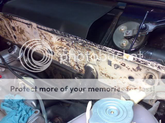

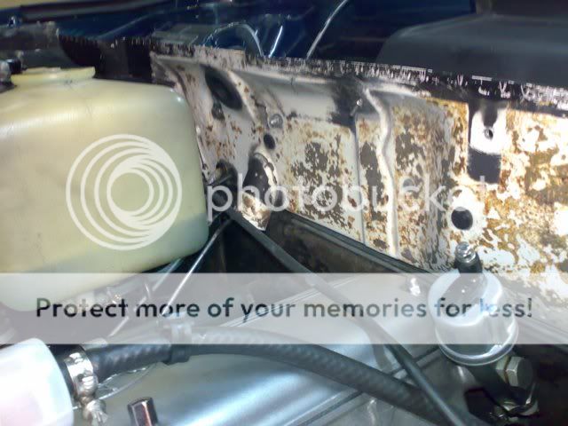

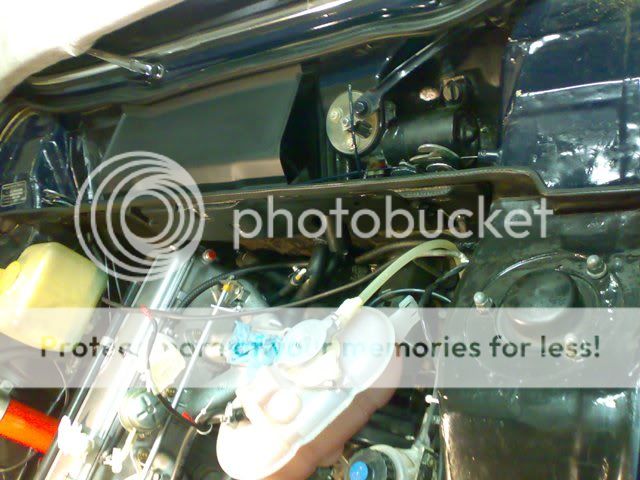

there is an insulating mat on top of the rear side on engine compartment
after 40 years it is almost disintegrated and not only the appearance is bad, but also any work inside the engine, affecting that area will mean a sort of "sand" falling over all your neat jobs
so fed up with this, i decided to stop it installing a new part:

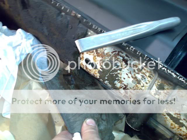

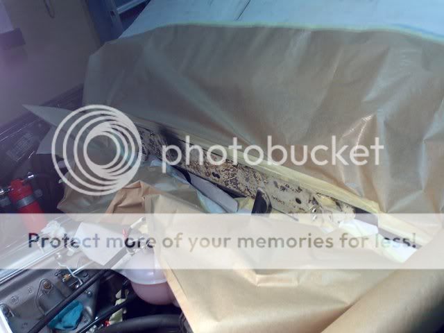

remove, it breaks easily

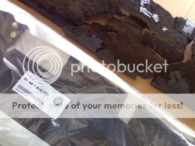

bmw reference
it is an exact part, auto adhesive

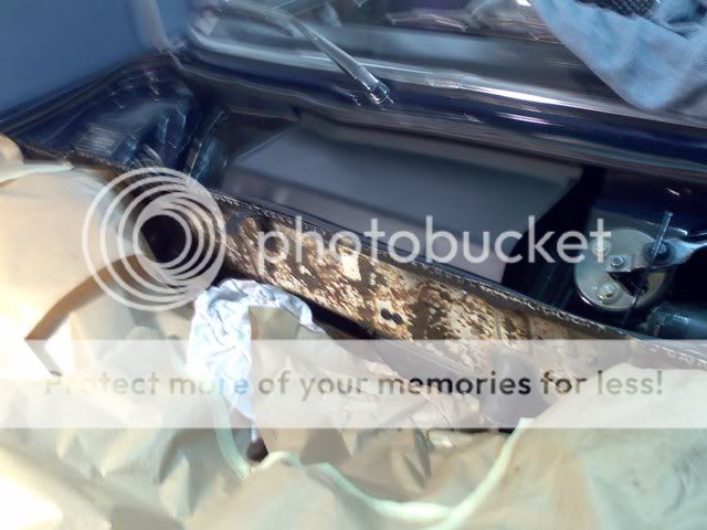

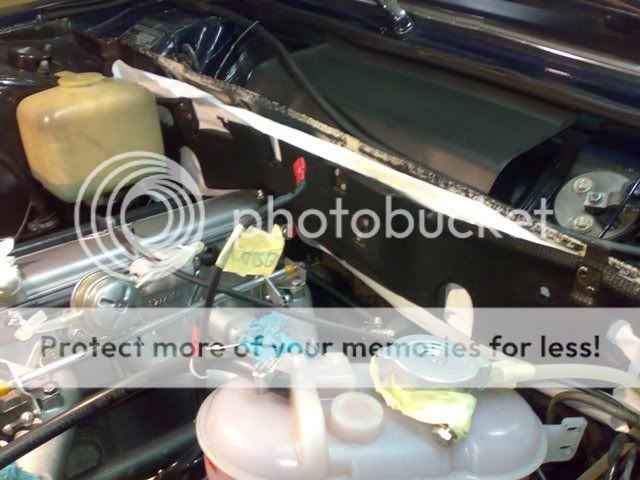

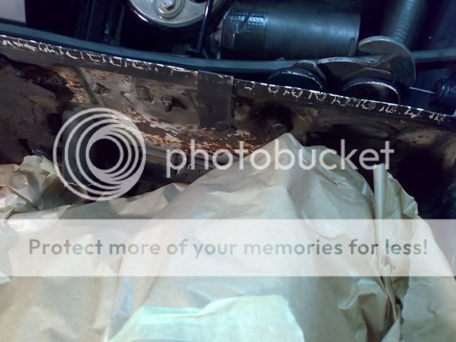

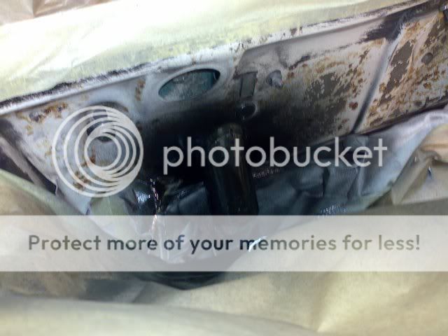

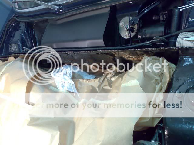

metal brush and steel wool with gasoline to remove fragments, and prepare surface

no idea, to tell the truth i got it from w&n some months ago
How thick is the material for us industrious types who may venture on to replicate the part?
i am afraid to tell that it has variable thickness, from, lets say 2cm to 0,5cm

hi,

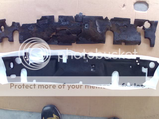

i understand what you say, yeah, that metallic foil (probably aluminium)
what i can tell is that the replacement part is exactly the same in shape and material as the original installed one (you can tell from the photo, also)

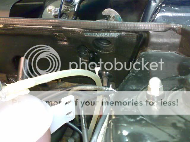

Looks nice - what did you have to remove in order to get access to the back wall for removal/refitting of the piece? And how do you get/keep your engine so clean????
hi steve
this part can be removed without problems with normal access, no access from the rear is needed
the part hangs from the top sheet metal flange in three points, and then is autoadhesive
the process is:
1-remove a little of the paper in the top area
2-hang the part from the three lamps in the top
3-start from right corner removing the paper introducing your hand from below the part
4-continue pulling the paper while pressing the part against the firewall
the real thing is that a good access to work is granted provided you remove several parts/things:
- windshield water reservoir
- rear carburetor (it is not a must, but it helps a lot),
- coolant reservoir
do not forget a good cleaning of the sheet metal in the adherent area

Thanks for the pictures. I installed my new foam piece last week. I found it a bit short in its length and had to stretch it to place the openings in the correct position. It is also not adhering to the firewall (new paint) very well along the bottom and ends (coming loose in places). I think I will try some Wurth contact cement. Did you have any problems with the self adhesive?
deQ
hi sven
the piece is short because in fact there are two pieces in that particular area of the car, the one you have is the top one, but another one comes below it (in my case as no access is granted to the lower area, the only choice has been the top part)
the self adhesive is not excellent, so an additional impact glue or similar should be used if it is the case
