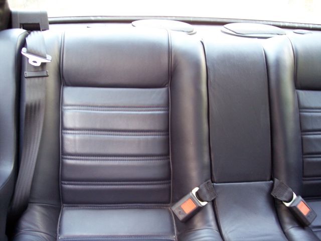

My shoulder belts are the stock ones that fold and tuck into the shelves by the headliner where it looks like they have been since dealer delivery. My rear seat lap belts retract. At some point I would like to do an front seat belt improvement like yours.

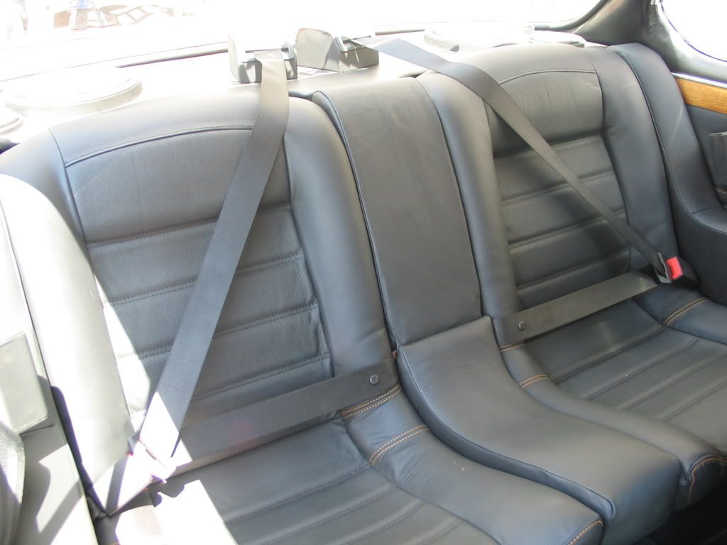

We are working on this right now. When I redid my headliner, I put a more modern attach bolt on the roof above the door, and with some work it should be possible to use the metal slider attach rod (on the floor behind the seats) from an E30 to produce a somewhat more modern setup. The downside is that this requires some modification to the interior, so if you are going for a completely stock look or otherwise do not want to cut your carpet it won't work.
Huh. I guess my car was refitted back in Germany. Ever since I got it, the seat belts for the front were retractable and the tensioner/ratchet was located under the rear seat, passing through the rear side panel arm rest. The springs have aged poorly so it doesn't like to retract much anymore, but the belts are there. Seems to be an old Autoflug set, based on the clips. The rear seats just have non-retracting lap belts that look like they came form an early-90s GM car. (has a sunburst pattern on the unclip button, I always saw it on Buicks and Oldsmobiles)
These seatbelts are from BMW E39, i installed them in my coupe, with 2 leathered hoods i´ve done by myself........
Maybe a possibility for you?
A german colleague (Gerhard, the admin of the german E9-forum) did this installation:
I can ask him if he has a source...........

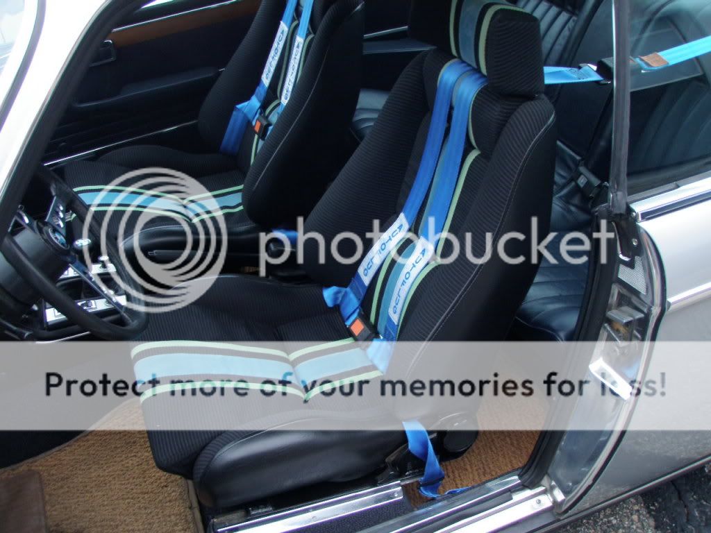

Here is my solution the posed question:
A few years ago I saw a photo (Iida CSL?) with a similar Autoflug harness - retractors mounted on the rear package tray, etc. So, when I came across these on the Pelican forum for way less than repros (that didn't even include retractors), I sent an email as fast as I could type.
Also, you can see the Scheels are now properly mounted thanks to Mario at VSR who welded up some adaptors between the original rails and the seat.
