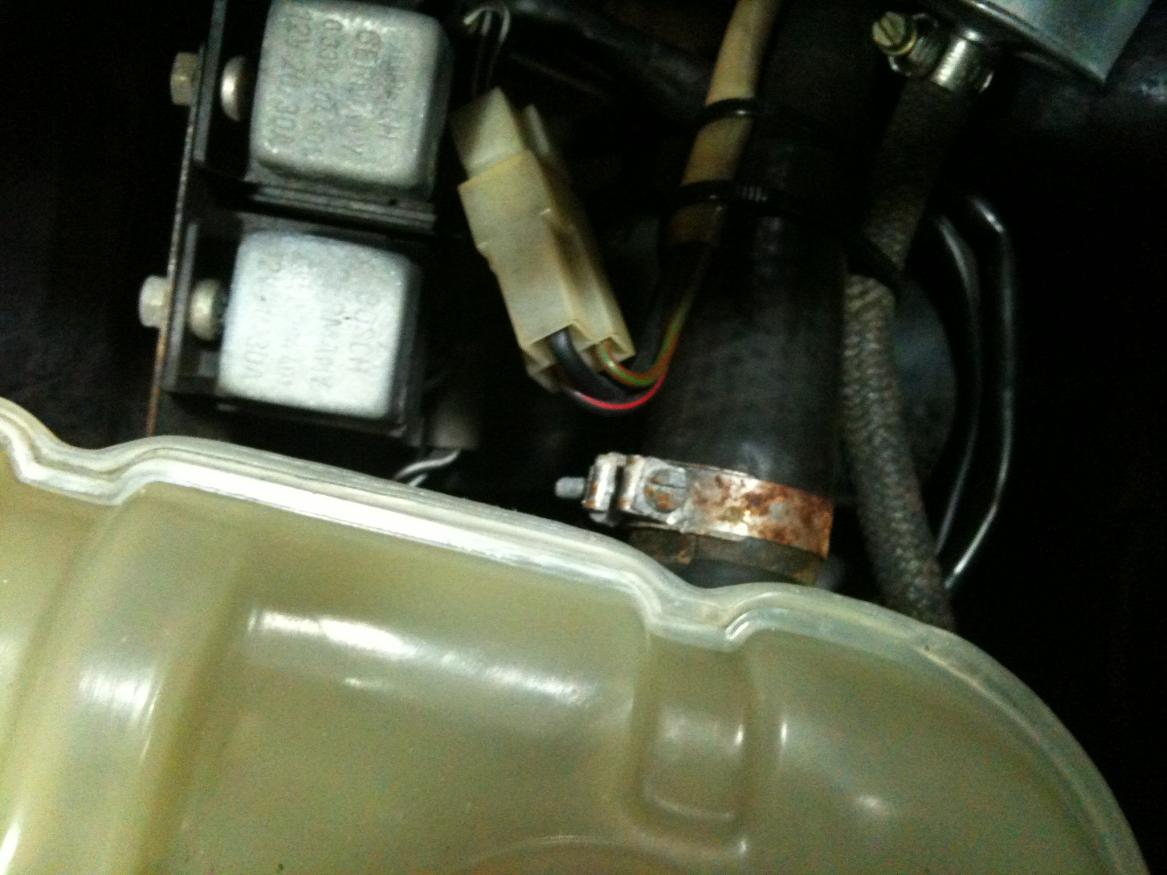

Can someone please identify the relays in this photo?

Len, My `73 has a single relay there and it is for the idle shut off valves and chokes.
Edit: just checked the blue book diagram for `73 and on models, it shows item 117 as a single choke relay. I have not seen two in that location but that doesn't mean it's wrong, just don't know what the second one is for unless it is one for each carb.

Thanks, Chris. Do you know what the large aluminum rectangle w/ the rounded corners is for?

I don't see it in your photo but that is what my relay looks like, sort of a miniature regulator. I think automatics had another relay on the booster support for the starter cut-off if in gear.

Sorry, here's the photo. The large rectangular component + 3 relays are near the battery. The two relays in the previous image are near the engine-side of the coolant reservoir.
