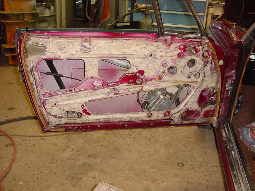

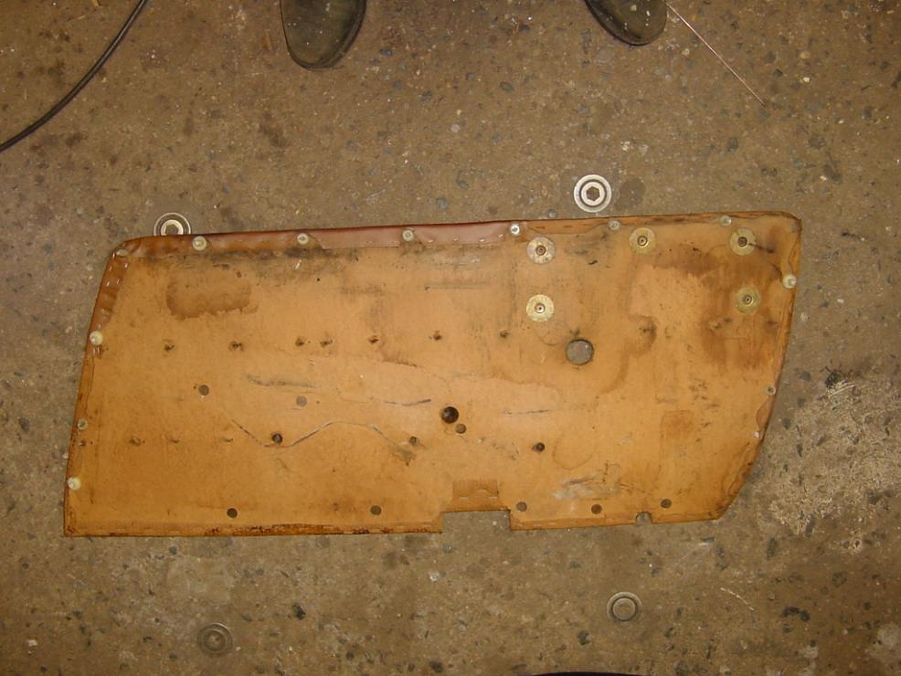

I took off my driver’s side door panel and some mutt left off the plastic vapor barrier :( so the door panel has some water damage.

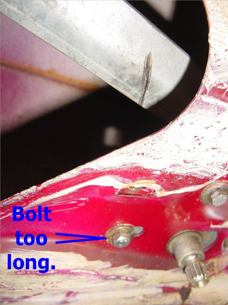

Another or maybe the same mutt fastened the inside door lock opening handle with a too long bolt that’s cutting into the window’s actuation lever :(.
However all of that was quickly forgotten when I surveyed the inside of the door and found it to be rust free :-D:-D:-D !
The door has a peculiar twang or spring sound when you close it (doesn’t sound very German at all :oops:). I’m thinking it’s from bad bushings on the lock actuation rod but I’m not sure :confused::confused: and would appreciate any suggestions. Thank you for your help ~ John Buchtenkirch

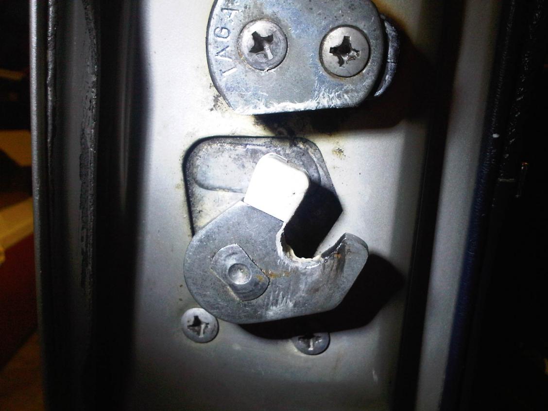

Do you have the plastic door bump caps on the door catch? They are important for that "thunk" sound. Pic attached.

Thanks Steve, I’m missing them on both the L.& R. sides so I wouldn’t have even know without you guys expertise --- thanks so much. I think I’m going to have a hell of a parts list in a few weeks. Having said that I doubt that’s my problem, the passenger door doesn’t have that definite twang the drivers door has. There’s definitely something that vibrates for a second or two after you close the driver’s door :confused:. Probably the door lock linkage rod. ~ John Buchtenkirch
