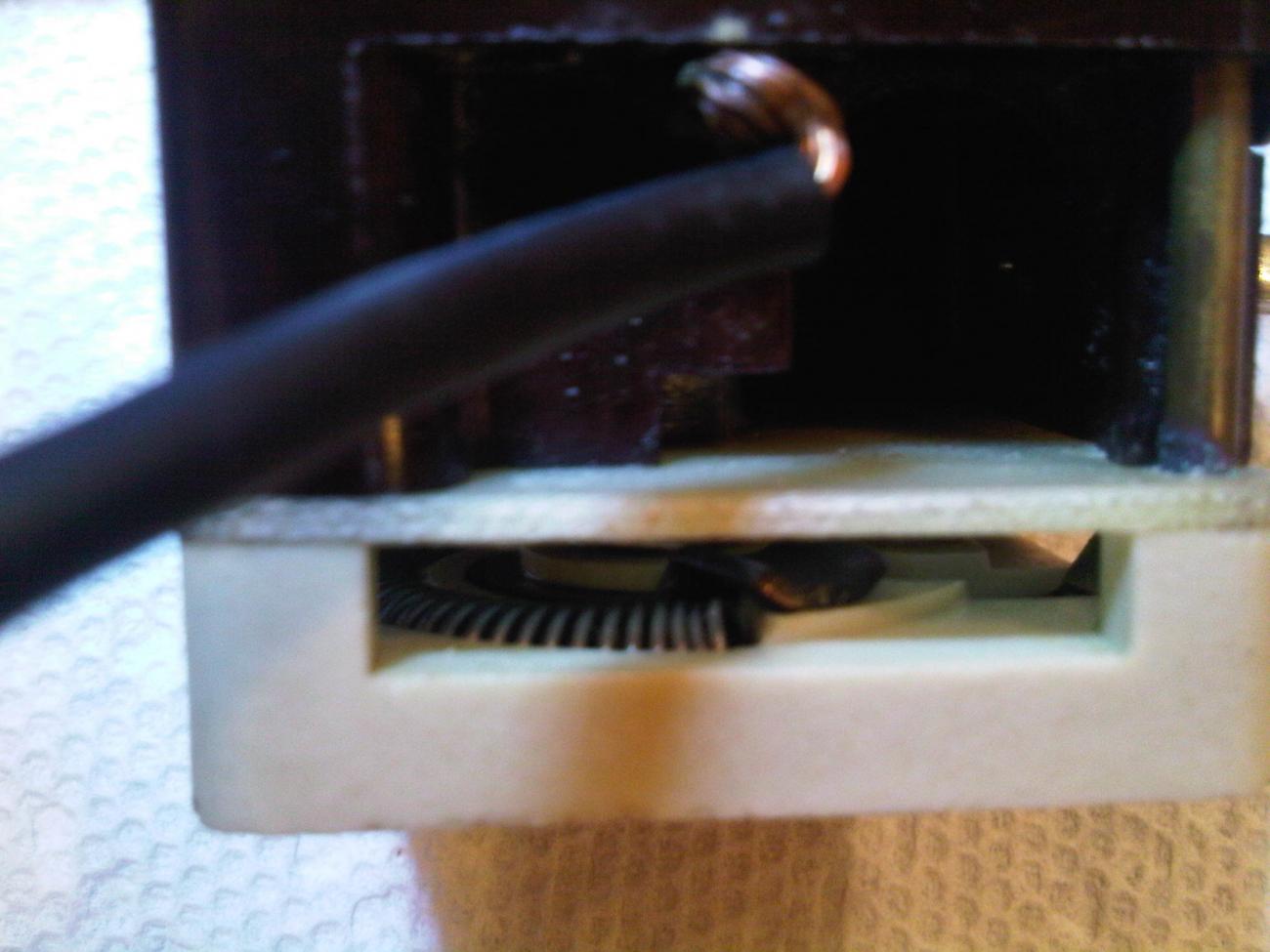

Update: Fixed by cleaning!!
My fan switch would turn on the compressor but not the fan - until it got all the way clockwise, a symptom I have seen a few times with others on this board. It has been suggested that the resistor can be replaced, after I pulled it I saw on mine this is not so, it is a large ceramic coil riveted onto the bottom of the switch. Before giving up I looked at the coil and saw it was filled with crud and the metal contacts were corroded and rusty. I sprayed lots of electronic cleaner into the coil and onto the metal parts then turned the switch back and forth several times. Crud gone and now nothing in between each coil winding. Then I put some sandpaper inbetween the coil and the contact and turned the switch again to clean the metal contact piece that glides on the coil. I also sanded the other metal contact at the end of the coil which is stationary. I then put a few drops of fine oil on the shaft and other moving parts, it now operated smoothly with no friction noise. I hooked up the ohm meter and saw that I was getting variable resistance readings so back it went into the dash and it works perfectly. I believe the crud was negating the effect of the coil. Now my fan kicks on low and increases in speed as the knob is rotated until the last click where it goes to full blast. Attached are pics of what the resistor looks like after cleaning. The switch does get very warm when in use so it's not surprising that it fouls up. So before you replace your switch give this cleaning a try, mine's good as new.
