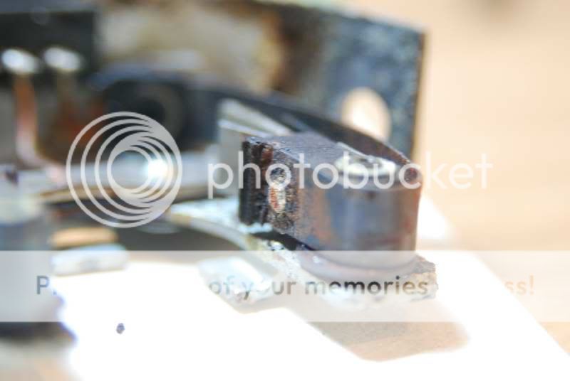

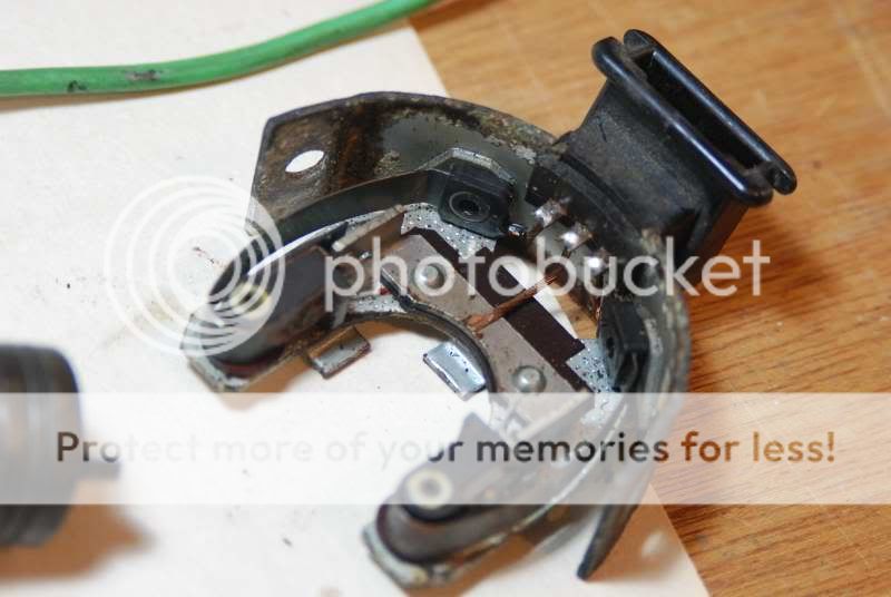

Most of the replacement fuel injection trigger points seem to be equipped with with a grease-impregnated felt wick that presumably lasts the life of the points. (not in picture below) I don't think the manufacturers ever considered exactly how long some of those points have been around. I would not trust the wicks, if you have them and might consider amending the grease as you might with traditional ignition points (on the rubbing block and lightly over the entire cam) - but away from the contacts.
