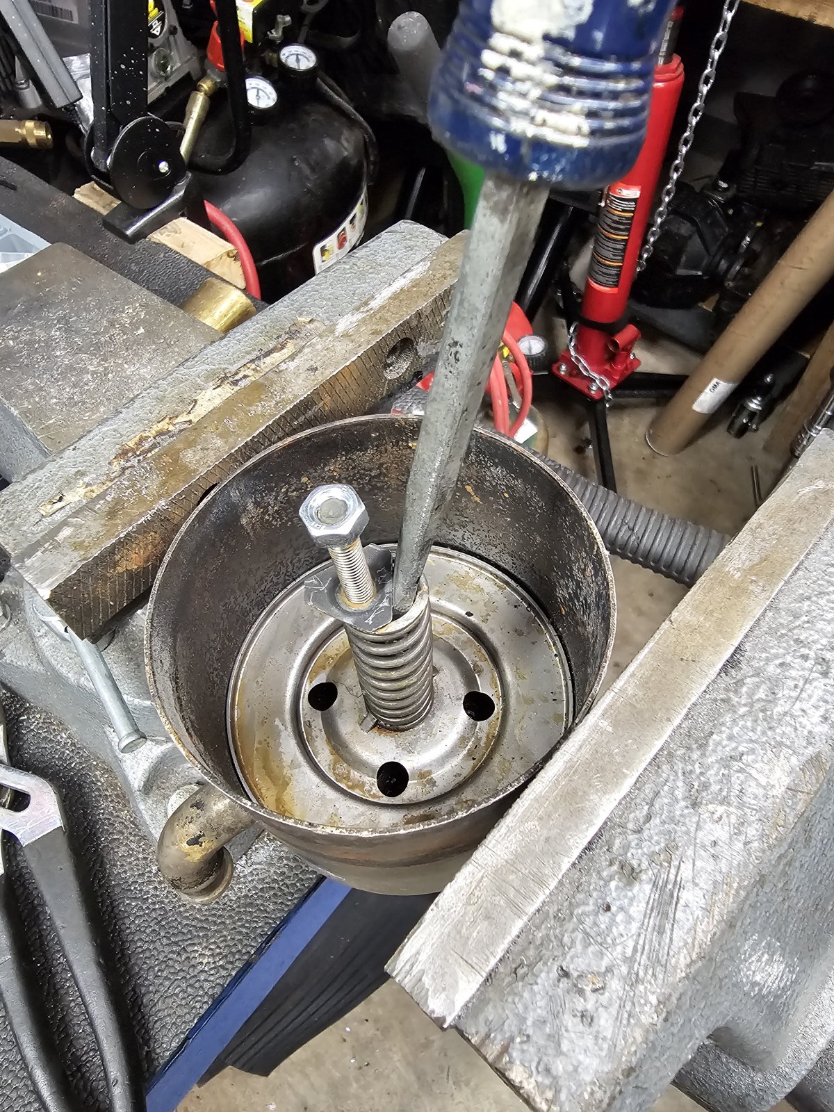

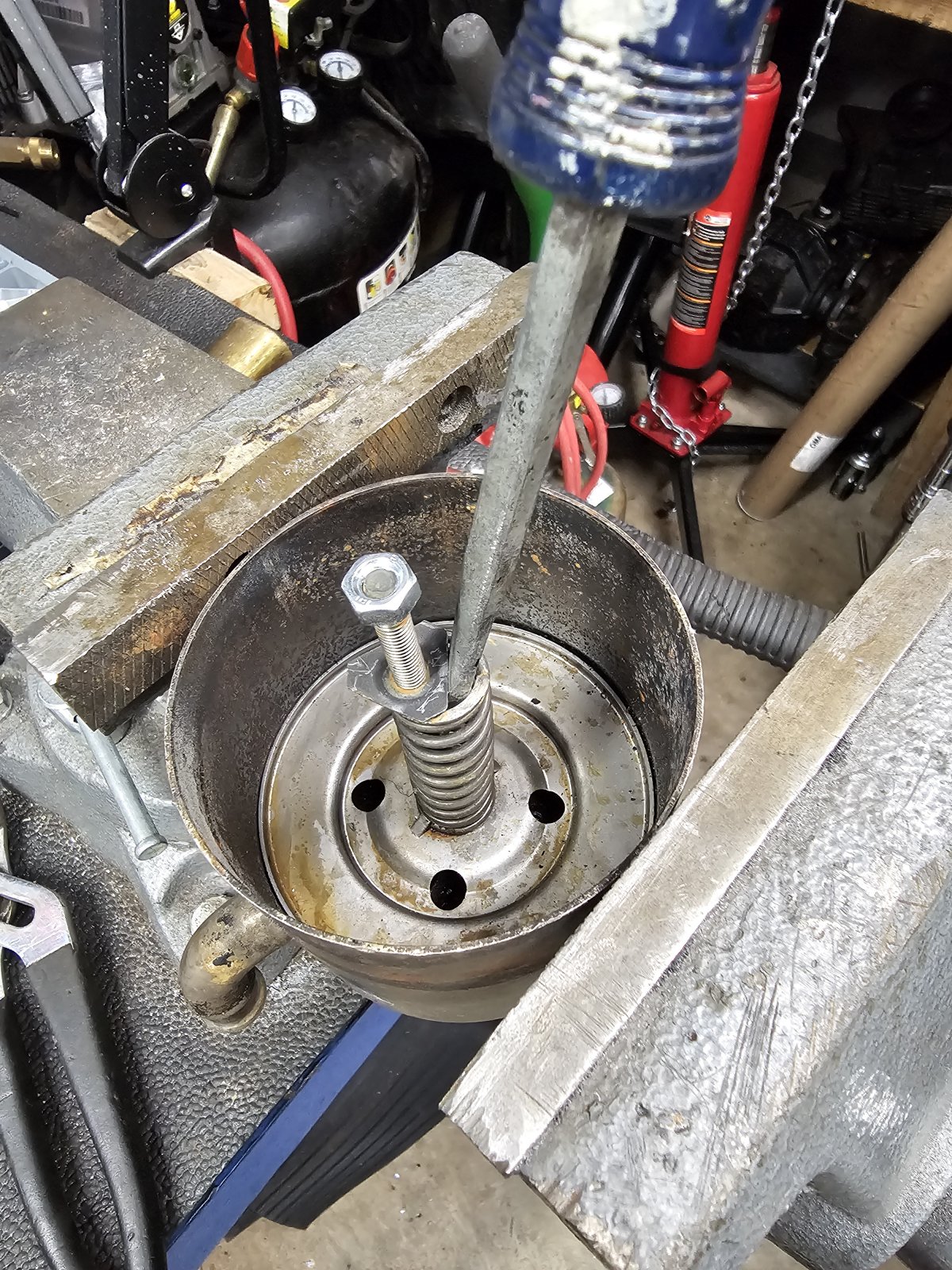

I couldn't find another writeup on this so I am updating this thread. The triangular locking washer can be safely threaded off of the center rod using a flat-blade screwdriver. You just insert the flat blade screwdriver on one of the flat sides of the washer and rotate the washer/screwdriver around the stud until it unthreads. This ensures that the washer isn't damaged by trying to pry it off. I put a nut on the rod just in case the spring popped loose.
