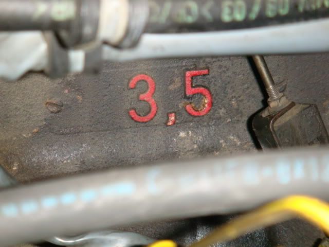

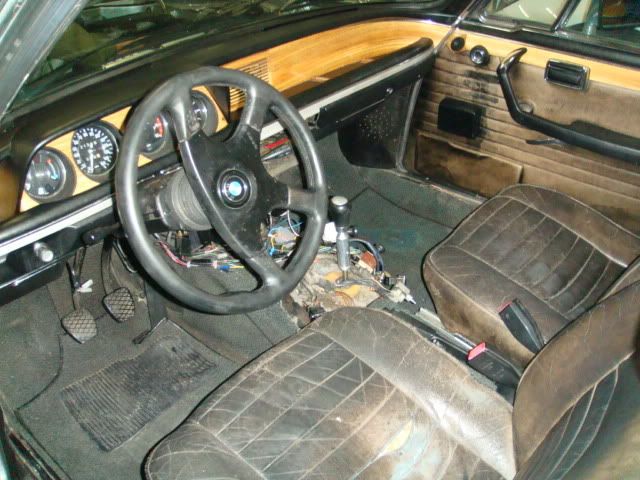

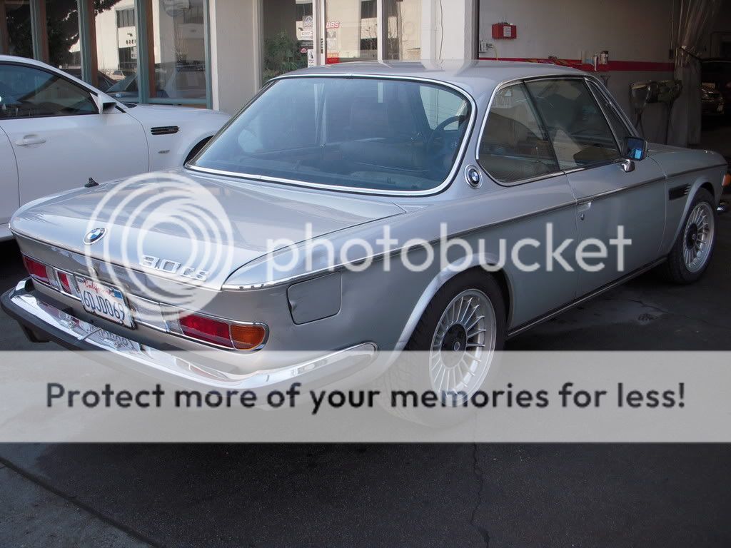

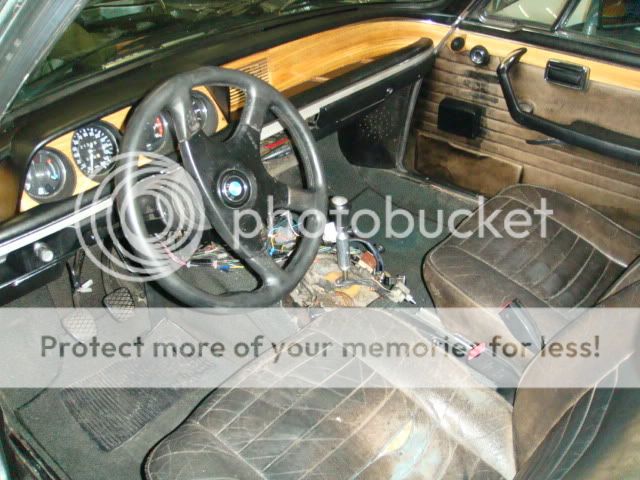

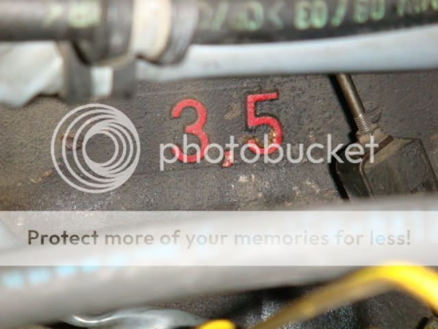

She is a 73 3.0cs with a M90 3.5 (L) stamped motor / Jetronic . She had a euro rear with lots of euro upgrade including a buffalo hide leather interior w/ Zebra wood . Per Mobile tradition she started as a 73 Fjord blu 3.0cs.

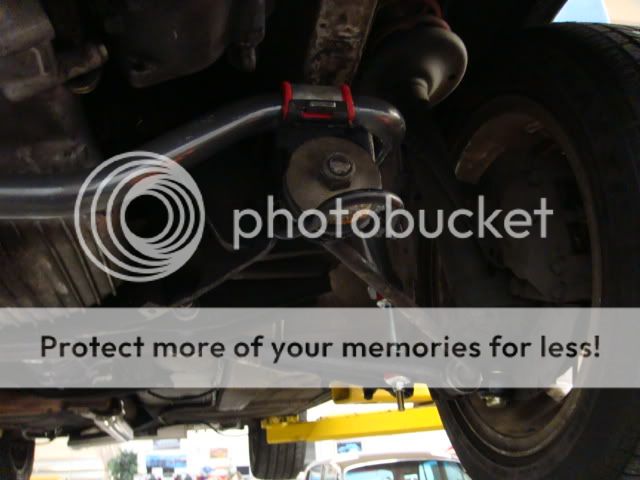

All new tie rods
control arm & H&R sways

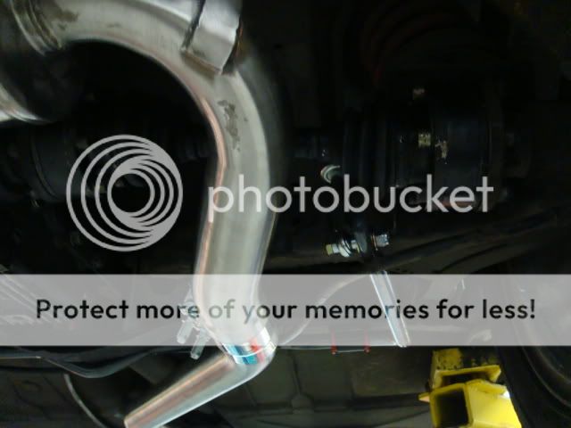

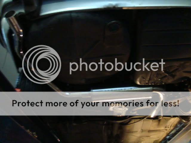

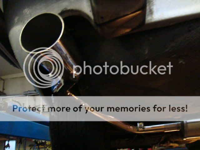

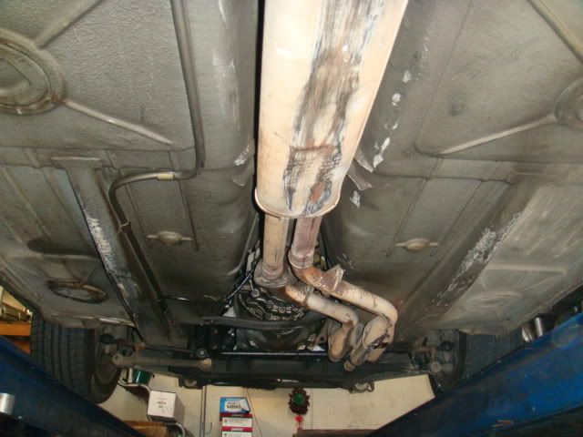

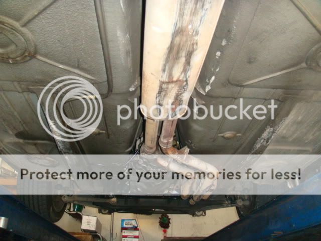

Coupeking exhaust installed

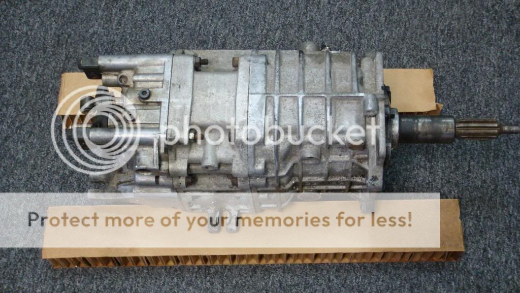

5 spd dogleg CR tranny
New engine mounts

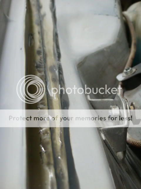

Body work :

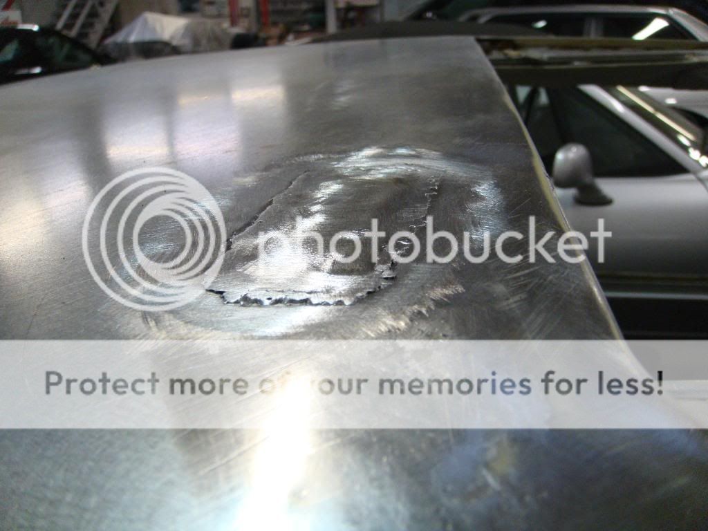

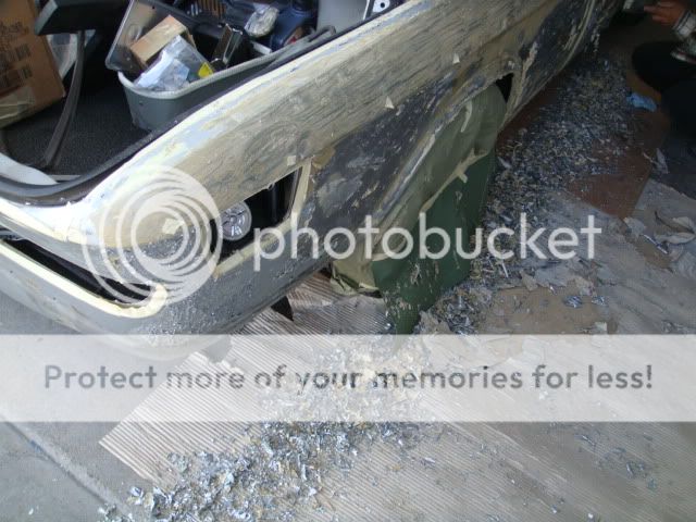

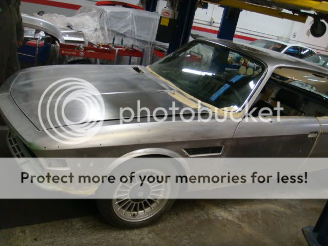

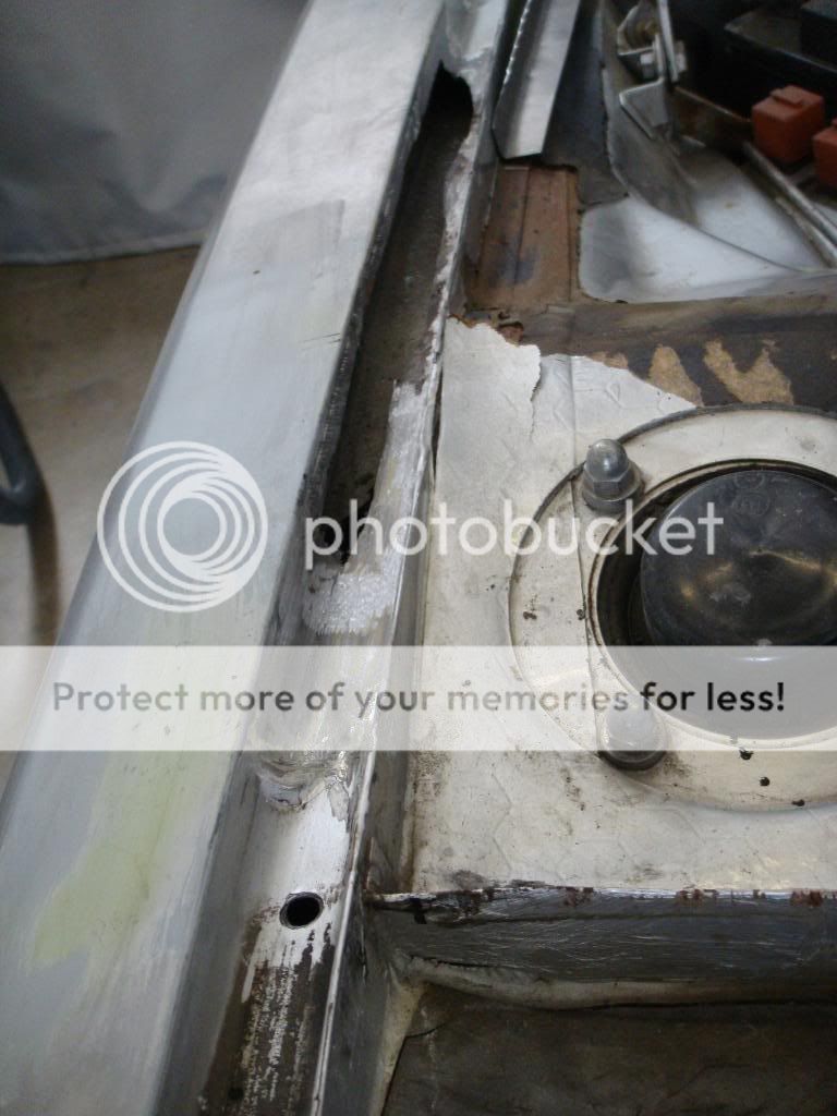

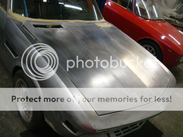

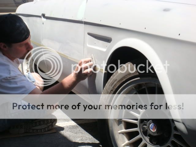

Scraped to bare metal
Pounded all body damage

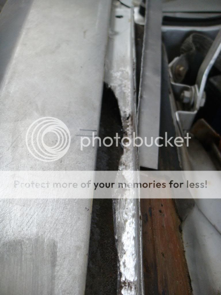

Cut and cured all rust on roof and top of fenders.
Applied polyester , blocked

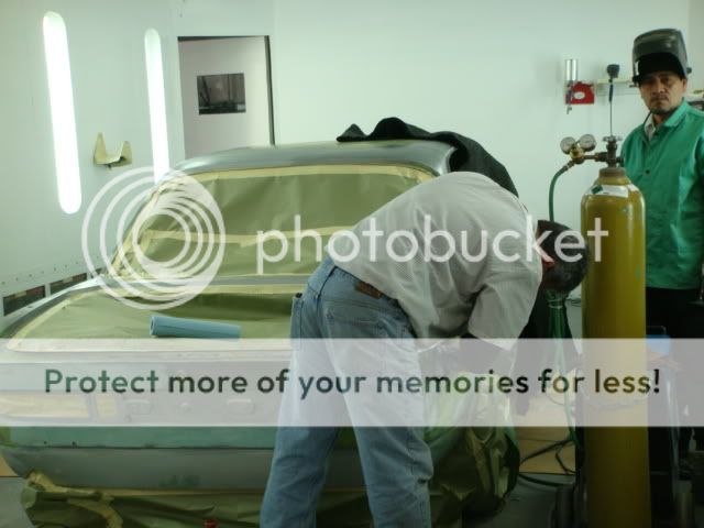

Welded all holes
applied etching primer on all exposed metal and reprimed
All done in 4 months :D

Reblock the primer.
Make sure all lines are crisp and sharp then paint and clear.

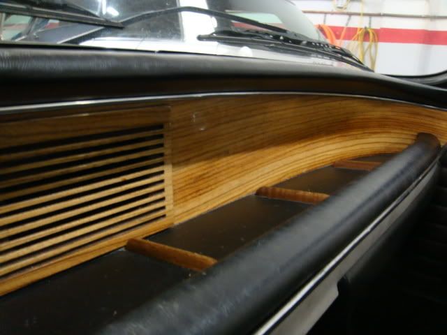

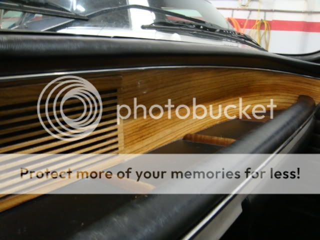

Refinish all wood panels.

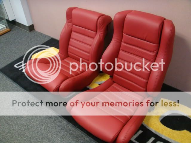

New carpet, headliner and custom red leather interior and 2 front Scheelmann seats.

I've always liked the look of the fully cleaned metal coupes. I almost wish you could just put a clearcoat on it and leave it perfectly paintless, like the very few stainless steel coupes.

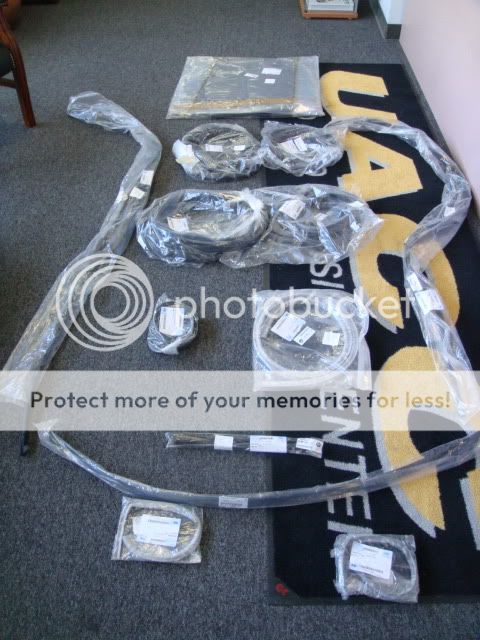

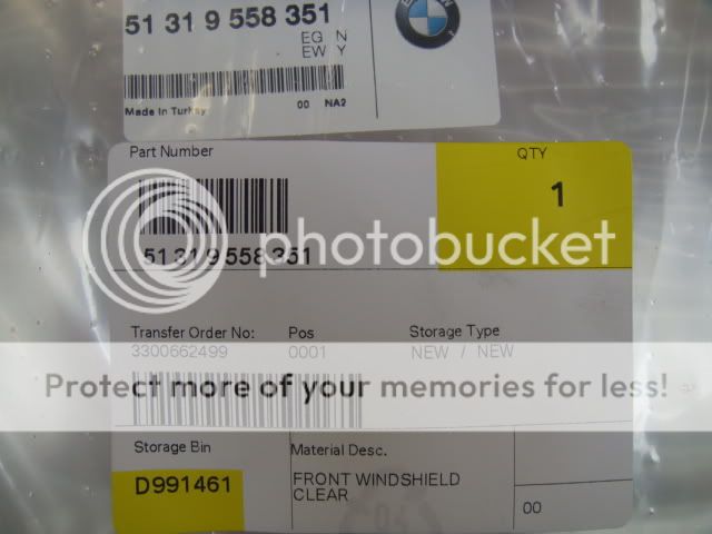

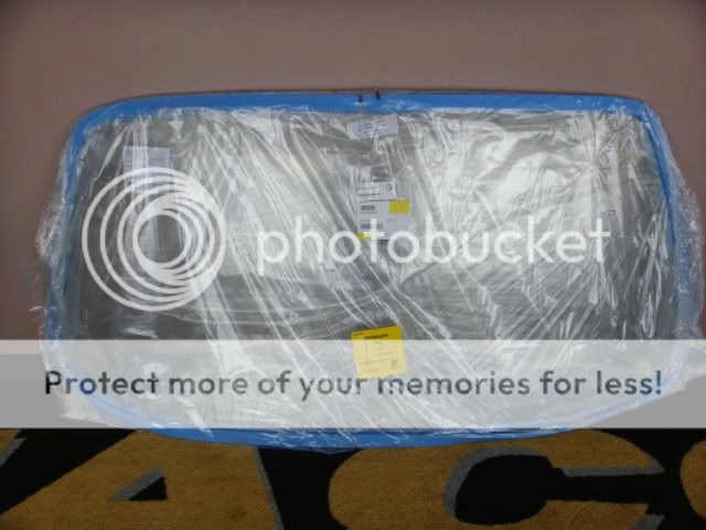

I have been collecting parts since I bought the car. All new BMW rubbers and windshield from the dealer check also had all the bumpers rechromed :D

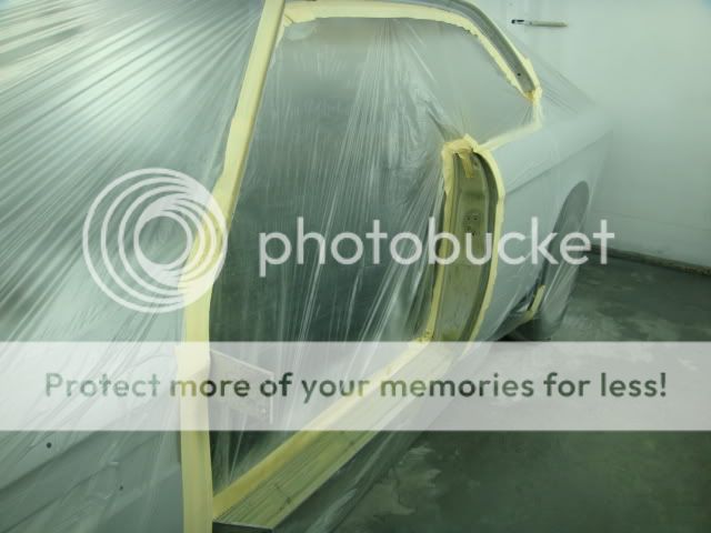

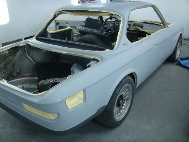

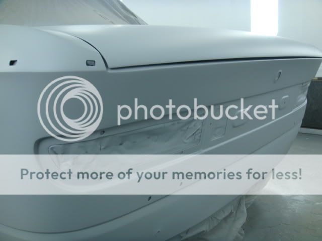

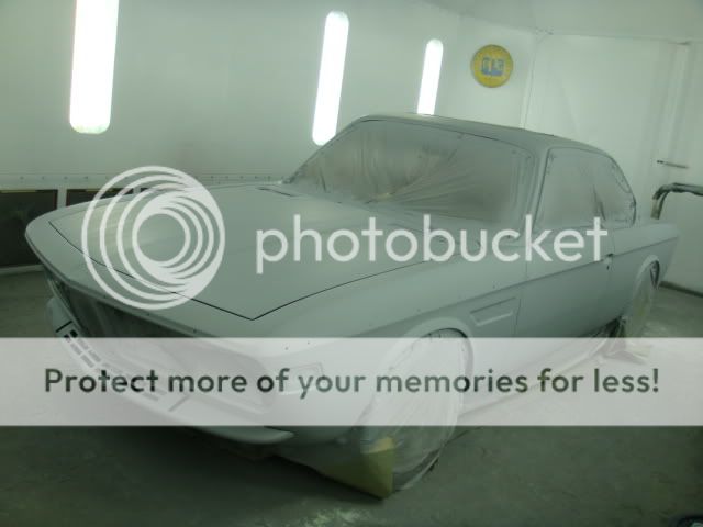

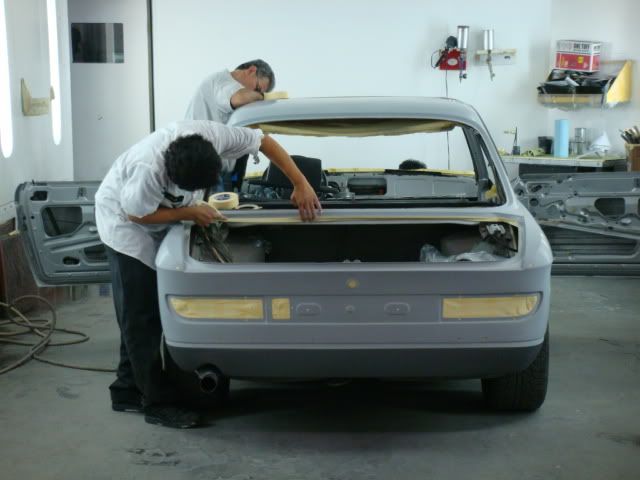

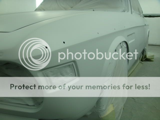

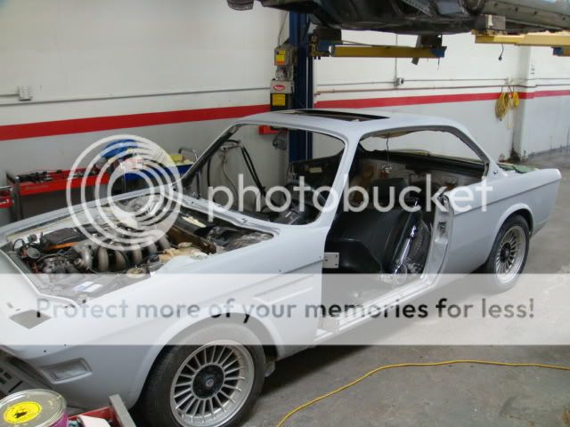

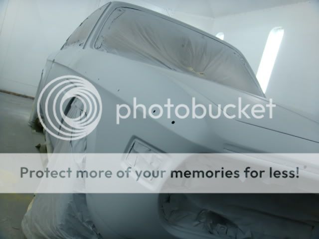

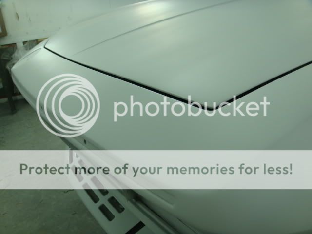

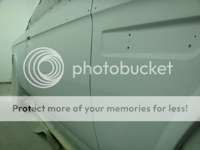

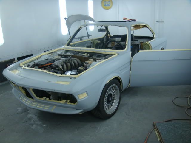

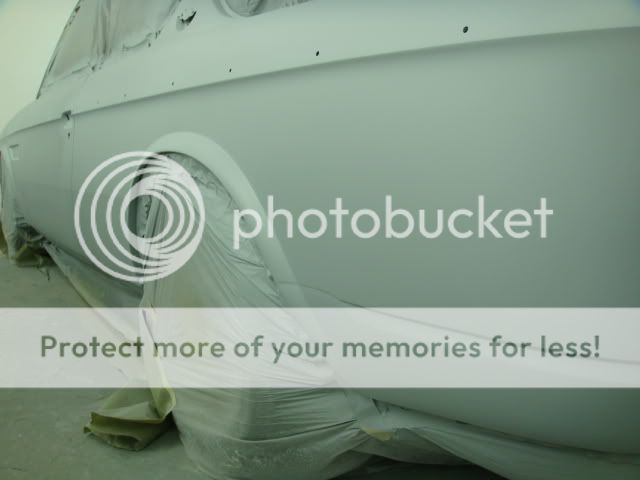

Ready for paint :D

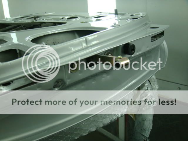

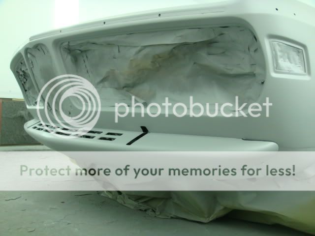

Etching primer applied to all the edges and jams :wink:
Then base coat :lol:

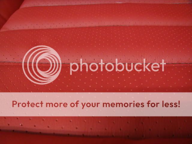

My seats also arrived today. Scheelmann fronts wrapped in wine Napa Leather (Porsche) with black stitching . Rears are custom to match.
Front and rear 8)
Also matching perf leather centers.

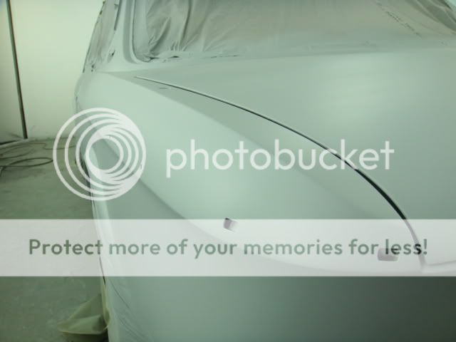

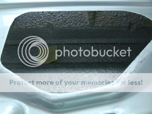

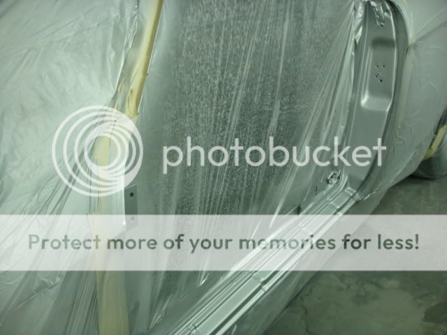

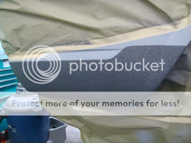

Today I had all the seams sealed with flexible seam sealer and had Fusor undercoating applied all around. Next she gets painted :D
Today is the day =)

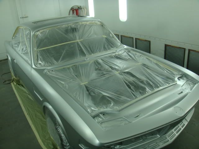

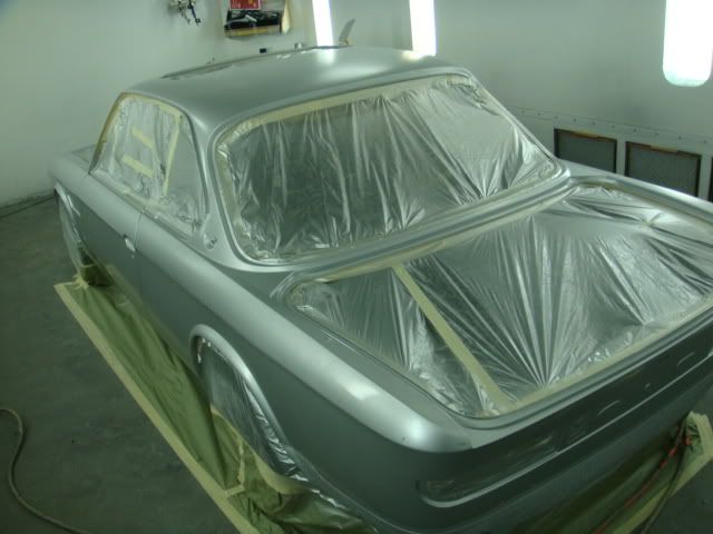

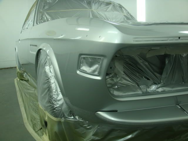

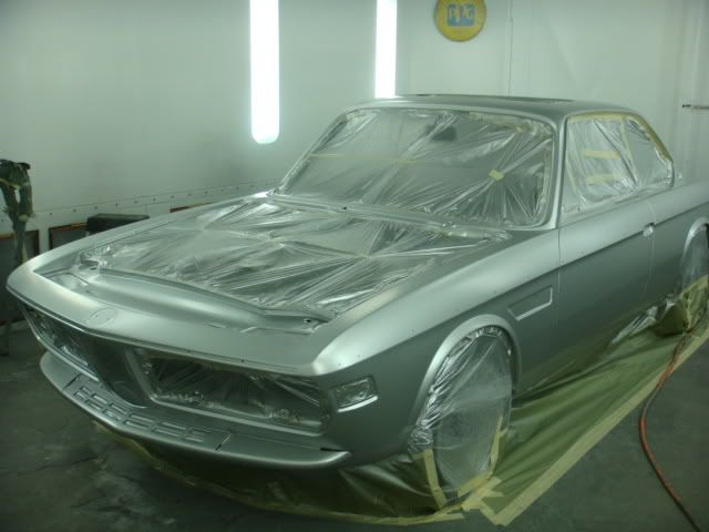

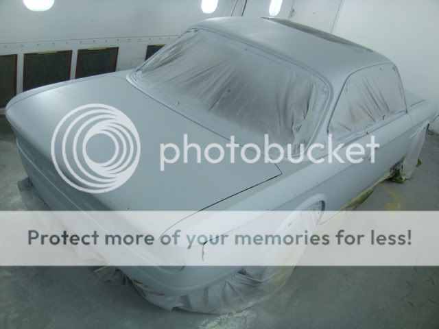

After massive blocking back in the booth he goes :D

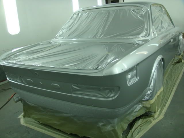

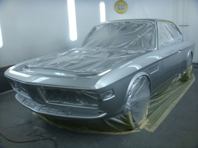

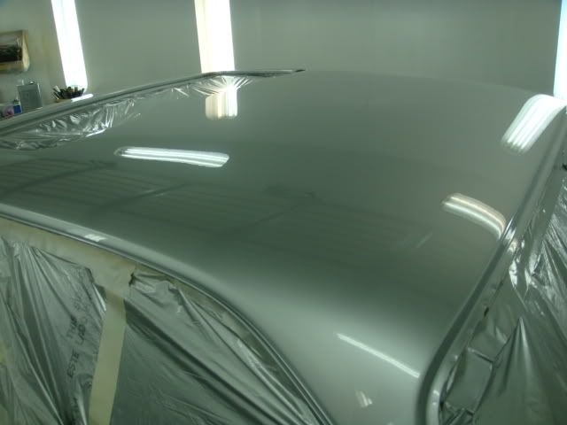

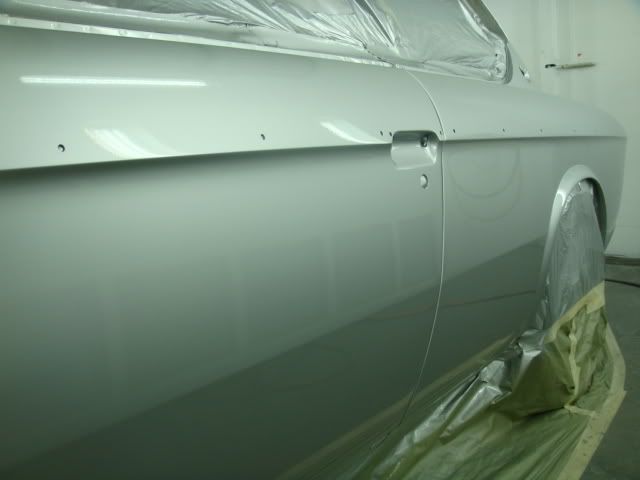

Base coat applied 4x
CLEARED :D

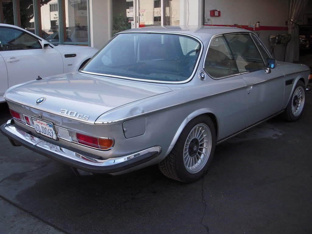

Hi Alvin,
Jabberjaw is looking good.
I never got back to you with photos of the Petri installed, not to hijack your thread, but attached is a recent photo (from one of the few sunny days this summer) of my car.
Thanks again!
