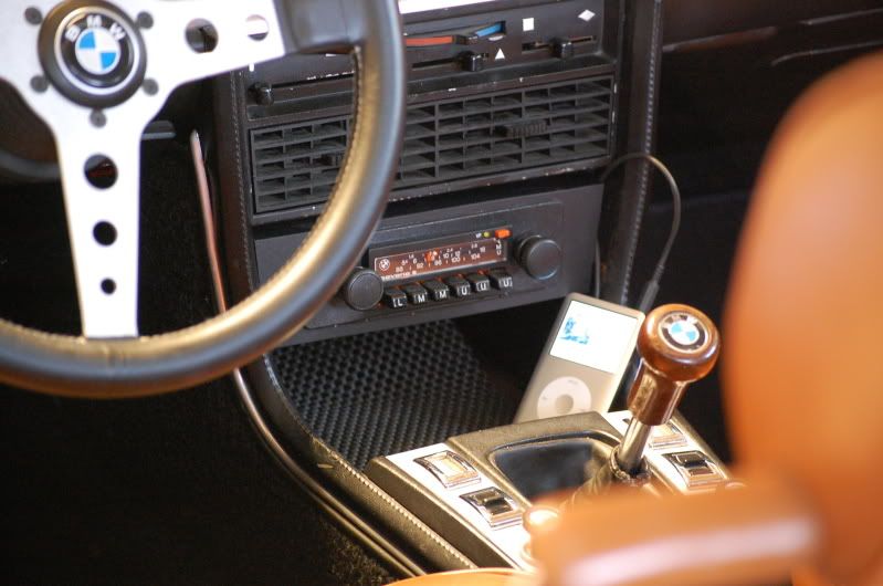

I thought I would share this with the group as I think others would rather keep things looking stock, but also want the performance of a modern radio. I had Turnswitch up in MN modernize a nonworking radio I purchased on eBay. They removed all guts and buffed out the band plate and installed a new board. The new internals are a blessing as radio stations come in better, it’s now IPOD ready and has 180 watts of power. All this is internal to the radio – keeping things looking stock.
While I was at it I updated the 3 speaker system to 6. 2 tweeters behind the center dash grill, 2 in the front kick panels and 2 in the shelf behind the rear seats. I had to work with existing holes on the rear shelf but the other 4 are hidden from plain sight. I was able to locate CS radio knobs in Germany to make this things look factory.. The following link are pics of the install.

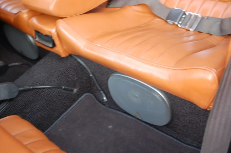

Has anyone tried to put the speaker in the "wall" underneath the rear seats? I had speakers there in an e28 5-series earlier, and it seamed to work OK, and was out of the way.
steve in reno
609
77
reno,nevada USA
The "wall", as you put it, is a very good place to locate a pair of 6x9 speakers. Not difficult to install there and close to the trunk for amplifier.
Works well for sub-woofer also.

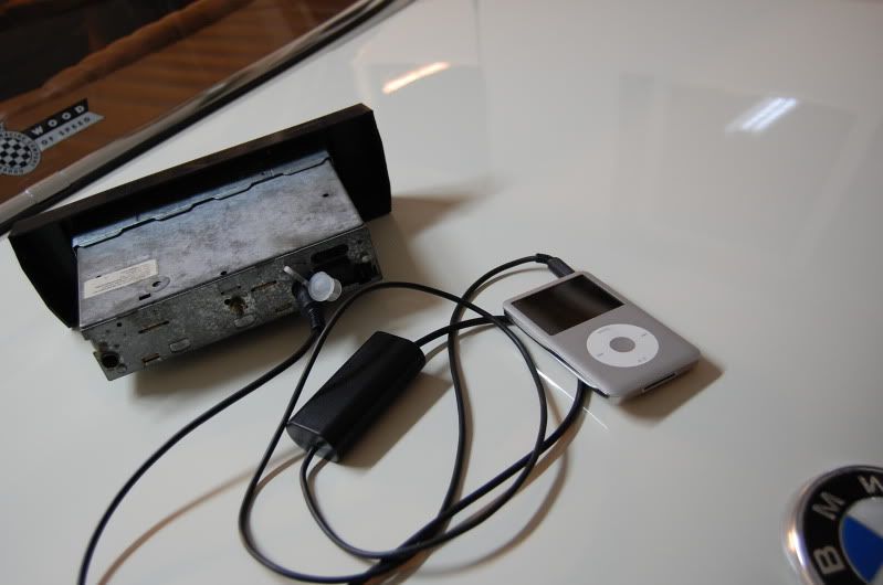

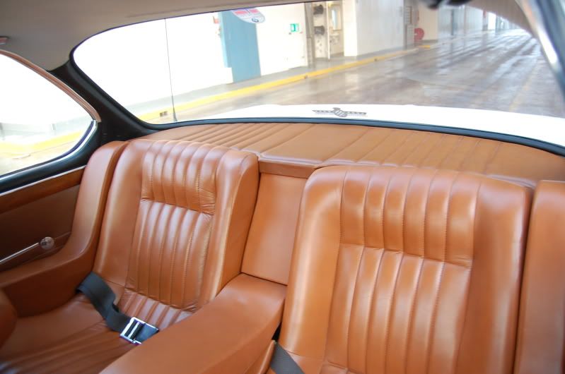

I have done as I was told :)
6x9" speakers under the rear seat, and a new custom made parcelshelf.
I bought a Blaupunkt Bavaria of e-bay, and connected it to my iPod.
It works really well :)
More info about the iPod-adapter here at this german website : http://www.youngtimerradio-shop.de/epages/61037185.sf/de_DE/?ObjectPath=/Shops/61037185
