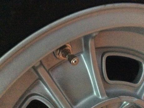

Valve stem installed
Here is a pic of the initial tru flate tr416 installed.
so, bottom line.....inconsistent product from tru-flate. You need at least 1/2 inch of thread to get through the rim and secure the lock nut.

I have the same issue and was hoping to order what you ordered. I see that FCP has the OEM part number you mention, how about ordering that one?

Ya, the consistency in the tr416 that I got is peculiar...All the online pics of the tr416 have longer threads than the last 4 I got. I need to get to the bottom of that Monday.
Most good tire shops will have some clamp in metal stems. The issue is that hole in the bimmer alloys is just so deep so you need a minimum of 1/2 inch of thread.I can guarantee if you head over to your local tire shop and ask to look through their removed valve stem bucket you will find lots of valves. Maybe even some decent gaskets. Problem is, most of them are brass and it clashes with my silver wheels:evil:

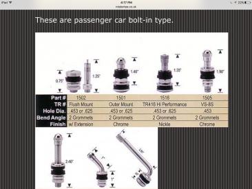

If one found a source for the grommets one could use old stems.
http://yourtireshopsupply.com/product/6786/grommet-0453-diameter-valve-hole-di537
I am sure I have seen that hat shaped grommet somewhere else. They are most likely used in plumbing and also in tire pressure monitoring systems. I just can't remember where?? I am still poking around trying to find grommets.
I have 4 more stems coming on Monday I will forward the details when I have them in hand.
Haltec, Slime, Dill Eaton etc. seem to make that grommet so they are out there.
I just haven't found an easy source Similar tyle of valve stem is used on motorcycles, trucks, and cars that go over 130mph8-). Needs a .453 diameter hole and a step.

More examples for reference...

Valve stem for 14 inch alloy
So,
In the end I used a motorcycle valve stem. Perfect.
I would be curious how many people are running rubber stems. One is too many:)
