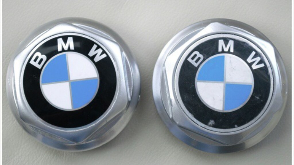

Replicate Before Sale:
I have been talking with a fabricator. I am going to scan the AC Vents, The Can relay receptacles, and the headlamp thumbscrews.The center cap on the left below is 3D printed. It isn't perfect, but none of the parts I'm scanning are terribly complicacted.
Edit: This is now happening here
I have been talking with a fabricator. I am going to scan the AC Vents, The Can relay receptacles, and the headlamp thumbscrews.The center cap on the left below is 3D printed. It isn't perfect, but none of the parts I'm sccanning are terribly complicacted.
Which 3D printing did you use for this? Looks too good to be FDM. SLA maybe?
And which type of plastic?
You know I'm not sure. We just started discussing. I know that it is a hard white plastic used for prototyping. The printer doesn't leave the fine lines like you see on the UPS Store or Home Depot printers. I know nothing about the process but look forward to learning more. I do know that the caps were printed from an existing file. As another forum member and I have discussed, the hard part is turning a 3D scanned image into a CAD file. Jay Leno's garage makes it look easy.

You know I'm not sure. We just started discussing. I know that it is a hard white plastic used for prototyping. The printer doesn't leave the fine lines like you see on the UPS Store or Home Depot printers. I know nothing about the process but look forward to learning more. I do know that the caps were printed from an existing file. As another forum member and Inhave discussed, the hard part is turning a 3D scanned image into a CAD file. Jay Leno's garage makes it look easy.
*insert another advantage to being an engineer :razz:
I've got CAD and access to a couple different 3D printers. But similar to you, I'm short on time.
Let me know if you get serious about wanting to duplicate those parts.
In my mind, the image scanning is the most difficult part. That equipment can be quite expensive, and sensitive.
