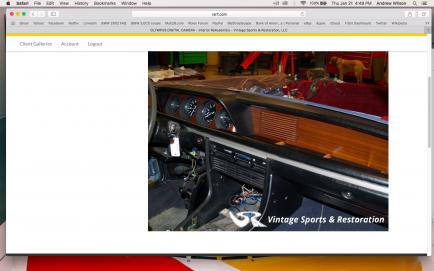

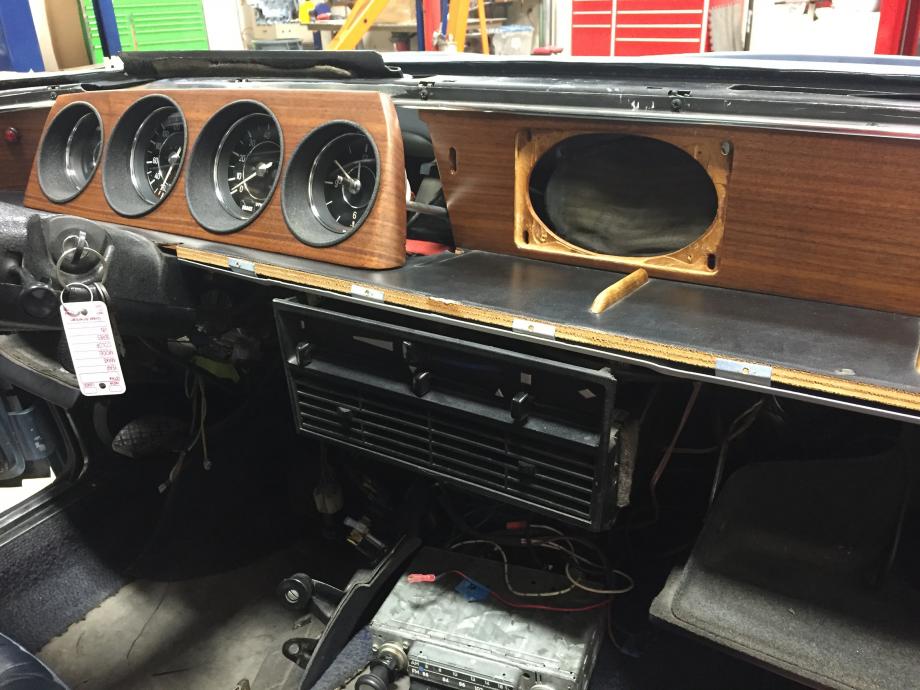

What is the correct wood veneer for the CSL?

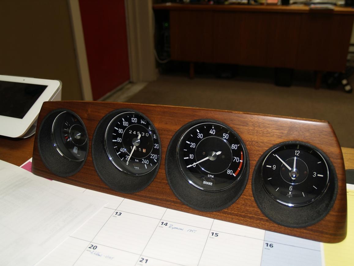

I have got some samples of Quarter cut European Walnut and just want to check before I buy it.
The American Walnut looks a bit too dark, but having said that every tree is different!
Any help appreciated.
Regards
Marc

here are the two samples i have
Looking at the pictures shown of the new recon dash, the Qtd cut European Walnut is the one - i just now have to learn how to do it!
