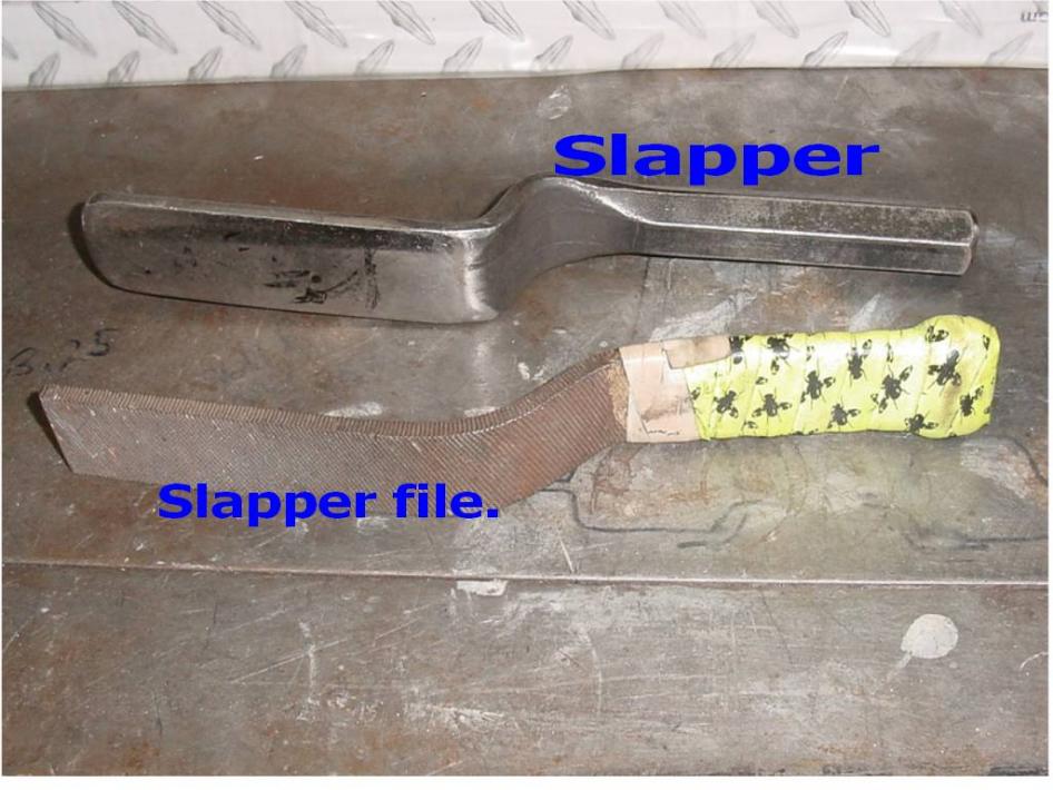

There is also a tool called a slapping file, known as a “slapper” that will work the same on body dents, but having never done this, you will have to experiment. Tool should be available at a body shop supply store
Bert, just to keep things straight for someone intending to buy these tools. A slapping file has teeth and will make the metal look something like a corn flake after pounding on it. A slapper (the Brits call it a flipper) has a smooth polished face and radiused edges and generally will not mark the metal when used by someone experienced. They both are getting harder to buy new now, they are sort of “old school” tools that have fallen out of favor with modern body men. ~ John Buchtenkirch
Makes sense to me. I have always, on the rare occasion I used it, gone with the slapping file. On an older car where the body was made of “real” metal, I was always able to bring it relatively smooth by finishing of the bare metal with a vixen file
