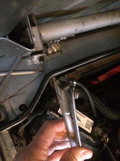

For some strange reason the hinge/ bracket that holds the hood up broke off the bar that runs accross the front of the hood. I wonder what would cause this. I plan on having this welded back but I'd like to know what caused this in the first place so I can fix the source of the problem.
Has anyone had this before?

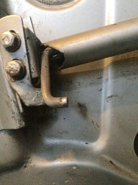

Fortunately I got to mine before it cracked open:
And then spray painted per Peter's mention.
