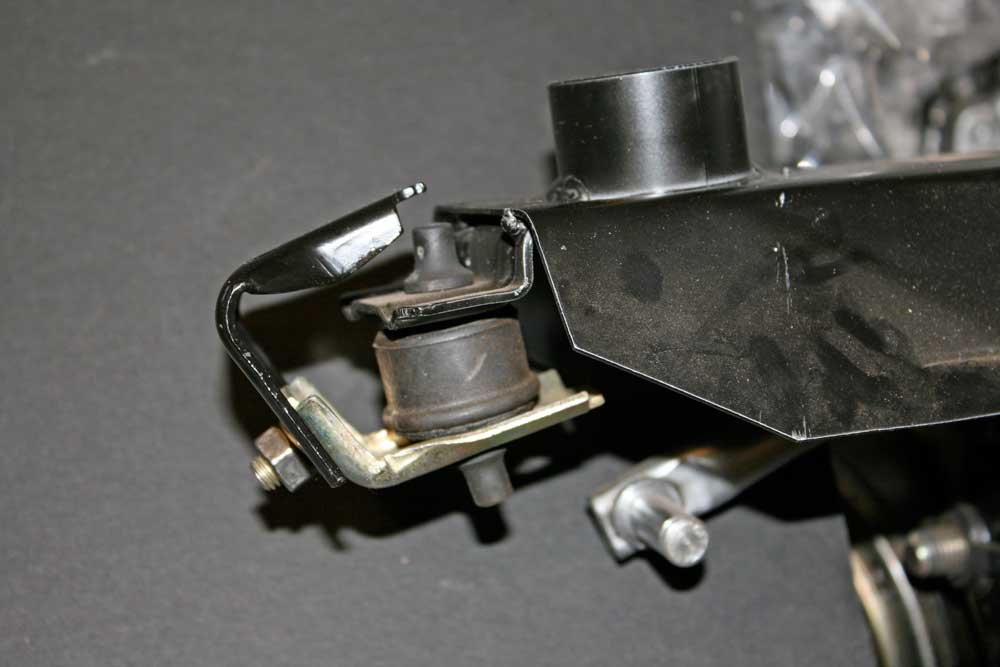

You will also want the DSSR 147 mm double selector rod and ask for the shortest selector rod joint. This is the piece that connects the 147 mm rod to the shaft coming out of the transmission. See photo. This will ensure the shifter is in the correct fore/aft position and keep reverse from hitting the console.
The platform is mounted slightly differently to the transmission. The 4 spd has only the four isolation fittings. The 5 spd has only two isolation fittings and then a rear support to the underbody via either a bushing with a threaded rod out each end or a more elaborate built-up install (like in the photo).
Note - the UUC shifter does not come with a threaded shifter to receive the old style knobs. Maybe someone could thread it for you?
I made a home made short shifter by extending the eye on the bottom of the stock shifter by 5/8". Not quite as smooth as the UUC one.
