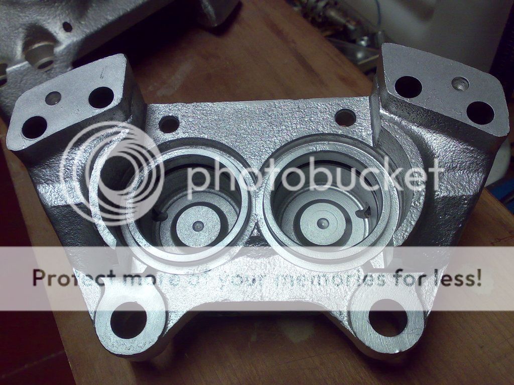

as no Access to yellow bi-chromat, i am using matt chrome process:

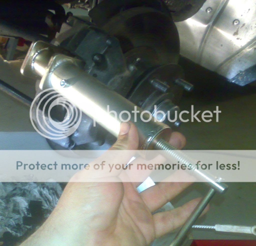

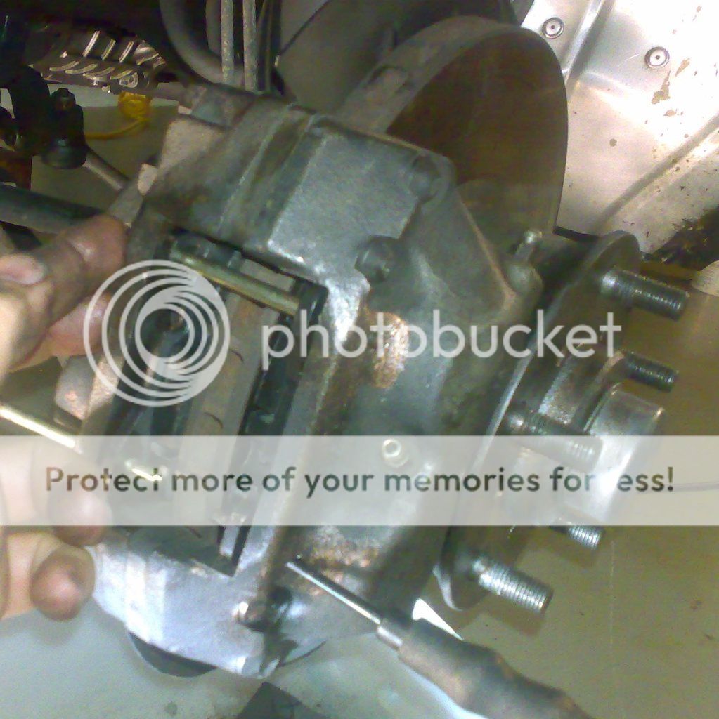

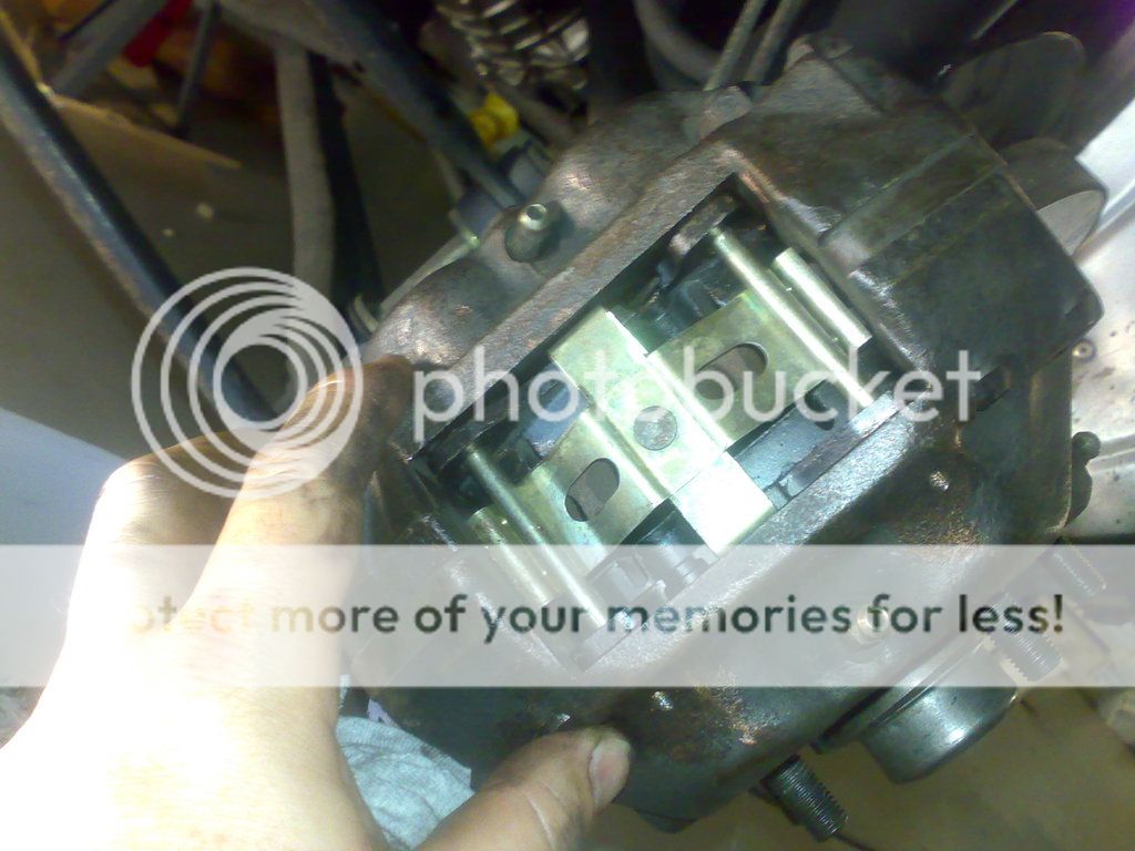

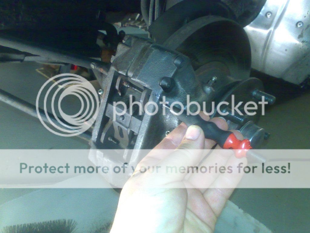

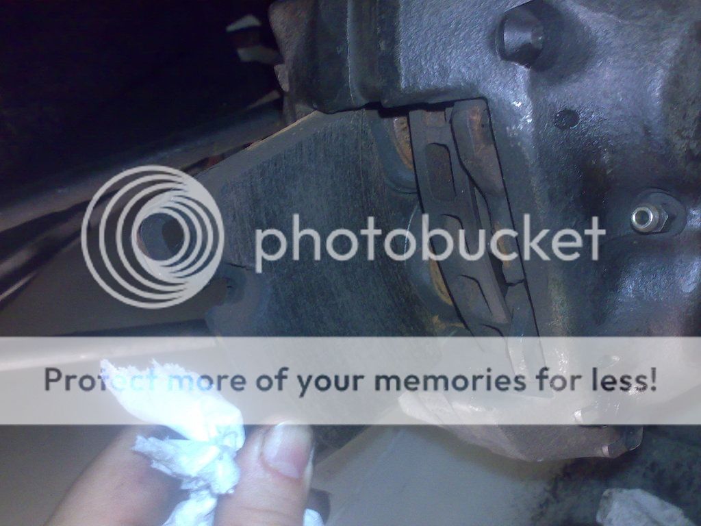

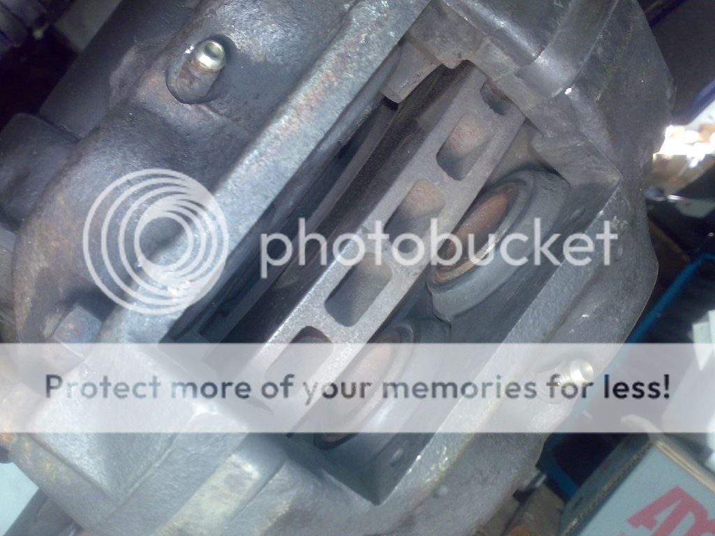

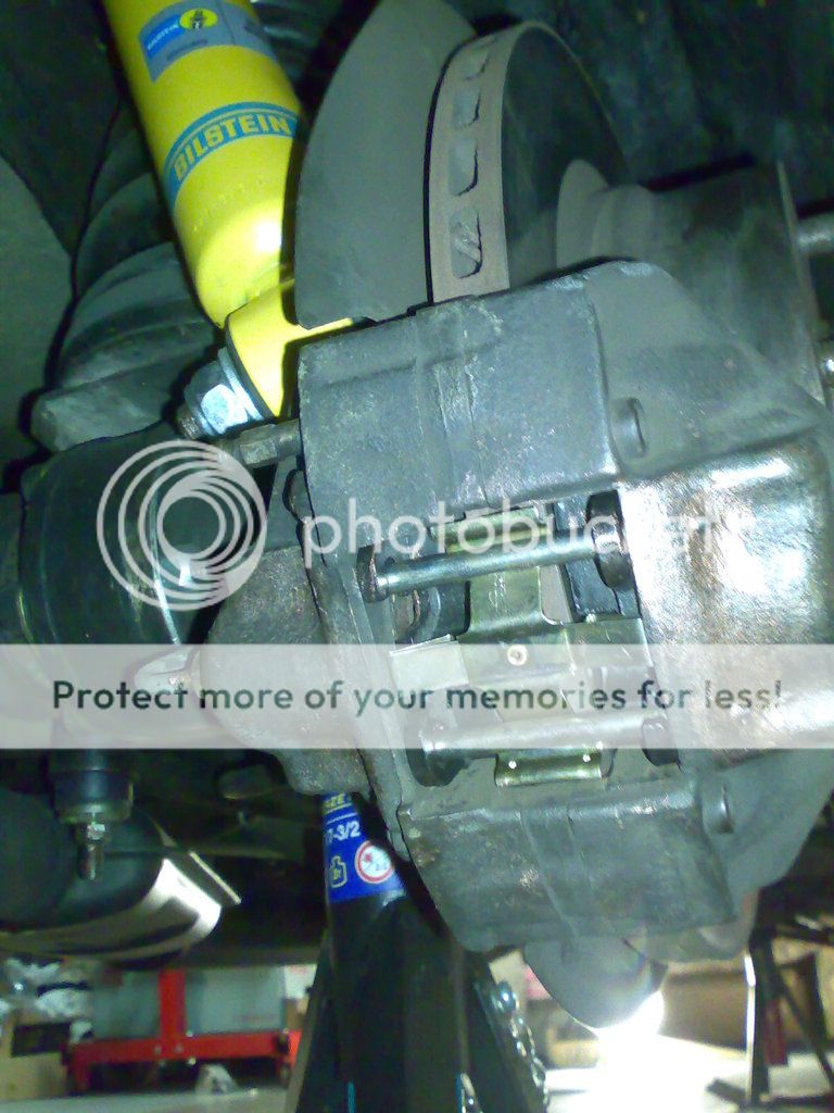

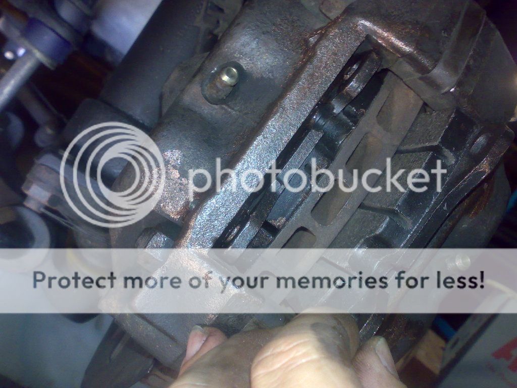

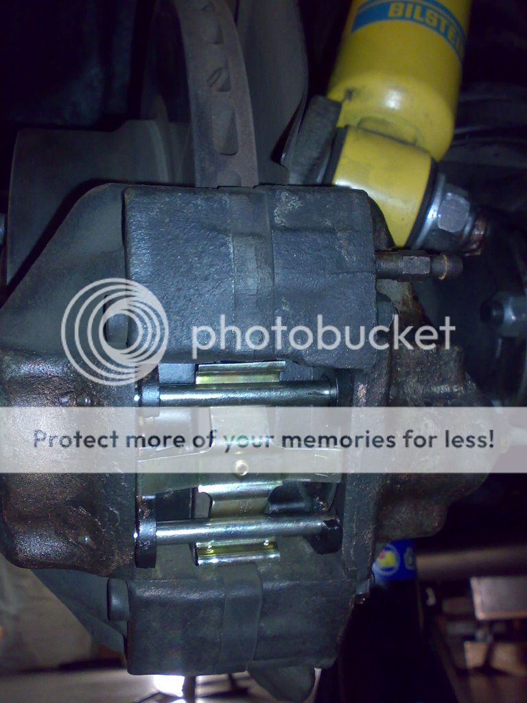

This is an interesting tool. Is it homebuilt or purchased? I assume it's used to press the pistons back into the calipers so you can fit the new pads? I usually end up using a crowbar.

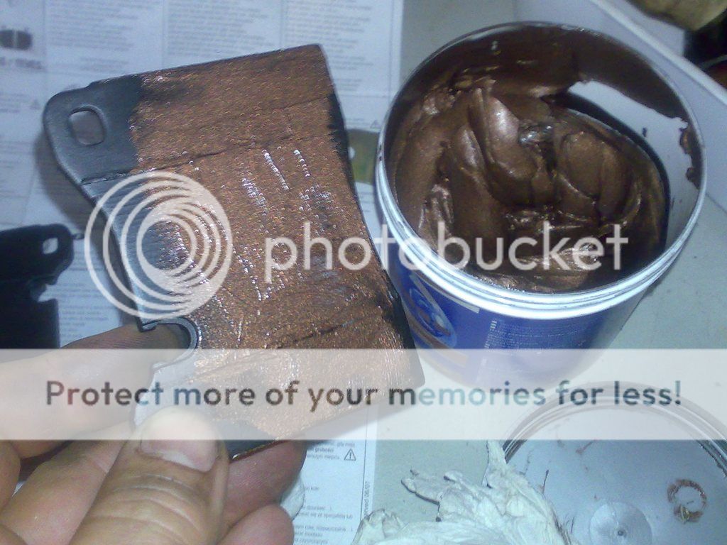

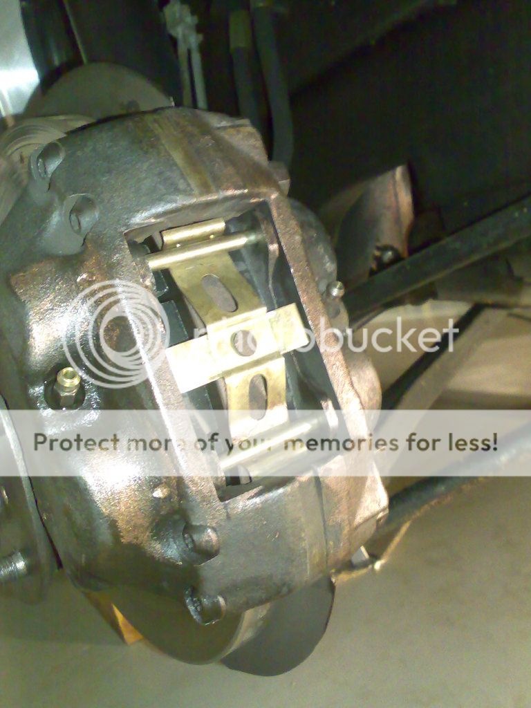

Copper never-seize on the back side of the pads. correct?
Good work and thanks for the excellent documentation, as usual!
deQ, how about a picture of the tool when its not mounted to the caliper. this is a kewl tool.
well, thanks, the tool that you are referring to is a hazet tool to press the postons back
it is simply a screw that moves two thick rectangular plates, it works very well
the fat on the back of the pads is copper grease, yes

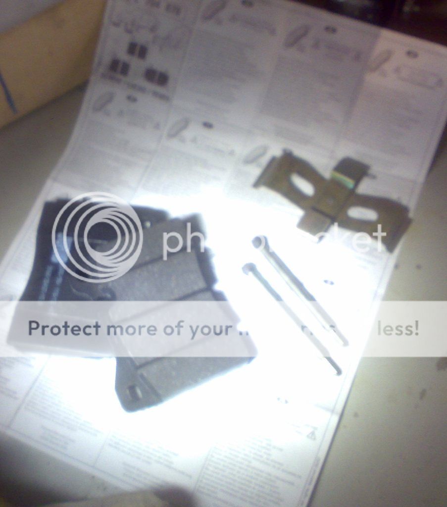

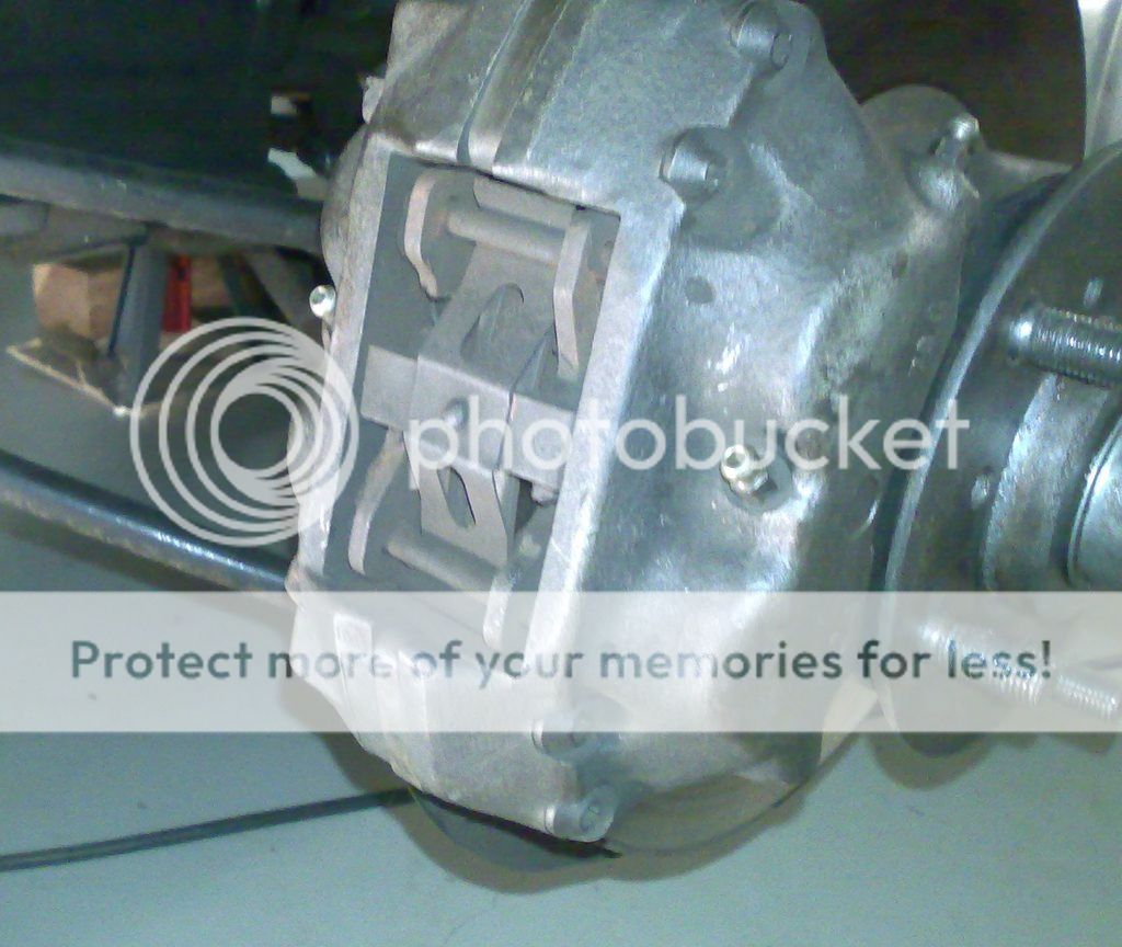

take a look to this ebay selling advert, these are the brake pads i installed same brand and reference,
http://www.ebay.com/itm/NEW-JURID-5...BMW-1968-1986-FERRARI-1969-1989-/121557156562
what do you think of the raingrooves ? terrible, right ? i can tell it is not the original jurid box, but what is critical, the irregular raingrooves tell a lot of the origin of these parts, my pads raingrooves were absolutely regular

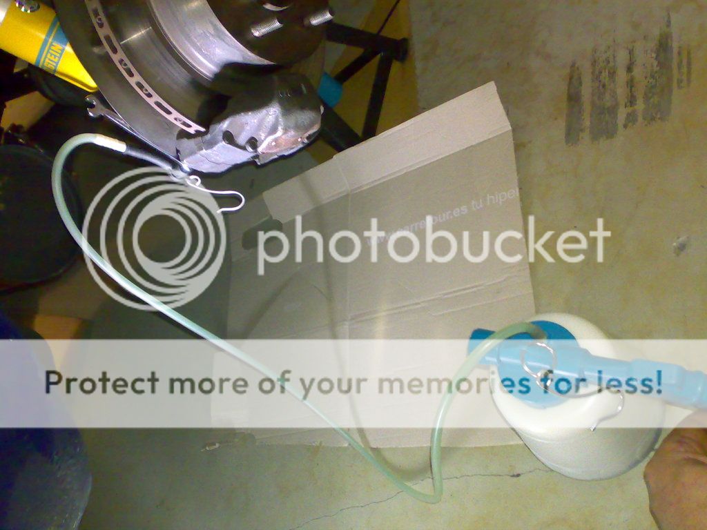

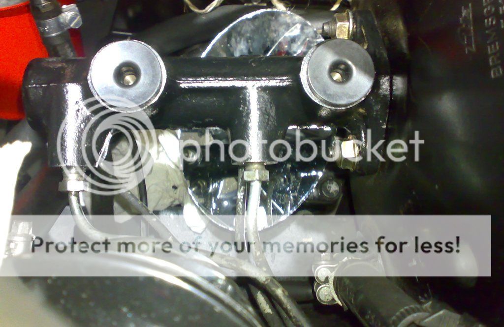

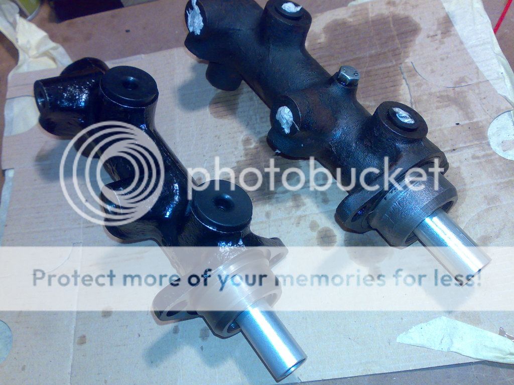

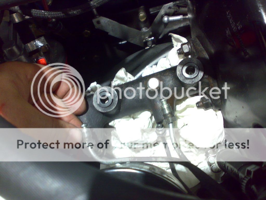

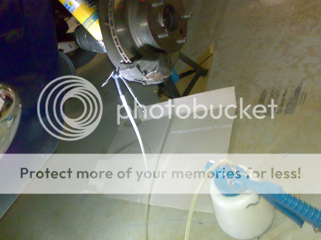

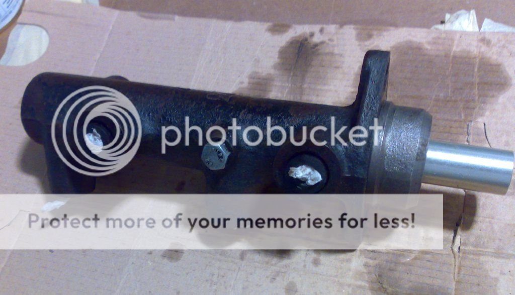

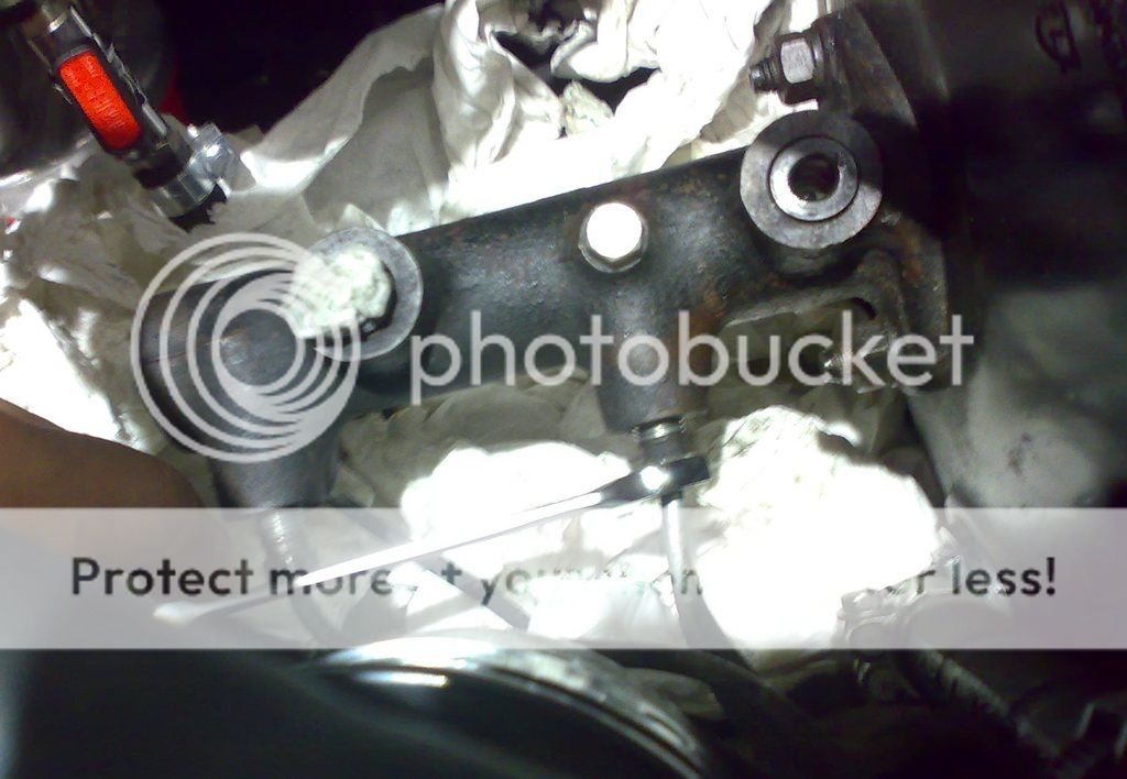

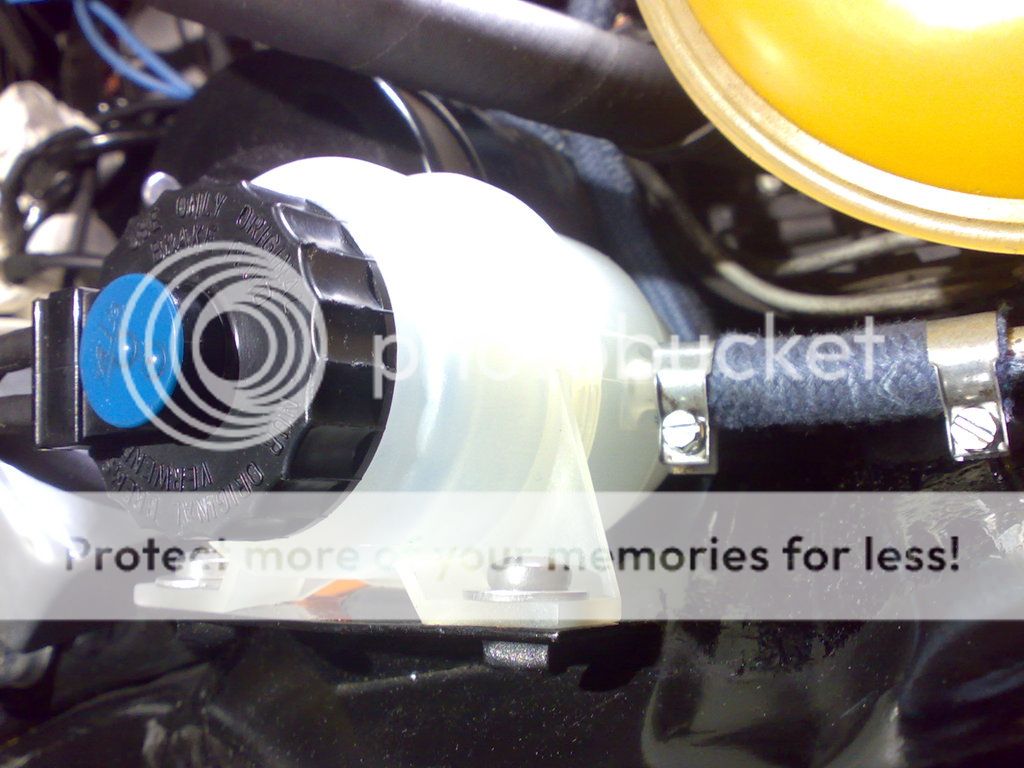

as it has been two runs with the coupe with the renewed elements i would like to post feedback
actions were:

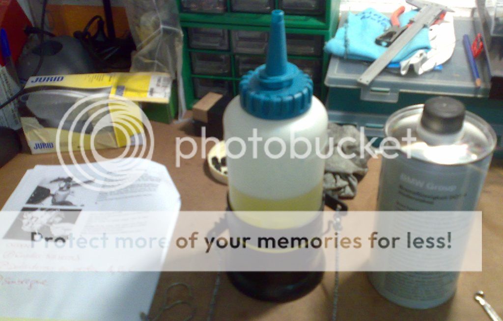

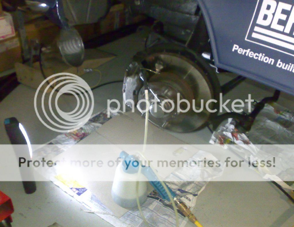

renew brake fluid totally
new brake pads
new brake master cylinder
previously my brakes were good but not perfect, a bit like when you press a very thin layer of snow under your feet (i said a bit) the feeling of something similar to that
ok, now the feeling of the brakes is much better, nothing of that suspicious feeling that i mentioned before, brakes are smooth and strong, even considering that i am bedding the pads so not fully peerforming
