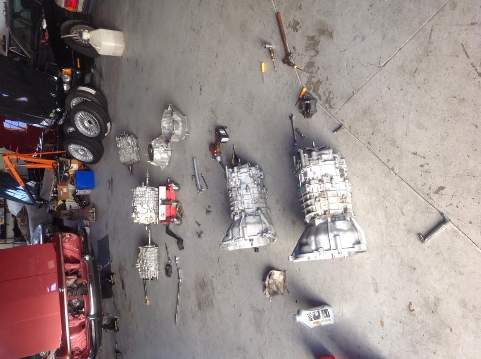

Why not just get the 265/5 in the beginning?
Tranny day today at the shop!
