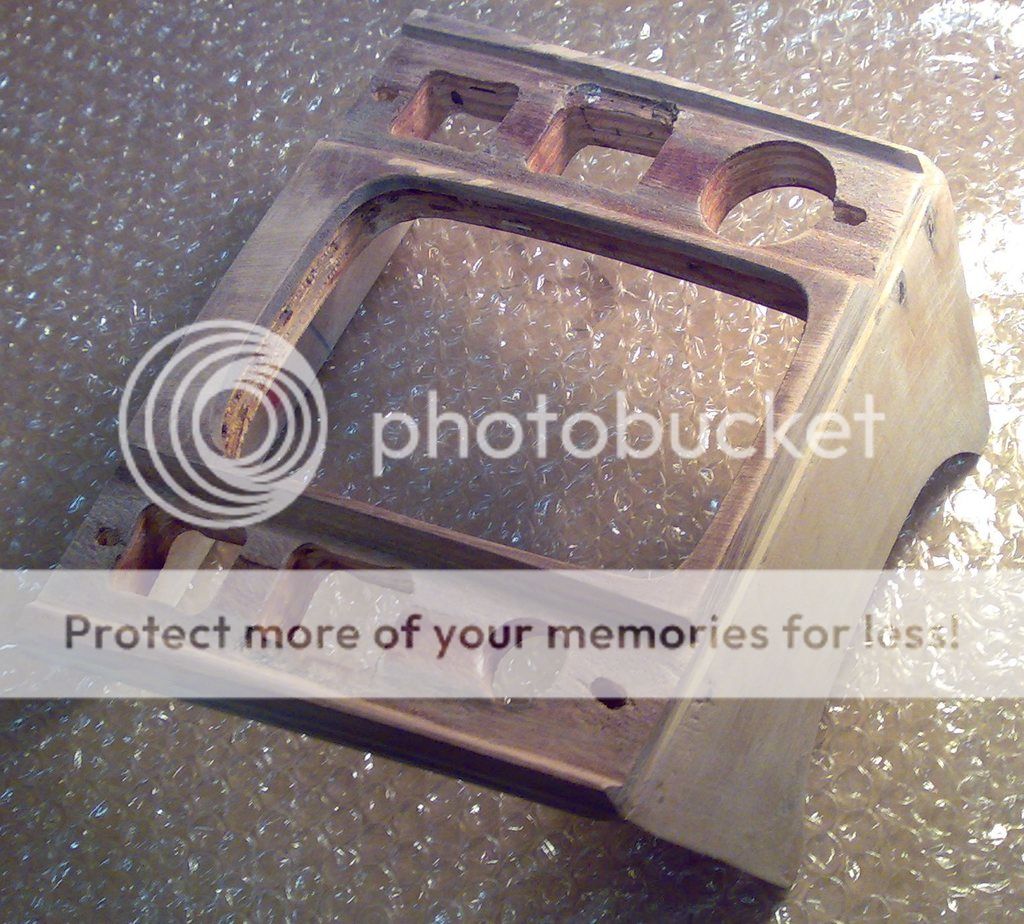

these cars are so easy to fix, simple materials, Wood, metal, leather,...

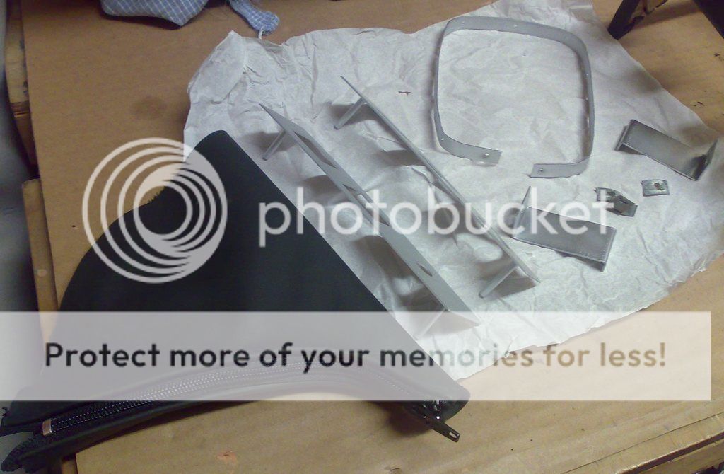

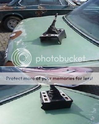

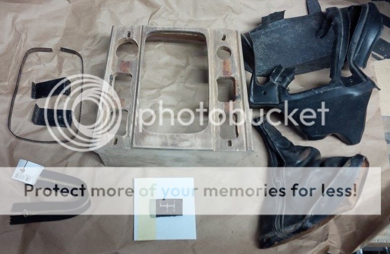

got this central gear shift console from ebay

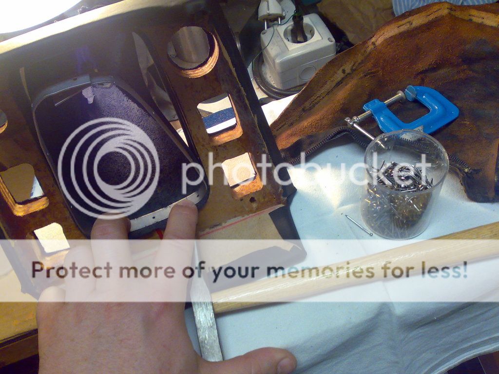

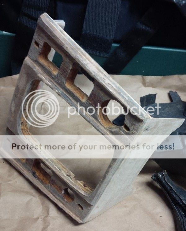

just remove nails, and peel off the covering

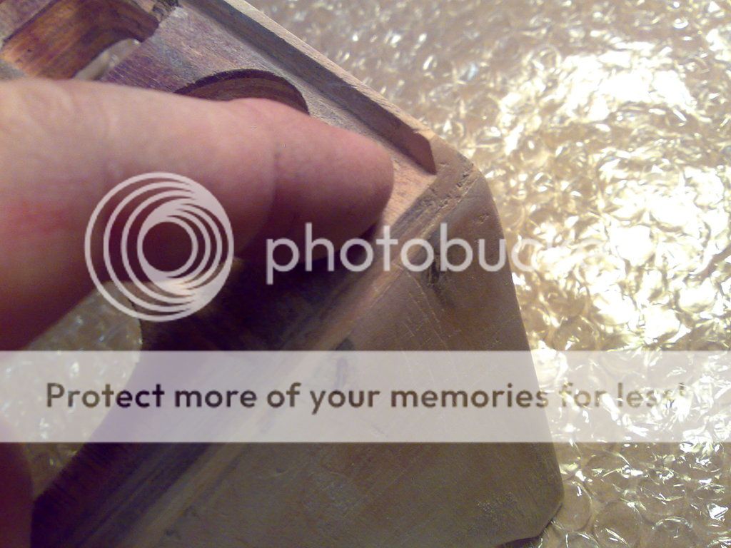

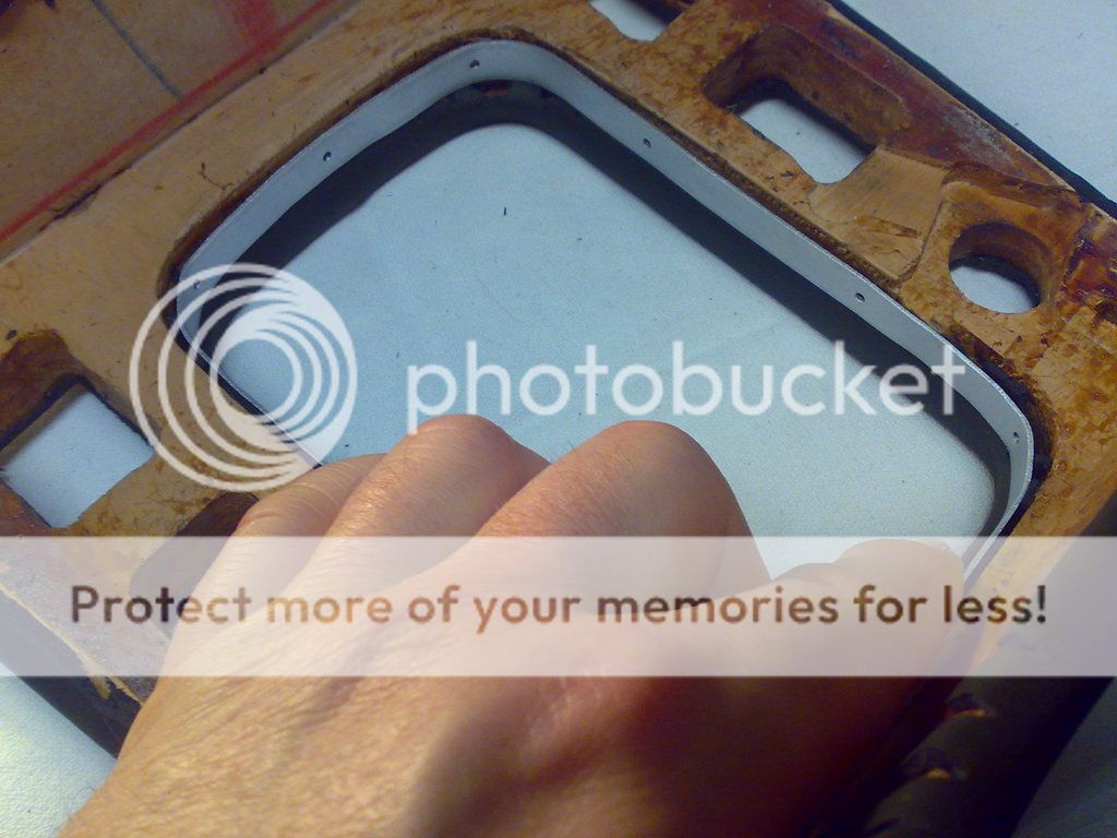

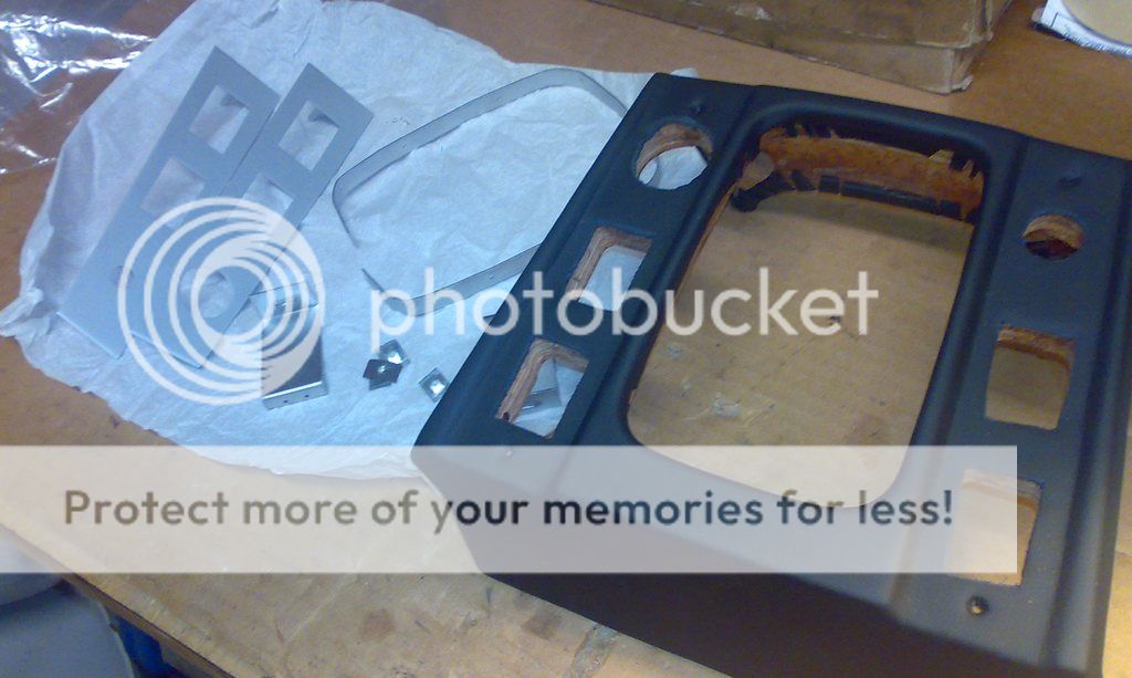

the problem is that bits from the Wood came off too, a pity, wood was partially dissintegrating, so i ahd some of the shapes with really big dents, a challenge, cos if you do not redefine the shapes the upper leather layer will show all the imperfections
so i had to redo the Wood, using wood mastick in excess and then a file and sand paper to redefine all tiny details

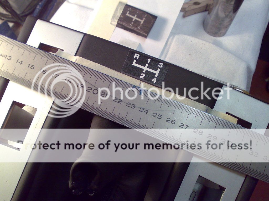

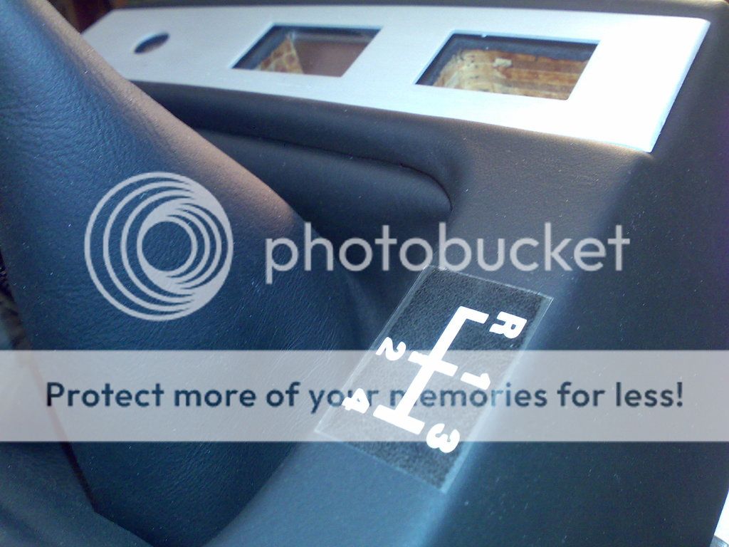

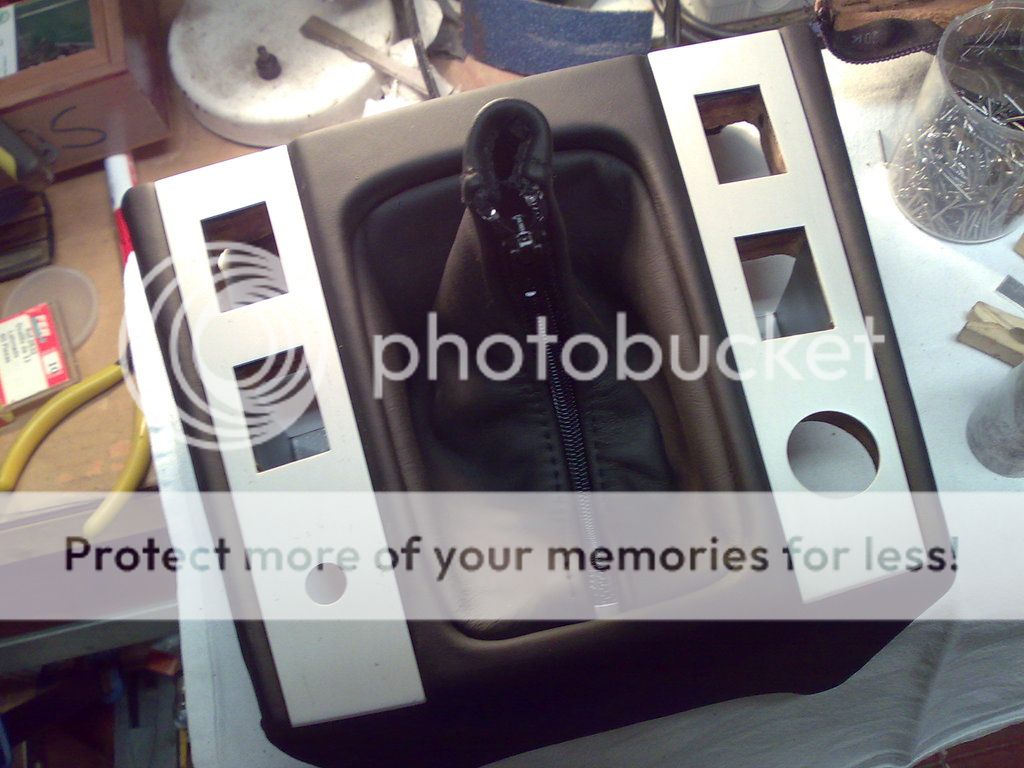

it has been a long time, recovering all the bits, including chroming, anodizing,...i chromed the steel supports and the all round plate that fix the gearshift boot, i reanodized the upper aluminium trim plates, extremely delicate pieces, if you break a support, you must find another one,...

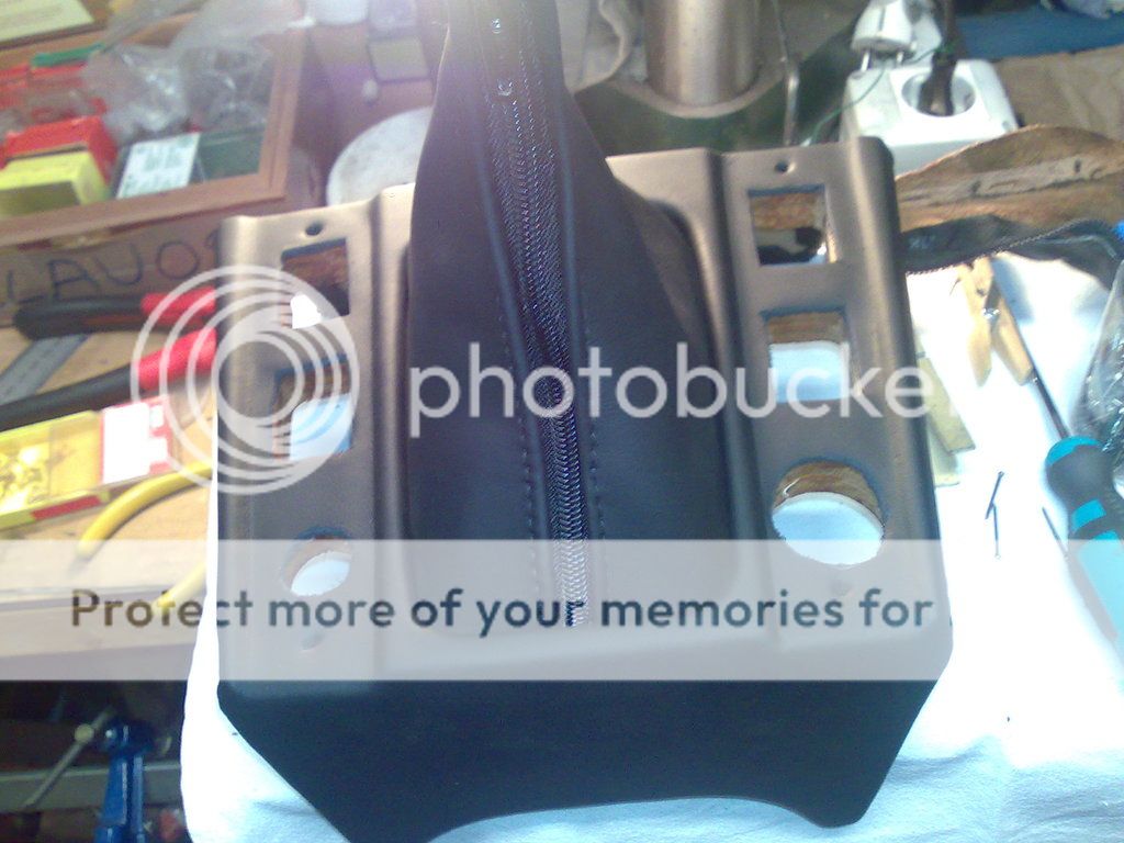

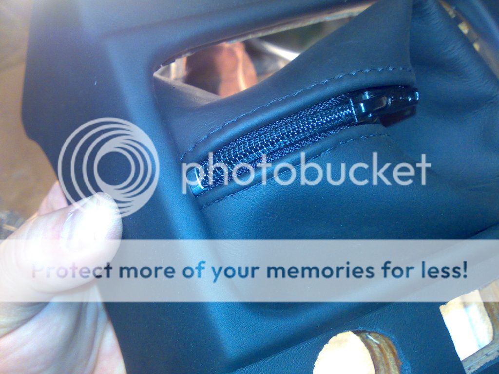

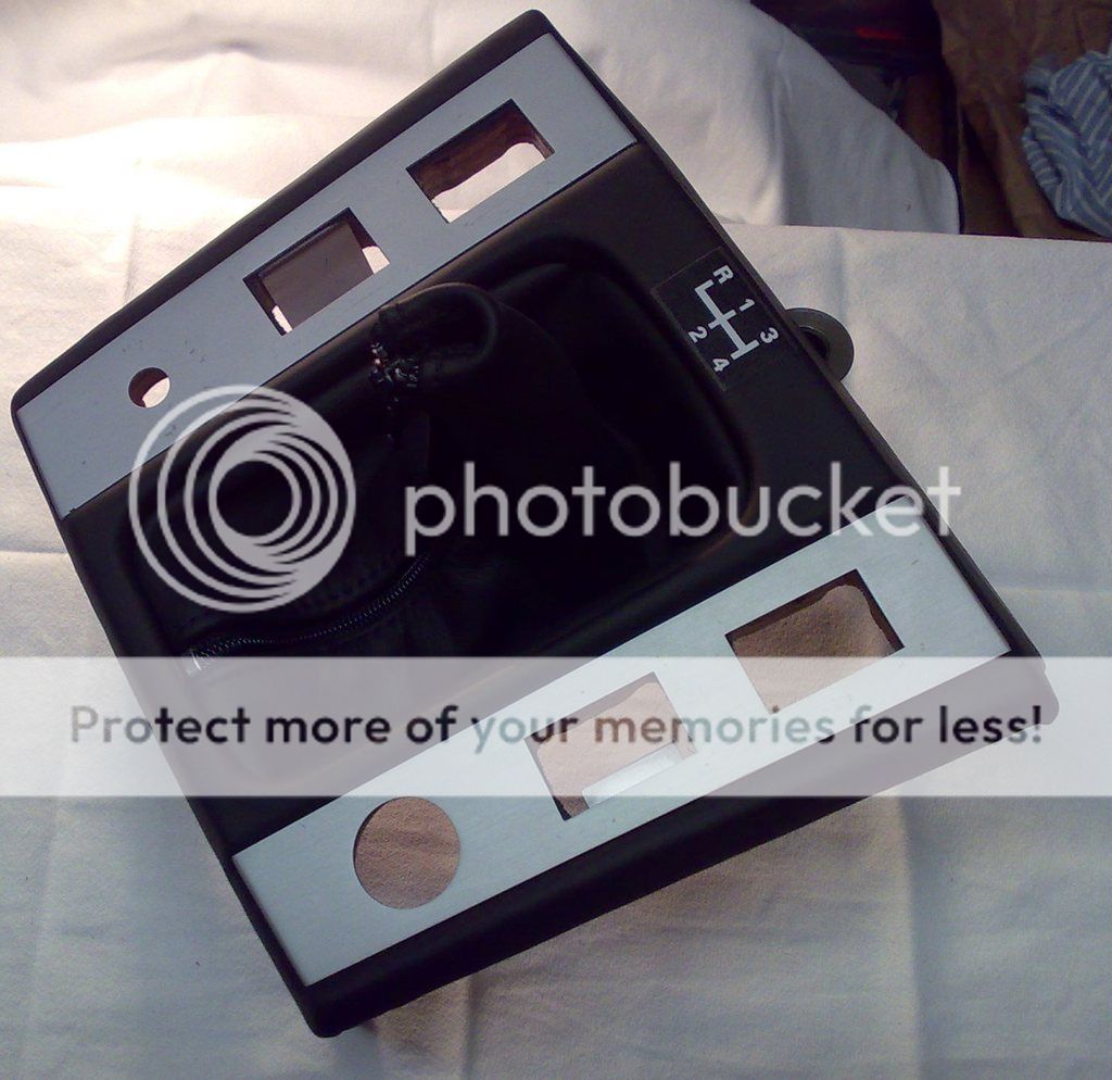

leather and a new plastic zip almost the same as original

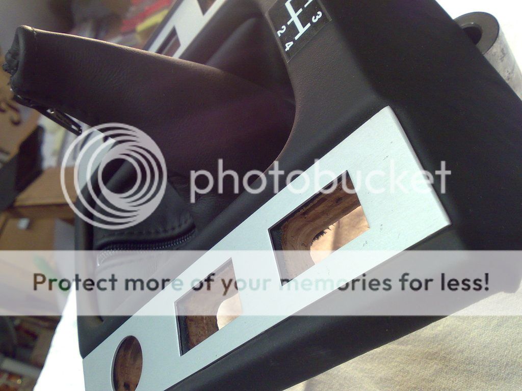

Excellent job. How did you get the material/vinyl to follow the contours of the wood frame so very well ? I see no bunching or folds as I would expect if I had attempted such a job.
Really very nice.

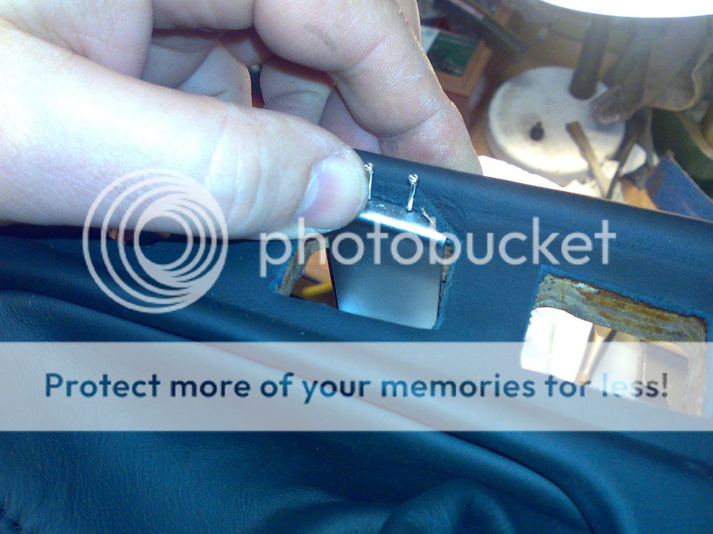

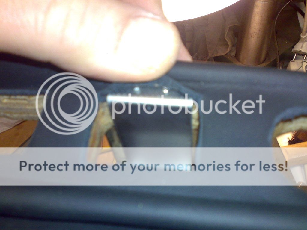

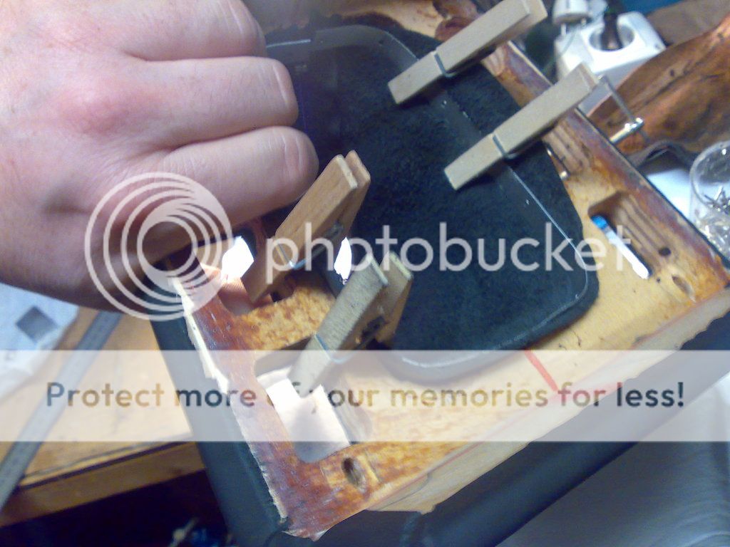

material is leather of the best quality, thus pretty thick, i used impact glue, is impossible to take pictures of the process or the work will be ruined
using a nylon and small wood sticks to define shapes and sharp contours

a rough estimate, i would say...
100 euro the console core w/shipping
1/2 hour to dissasemble
2 hours to repair the wood
1/2 hour to cut the leather and sew the boot
1/2 hour to sand finish the aluminium trims
30 eur to chrome/ anodize the metal parts
5 eur the decal
1,5 hours to glue the leather
1 hour to finish assemble
135 euro plus 6 hours @60 eur (360) = 495 eur
