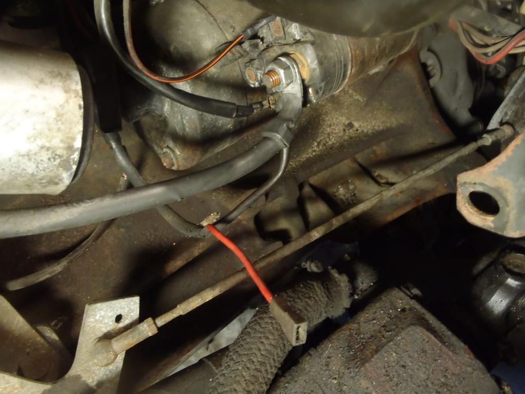

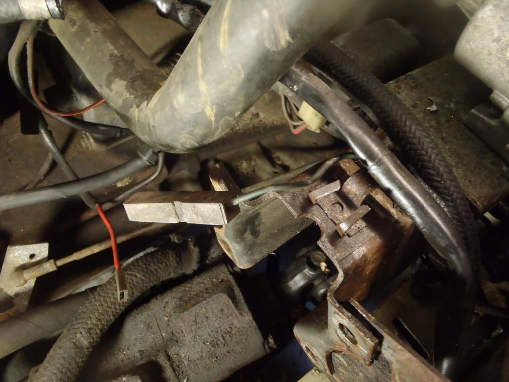

Any idea what these two are for? The green one with the big boxy connector is directly on top of the bracket that holds the brake servo (the red one's in the background in this shot). The red one is paired up with the ground that goes to the starter ground. Neither are connected to anything and nothing is nearby to connect them to.

That red wire is not connected to starter ground but to starter positive and is there to power the main relay pin 30 for the csi model
Check the schematic key for item # 162

Yes, the red cable should be connected to the starter were the black cable sits. The black cable should instead be connected to a socket with two cables on the other side (red and white) from the same cable tray as the red cable mentioned first.

Looking at the second picture, the red wire doesn't have anything to connect to but it is shown in the wiring diagram connecting to the starter. And the red/black wire shows up in the wiring diagram as in the picuture.
The strange thing is I haven't touched anything and it all starts and works just fine!
I'll check the wiring diagram further tonight per sfdon suggestions.
No ideas on the green wire?

For whatever its worth attached are pics of my starter. Not sure if the wire connected to the started has a red and black interconnected under the sheathing (I pulling it back a little but saw no red). The are 2 of the box type connectors similar to your green one just behind the brake booster that I assume are from the old fuel injection system. What I do know is I better start cleaning and detailing my engine!

Bwana - I came across this thread as I like you have this red wire and green wire with box connector unconnected - when i look at the wiring diagram it seems the green wire is for an electric choke so is not needed on an FI car. On my wiring diagram it shows only black coloured wires and the black/red wire to the coil. Anyone know where this red wire is supposed to go? It is in the loom with the oil pressure sensor and temp sensor on the aux air valve.

The red wire goes from main relay to starter exactly as the schematic shows. That's an eyelet connector with black shield over a red wire going to main relay
