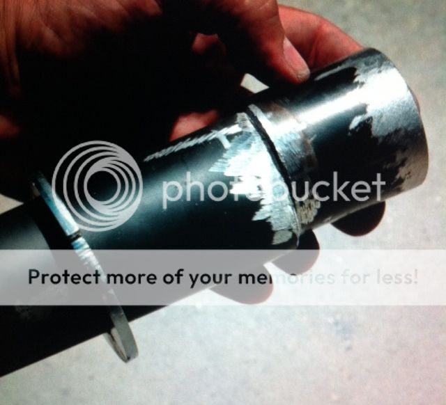

Has anyone converted the original front struts to coilovers themselves?
I have seen & am enquiring about the coilover kit, threaded sleeves available from.
www.rallydesign.co.uk
www.iemotorsport.com
I have seen these fitted using rubber o-rings to centre over the strut, or welded on the lower end of the threaded sleeve only. I would prefer if these sleeves could be welded top & bottom and still allow the locking rings to be wound all the way off/on.
Im after a bit of advice re, the positioning of the sleeve, and if the strut should be shortened any?
Please share your experience.
Chris
Iv got access to all the kit required to fabricate, just need to know what to buy and where to cut/weld....

Spoke with IEMOTORSPORT.
Im told, shortening the strut housing is entirely optional. This is done to preserve suspension travel on cars which will be lowered aggressively (~2" or more), and does require special, shorter strut inserts. There are also ramifications in regard to wheel and tire size and the clearance between tire sidewall and strut housing. I was advised that unless planning on running a radically low ride height, it is much easier and more cost-effective to stay with a stock-length housing. *E9's are fairly long-travel, so with reasonable ride height there's not a big problem with travel.
They weld-on the collar at 3" from the top of the strut housing. The threaded coil sleeve is also 3", so it is flush with the top of the housing. A longer threaded sleeve cannot be used or placing the perch lower except in very specific circumstances, as there is usually insufficient clearance between the tire sidewall and strut to permit the hardware to mount any lower.
The 3" placement keeps the adjuster hardware just above the shoulder of the tire at its lowest adjustment.
