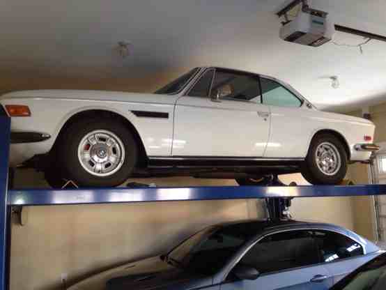

I have a 22 by 28 foot garage with 11 1/2 ft ceilings. I store the coupe and m3 interchangeably without issue. I went with the 4 post bendpak in the narrow version. The other consideration is the width of the garage door or doors relative to the ramp of the lift. I have a 90 degree turn into the garage which is the only thing that takes a little time. A few mirrors from uline mounted to magnets and stuck on the lift make it very easy.

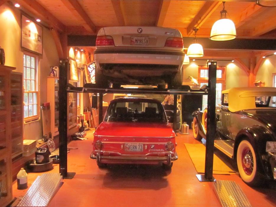

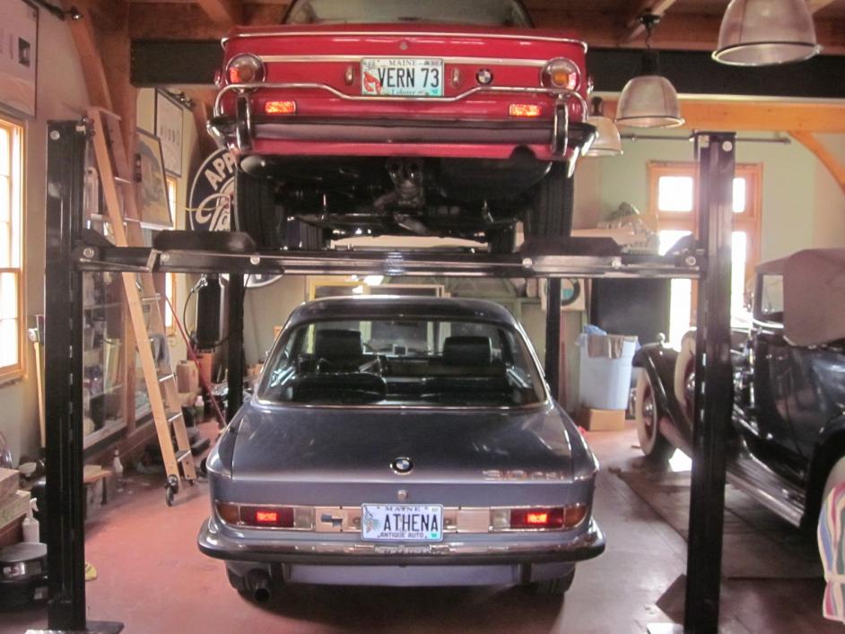

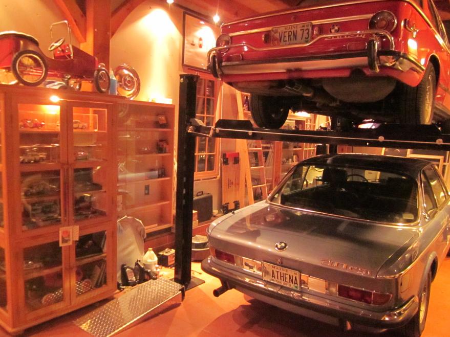

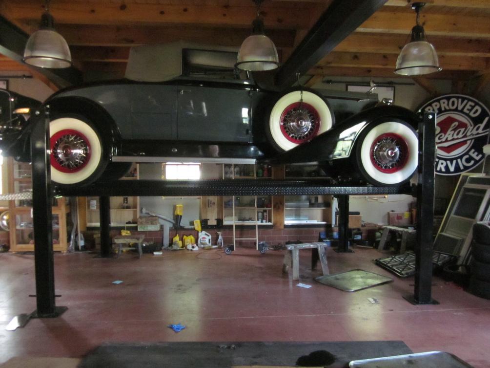

I've been pretty happy with my 4 post lift. Bought it when I bought Athena. I have 11' 6" ceiling height. Enough height to stack Vern and Athena with 6" to spare. Also purchased the mid-rise pneumatic jack. Can even lift a 5600 lbs. '33 Packard Twelve.
