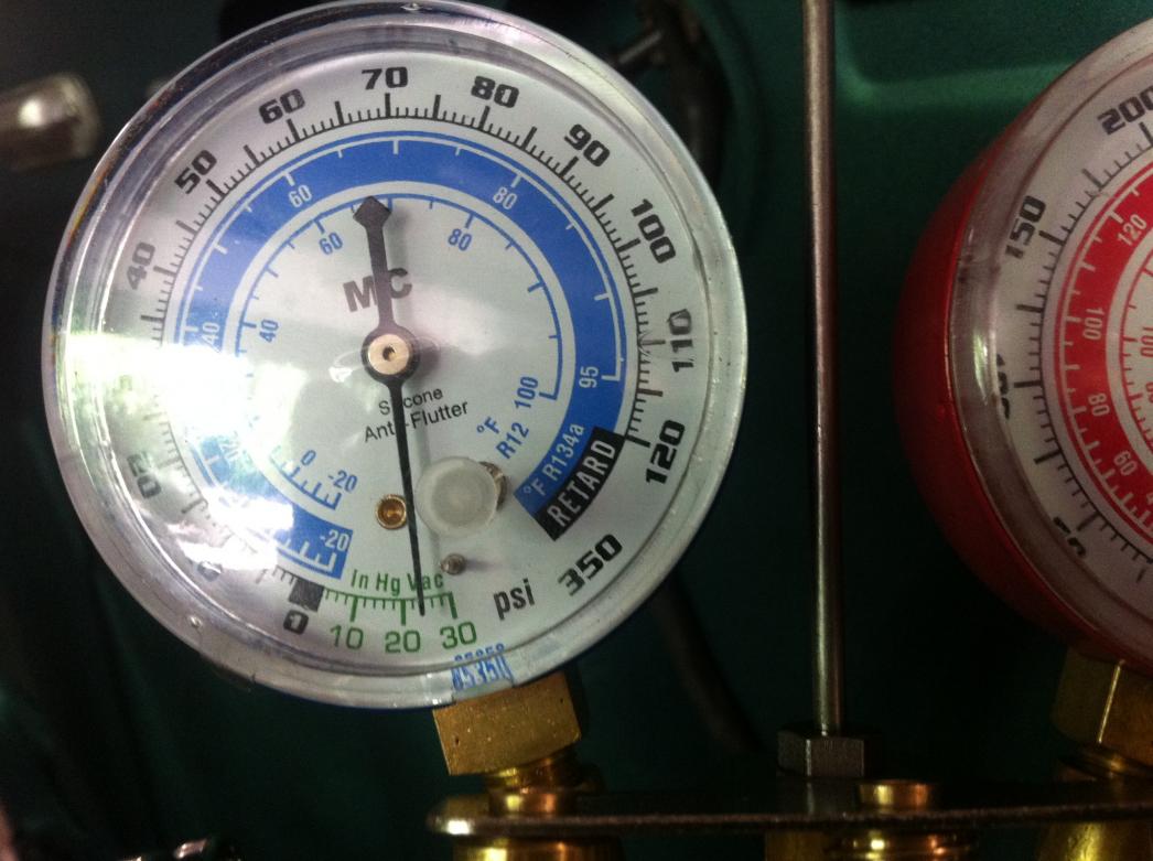

Here is what I did so far. Borrowed an AC vacuum pump from Autozone. Since the system I have is R12, I had to buy an adaptor kit so the gauges would fit on the low & high side fittings on the AC compressor. While the low side adaptor had a shrader valve, the high side adaptor did not. The pin on the red hose (high side) was not long enough to push in the shrader valve that is inbedded in the high side connection on the AC compressor. Hope this makes sense.
I assume there is a schrader valve inside the low side of the compressor. Is this correct? If so, I have to further assume that the schrader valve of the R12 to R134 adaptor pushes in the schrader valve of the low side fitting on the compressor when I screw in that adaptor.
The result is that I could only use the blue hose for the low side and perform a vacuum test. I'm not sure what the low side would do and hopefully is not critical in trying to find out if the AC is in working order for me to fill it up with R12. Once the low side connection from the pump was done, turned the pump on and everything seemed to go well. Then noticed oil coming out of the pump and stopped the evacuation.
It turns out that the gauge connection to the low side of the AC compressor was not secured properly. The oil was coming out of the vacuum pump. My knuckles and arms are bloodied and black & blue from reaching the low side fitting of the compressor. I had to reach from under the manifold.
Thinking the pump was faulty I got another one from Autozone. Once I made sure the connection of the gauge to the low side fitting of the compressor was correct, (again, the low side only) I turned on the pump and left it on for close to two hours. The reading on the gauge was about 26 inch per Merc. I could not get it to 28 and certainly not to 30. After a couple of hours, I shut the valve at the gauge for the low side and let it sit for over an hour. The needle stayed at 26 inch per Merc and did not move one millimeter.
I performed this procedure several times with the same results. The last time I let it sit overnight and the needle on the gauge still did not move. It was at 26 inch per Merc every time time. Only when I reopened the valve on the gauge did the reading jump to zero.
From this test I came to the conclusion that there is no leak in the compressor, the hoses, connections or anywhere else. Am I correct in this assessment?
My next step in to charge the system with R12. I have three cans. One contains R12, oil, leak detector and leak sealer. The other two cans are straight R12. Any comments or opinions?

Vacuum it one more time, turn off the gauges, hook up the can of freon to the center hose, let a little bleed out to clear the hose, and fill it up. I'd use the 2 regular cans first then if you need more go to the leak can, dont put that stuff in unless you need it. Or find a 3rd can of straight r12
