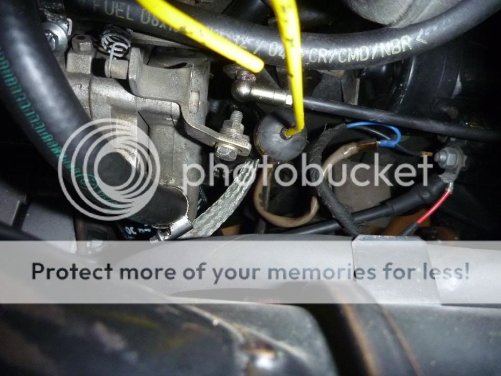

The relay is triggered by the wire that was previously connected to the solenoid. The power wire on the kit (Red) connects where the positive battery terminal connects on the starter.
If you look at the picture of the kit. Blue wire is the relay trigger. Red is power. Yellow is ground. Black is relayed power and connects to the solenoid switch.
I bundled it up and here's what it looks like on my tii:

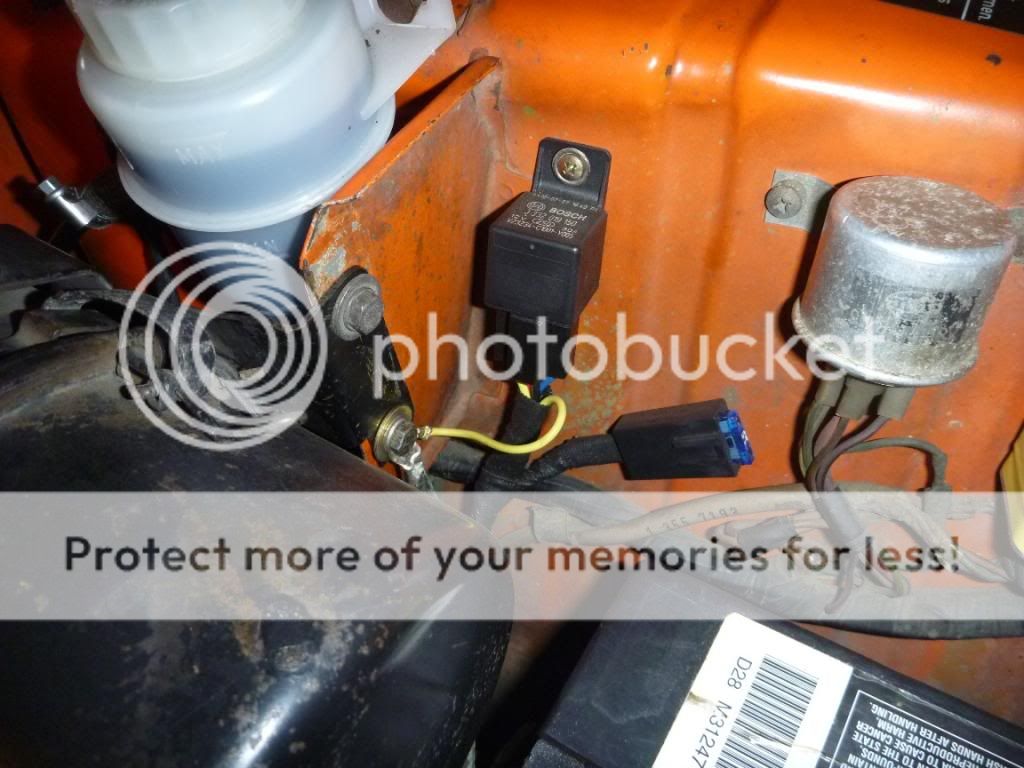

I bought the Bosch kit for $28 off eBay and put it on today. Very easy to install with supplied wiring diagram and no wires need to be cut, thay either fit together with spades to the solenoid and ignition wire or bolted on the starter for voltage source or block for ground.
I had a vintage Hella can relay with mounting bracket lying around so I used it instead of the supplied relay, this requires relocating the pins in the socket to comform to the old style layout but it's easy to do.
Works flawlessly. So does it make a difference? It sounds livelier when cranking but if this is wishful thinking on my part at least I don't have that amperage going through the old ignition switch wires anymore.
I mounted the relay to the PS bracket:

Upon further review, starter is definitely quicker with more life and the engine starts in less time.

steve? whats that purple/blue item
Down low in the pic?
