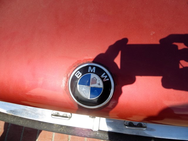

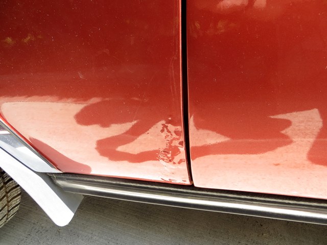

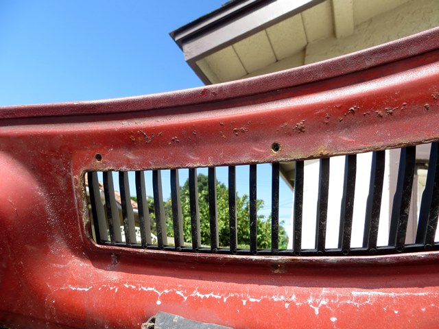

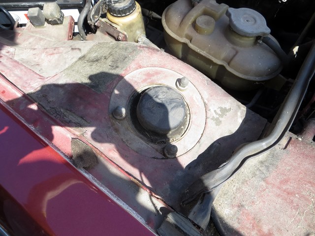

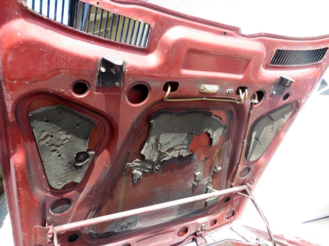

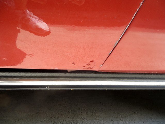

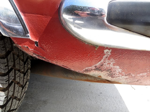

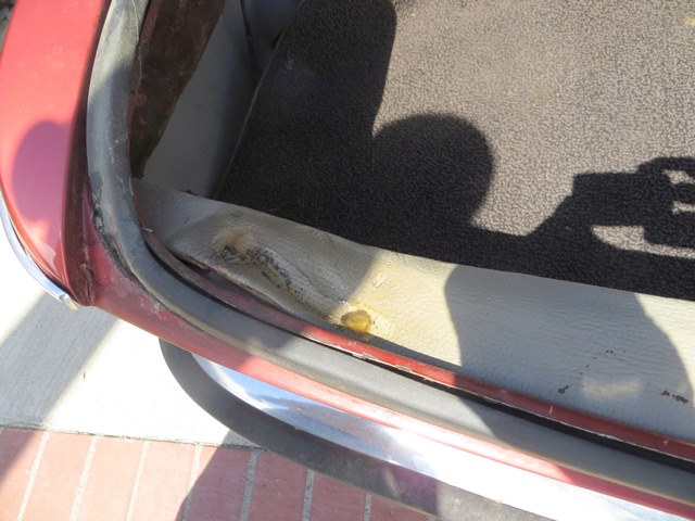

It's a CS, not CSi, sorry. Same seller of the rusty blue CSi in January so well known here. This one is red and I inspected it in September in Anaheim, asking $25K at that time, sold for less than $20K, worth about $15K. Buyer beware, serious fender rust and seller has no pics of engine or fenders and he wants $49K.

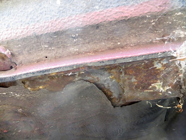

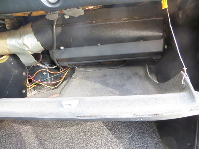

Check out pic number 80, the rest of the coupe has similar issues. It has sat outside for some time, the trunk was wet and moldy, no sunroof seal, etc. I felt sorry for the seller at the time, he owned it 25 years or so. Rust in quarter panels and bottom corners of doors, funky aftermarket AC with weird plumbing under dash, paint is 20 years old. I will look for my photos to add.

I don't know why I didn't check here first... just beware of this seller as his version of rust free is significantly different than mine, and maybe yours too...

there is some bubbling very minimal. No major rust. please feel free to come and inspect it if you wish. but overall very very minimal bubbling of rust. under the car is rust free and also on the shock towers is rust free witch is the most important part.

Check out the pictures on e9coupe.com. They purport to show rust on the hood, deck lid, quarter panels, doors, fenders, and body at the front and around the trunk. Are these pictures of this car?
Dear johnbobincheck,
no thats not my car! please check at tye bottom of my description page for a link to shutter fly link for more photos. the re is some very small bubbling in some areas but no rust on the shock towers and no rust on tue bottom of the car. yiu are welcome to come and inspet it in persom. Thanks for your interest.
Dear googoutgoogout,
These are definitely this car.

The rust visible in these photos drops the value of this car significantly and demonstrates clearly that the "no rust" in the headline is far from the actual condition of the vehicle. Please cancel my bid immediately or I will need to go through the bid retraction process and report this to Ebay.

Thanks for the PM, glad I posted those photos. This coupe led a tough life, the eBay seller added a new interior but that's all, it is pretty rusty for sure.

This car is very rusty, I took photos of it in September when it was first offered for sale in Anaheim, I have the VIN to prove it. It's not as bad as the blue coupe you sold with the paint can lid screwed to bottom of drivers floor. The fender seam rust is only the tip of the iceberg. See the discussion here, http://www.e9coupe.com/forum/showthread.php?t=15872, we don't want the next owner to be taken advantage of, be honest and show closeups of the rust.
