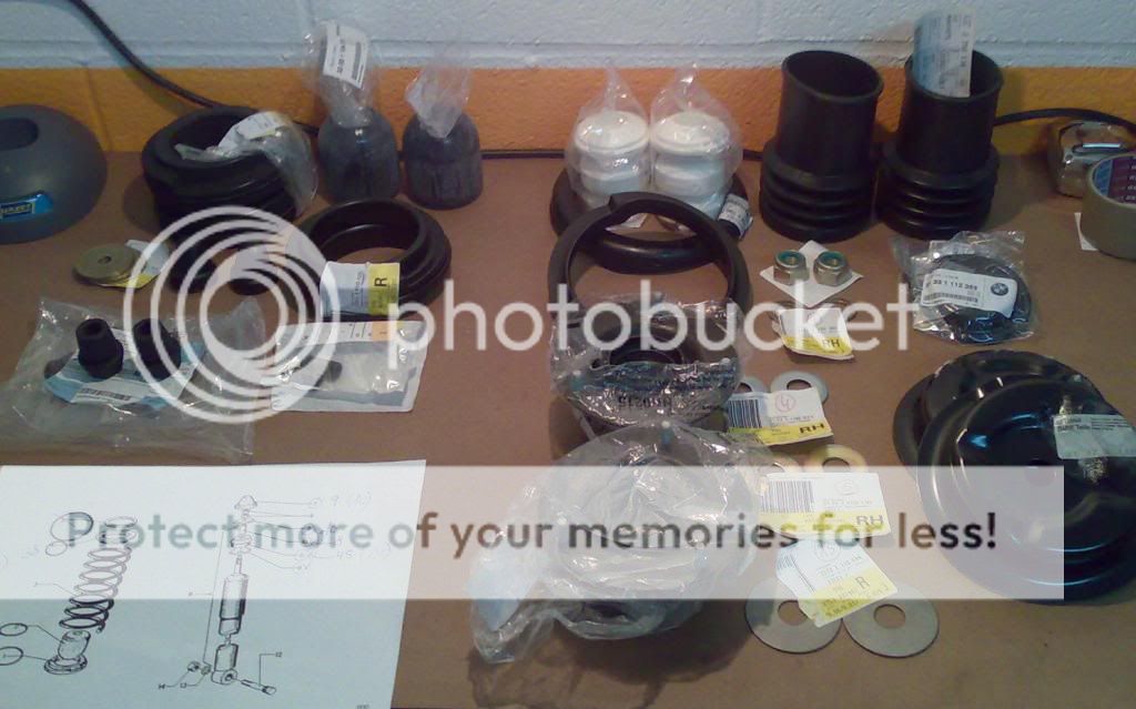

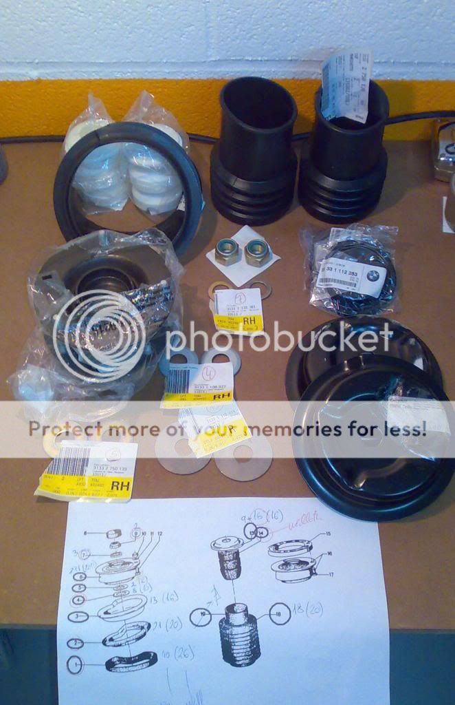

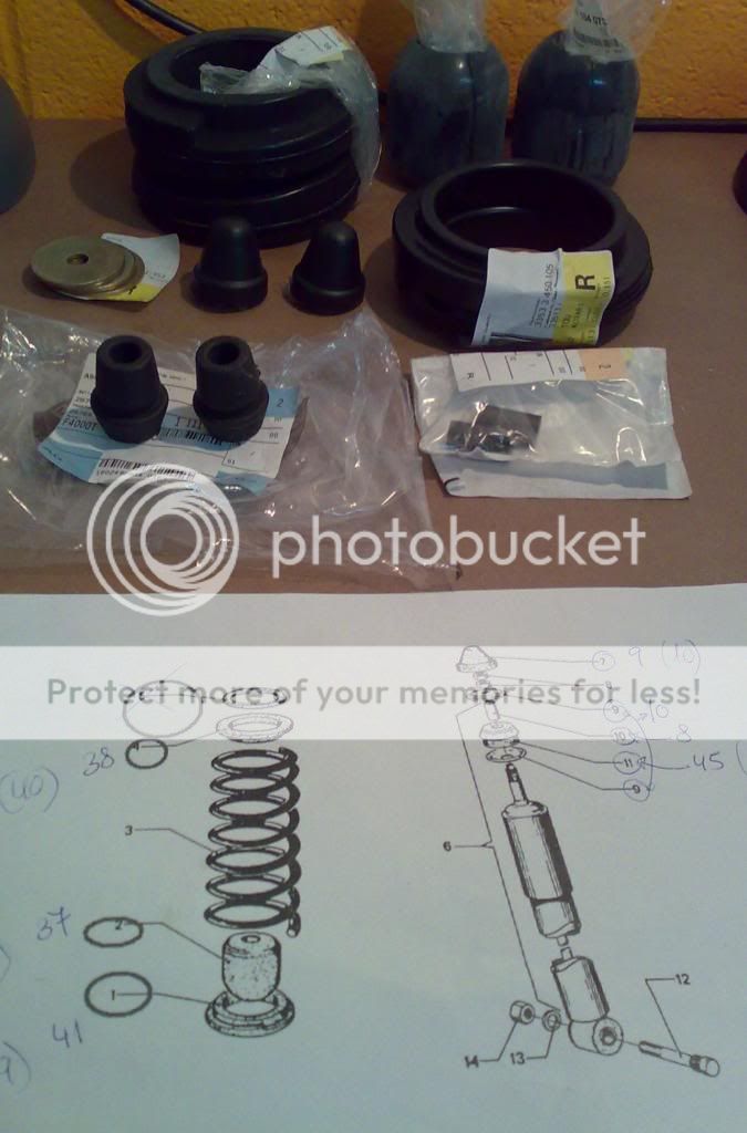

i am preparing myself for this task, first thing it has been getting a set of Carl Nelson springs from Gary, thanks Gary !
then i got all the rubbers and bits from BMW dealer, i made a comparison with Walloth&Nesch, and it was only 10 euro less, in addition that noone knows were the parts from W&N come from (usually the same source than BMW but lost of them are reproductions made in india of the worst possible quality)
rear
front

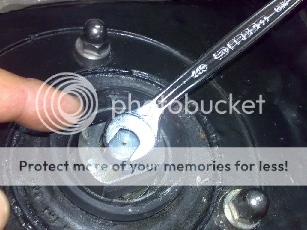

the question that i am facing is how to remove the front shock tower nut, it is something that i will do later, when the whole tower is out from the car, but i am trying to get myself prepared for it
the setup seems to be a little odd, it has the standard springs and bilsteins B6 right now:
the nut is M18, that needs a 27mm tool, but it needs to be undone while blocking the inside shock rod, no way:
i need to have access to the inner part through the 27mm hexagonal vase: i cut a vase and made two parallel faces to hold it with another tool, but it is so profound that i can not hold it
it is not a good way, i am figuring out another way, but, anyone knows how to solve this ?

good, the external hex is ok, but what do you use for the odd shape of the shock rod ? in my case it is 11mm on the two paralell faces, and diameter 15 on the rod
