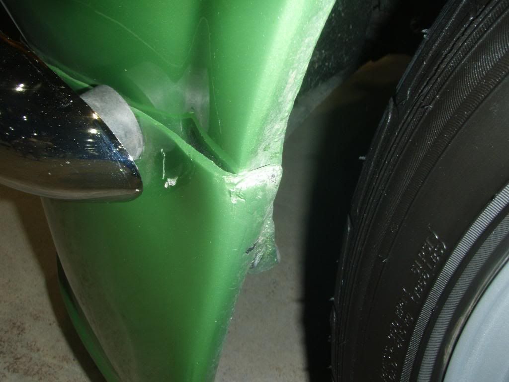

OK, job done. I ended up cutting off the tabs on the spoiler that stick ino the fender area

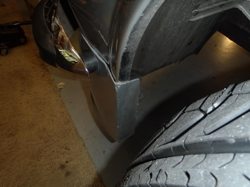

This is the left side, untouched area
Was I supposed to cut these tabs off when I installed it? One of the guys here in town has a '74 with a spoiler and his doesn't have the tabs
Is there a "correct" installation or is it whatever works?
