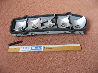

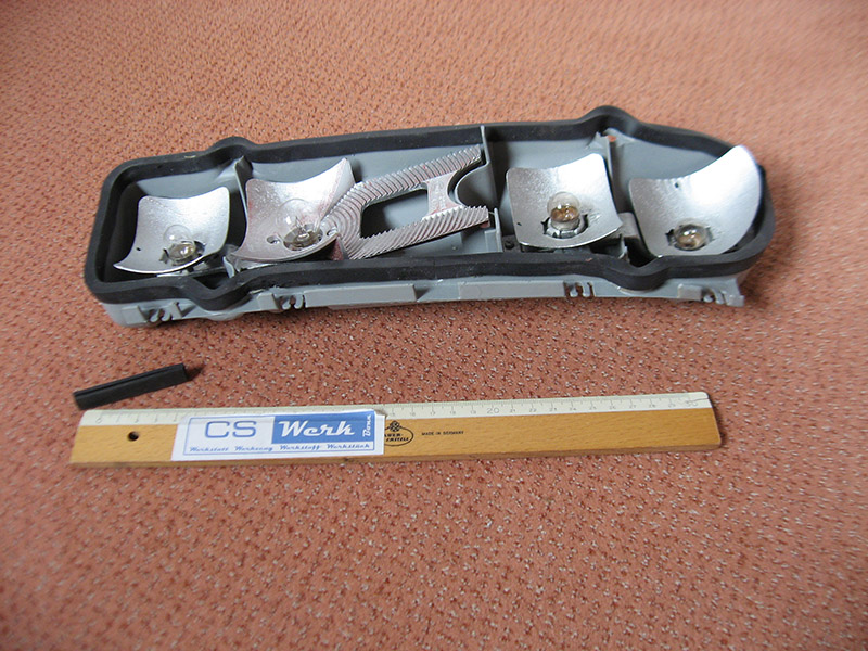

For tail light buckets, I used industrial U-Channel Grey EPDM part #3071 from Wefco see-
http://www.wefcorubber.com/extrusions_industrial_uchannles_allcorners.asp
These guys make it on demand via a weekly production run.
Looks the same, but is relatively stiff (Not a foam). Dimensions are nominal (not exact). I had to tack it on with fast cure cyanoacrylate to get it to stay put around the corners and turns.
I bought enough to do 2-1/2 sets at $47 total including set up and freight. If a large production run was executed, the cost could come down perhaps justifying a group purchase. If someone wants to part with $20 pay pal, I'll stuff enough to do a set in an envelope and send it off. Pics below.

the gasket for the lamp housing looks reasonably good. Ed, did you try heating it to make it bend easier?
Two different gaskets

Ed - Did you consider this channel profile in the softer neoprene material? I may be interested in your scrap piece.
i was under the impression the original post was about the outer gasket between the body and the lens. was i mistaken?
1. Point taken, you're not mistaken, just a little bit of ADD on my part. I thought I'd share info on the other gasket to save anyone else some time on what I found to be NLA.
2. The u channel was easy to bend but it's relative stiffness and memory wouldn't allow it to stay put. You can easily bend it into place, but will slide off when you let go. Some super glue at some strategic points fixed that fine. I spent a lot of time looking for a sponge rubber product including typical home weatherstripping, but couldn't find anything close.
