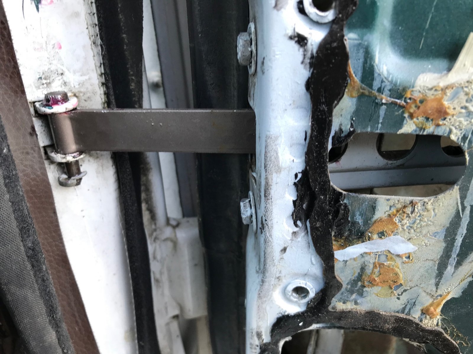

I have finally installed a new MB door brake in the coupe and it fits perfectly. They are available from $20-$35 on eBay. My passenger door had the later BMW replacement and is longer (90mm), too long according to some opinions, vs. the MB (85mm). I hate removing the armrest because it is always a pain to align the screws when reinstalling but I bit the bullet.
You need to reuse the bushing inside your current brake and I elected to use a 4mm bolt instead of the pin, which is available new, because they are hard to get in place and even harder to remove. See photos below.

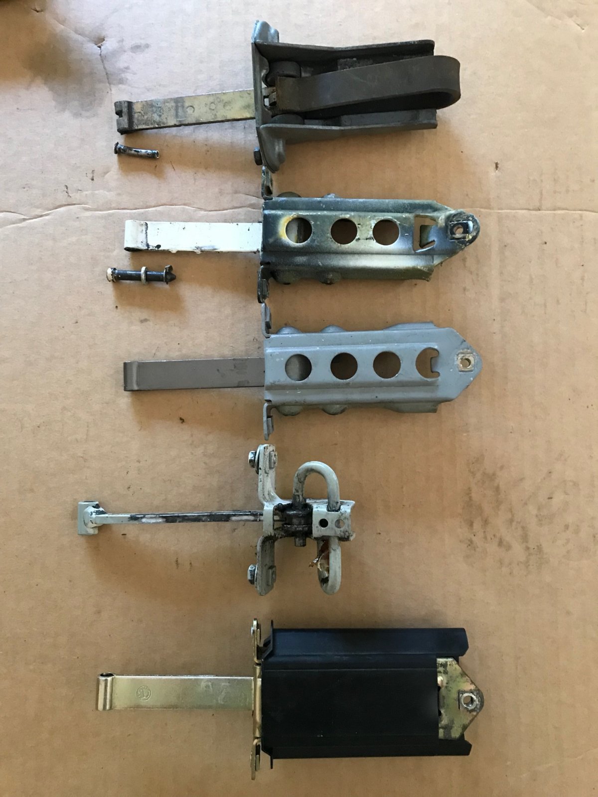

My passenger side door brake is broken as well. I went to P-n-P and grabbed a few MBZ door brakes. In the picture, the broken E3 brake is on top, followed by a W124 brake, a W201 brake, and E28 brake, and a W201 brake with a nice cover.
The difference between the W124 and W201 is the rear mounting hole. It's canted a little on the W124 brake.
The MBZ pins are 6.25mm and come with a clip on the end. My bent E3 pin is 5mm with no clip.
Looks like I'm going to bore the E3 mounting hole out to 6.25mm - roughly 1/4"
The MBZ door brake worked so well that I changed out my driver's side as well. It's a 2-position door brake so you can have your door halfway open or all the way open.
The MB brake works great. But it is all about the pin or bolt that you use/reuse to secure the arm to the door. Nice to have something new and not worn out, to eliminate any slop in the operation of the mechanism.
I’m assuming there’s no readily available replacement for the bushing in the door brake for the pin? Have an E12 here that appears to have gotten a fresh MB door brake. So little meat on the brackets on the car I’m afraid to drill those holes out.
