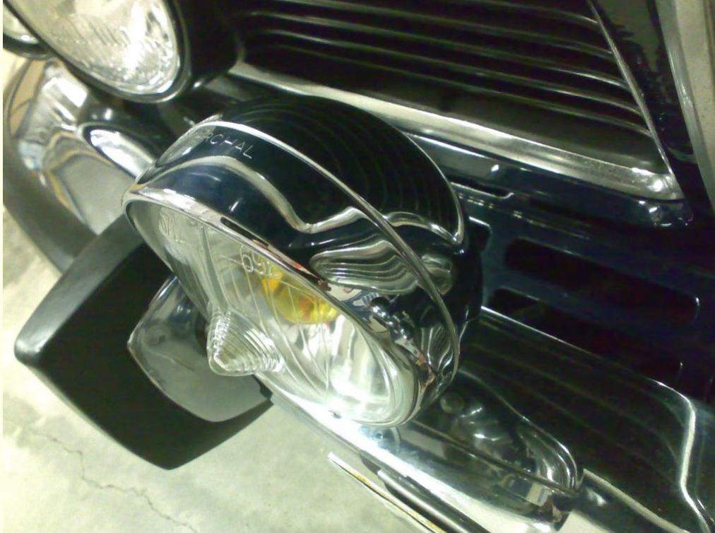

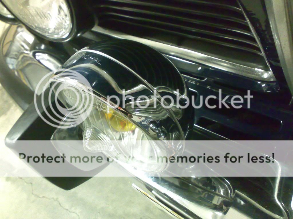

no visor:
with visor:
and, i went for the "with visor" ones, apparently available, but in fact "sold-but-not-paid"...etc,

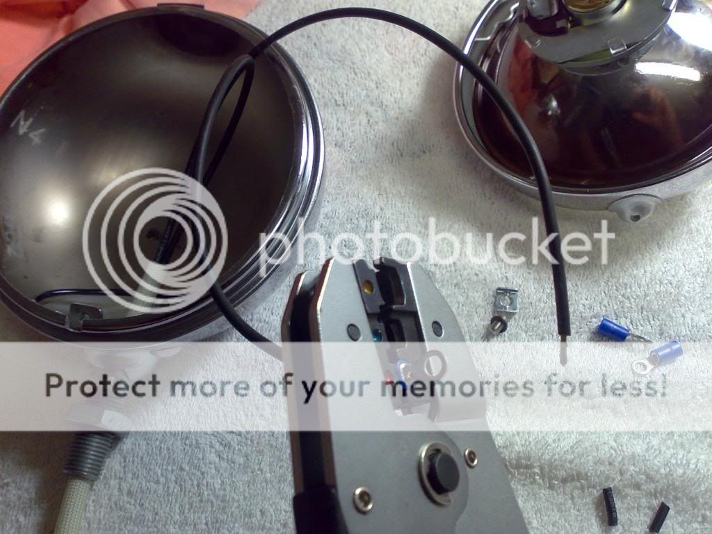

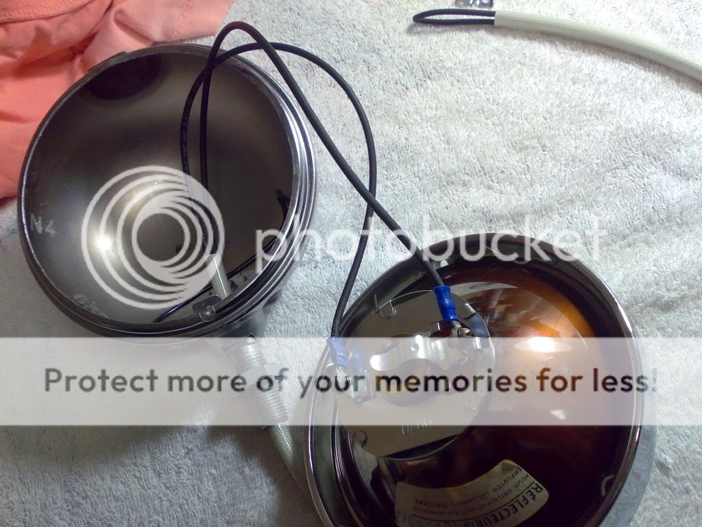

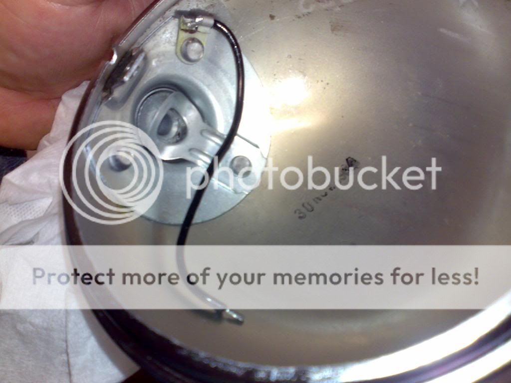

electric conections of the lamps
a pretty simple thing, but to use the correct materials makes a difference..

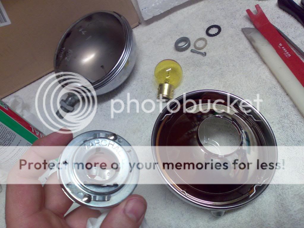

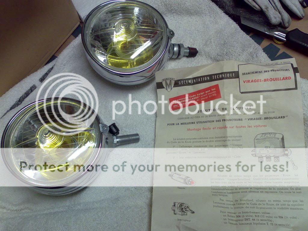

arrived:
30 nov 1964

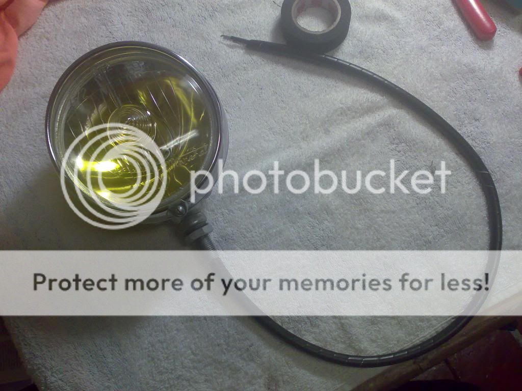

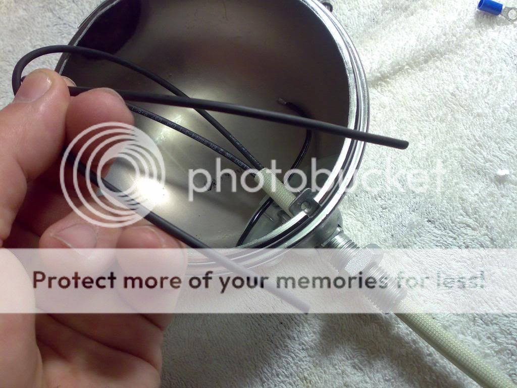

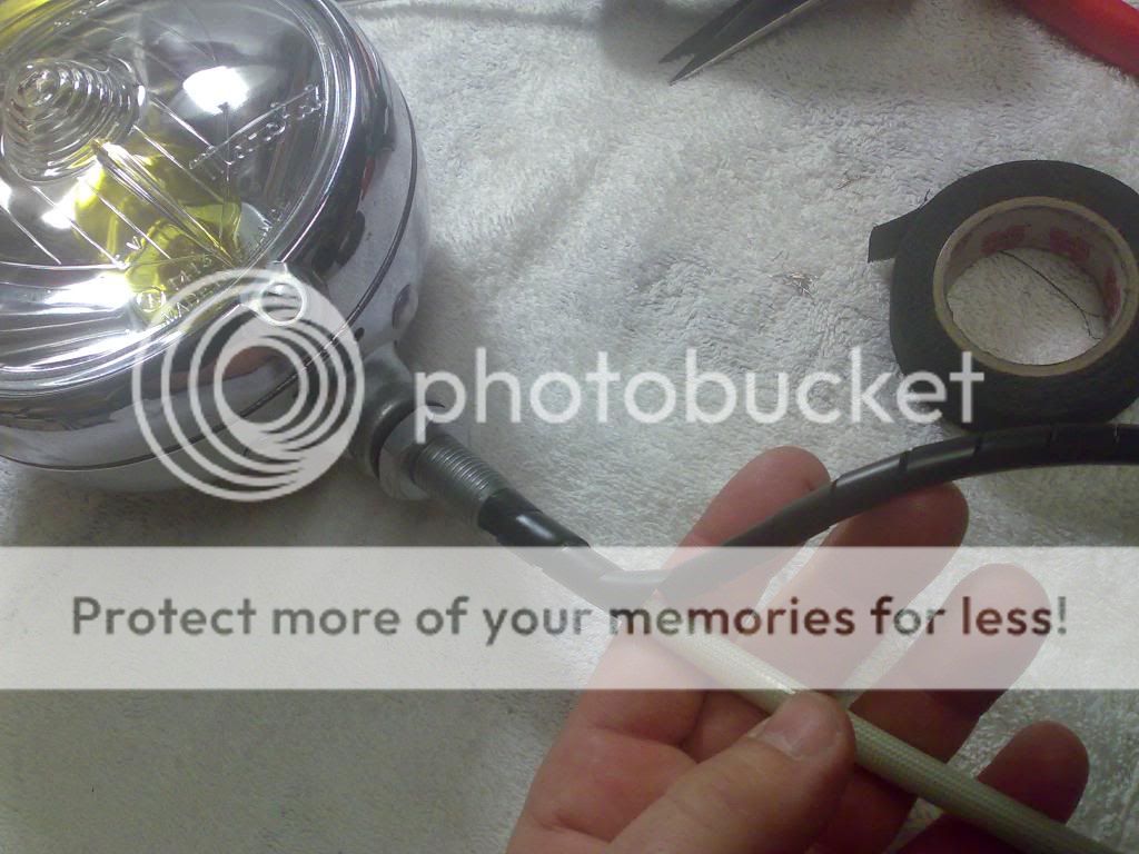

using glass fiber protection:

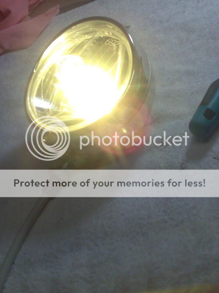

45watt, alot of light
flexible cover:

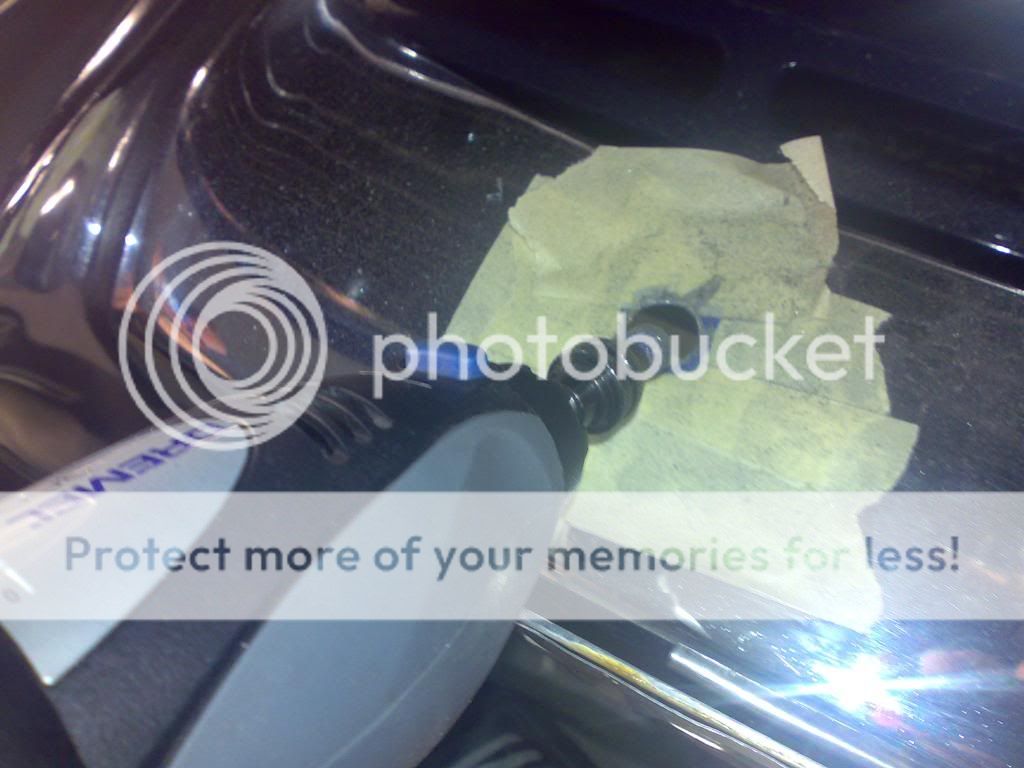

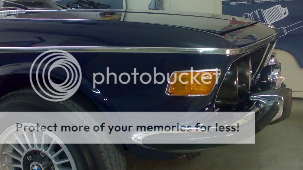

enlarge the hole in the bumper:

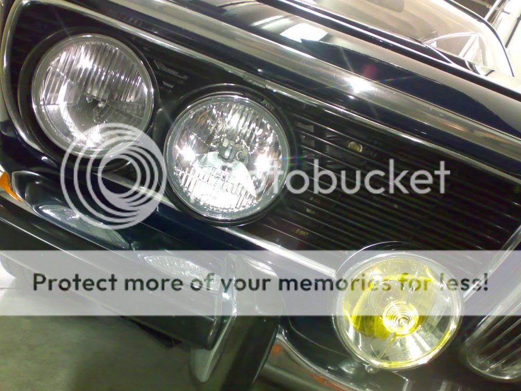

photos:
I like them too. Did you put a rubber washer between the bumper and the light?
Yellow headlights, a hole in the bumper, a light with nipples, will madness ever stop :)
Nylon is probably a good choice. Now that I think about it, the Nipples on your High Beams are quite prominent (As Arde pointed out).

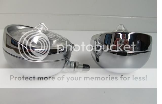

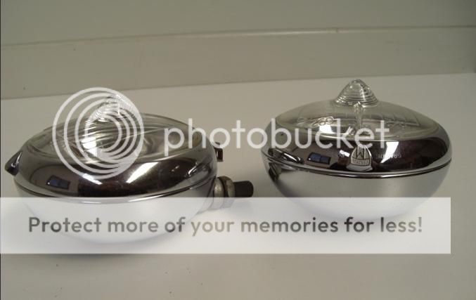

i have a question that someone might be able to answer,
the nipples ! yes, how sexy, beautiful, ....and how expensive to build in a glass...
so, they must have a purpose, the question is what are they for ?
my opinion is that they might be there to know that the light is on when you look at it by the side, but then again: what for ?

I think you are over thinking it. They're French, they take their design inspiration from the Primal side. Arde had it the first time.
Besides the previous sexual explanations which are certainly plausible, the real reason is to keep oncoming cars from being blinded by the direct light from the bulb.

Some American cars in the Fifties had bumperettes shaped like, well, a female protuberance (called Dagmars, I believe, after some actress?) Now we have nipples on headlights?
i can not discuss it, but it does not seem very plausible to me, your lights do not have the "nipples", and then...are you a "light killer" ? ;-)
