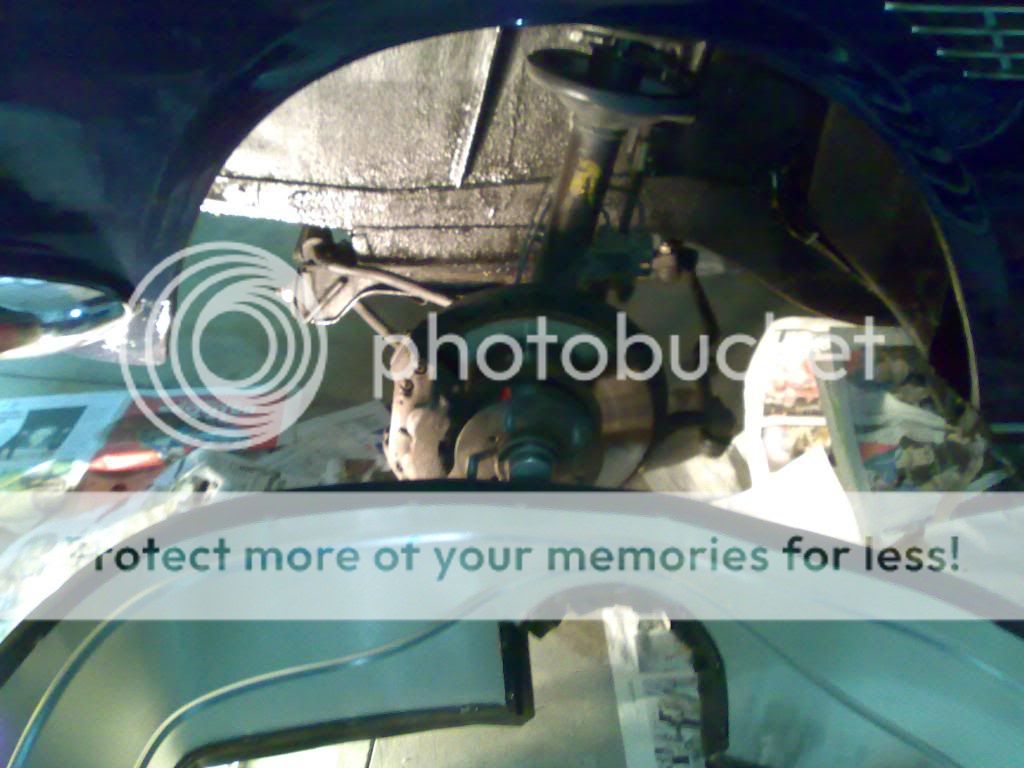

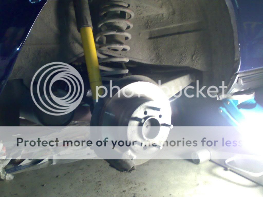

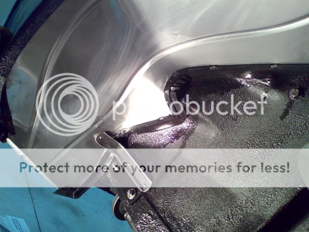

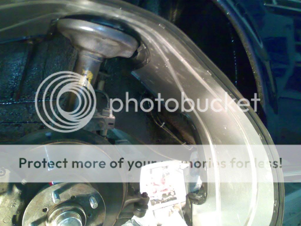

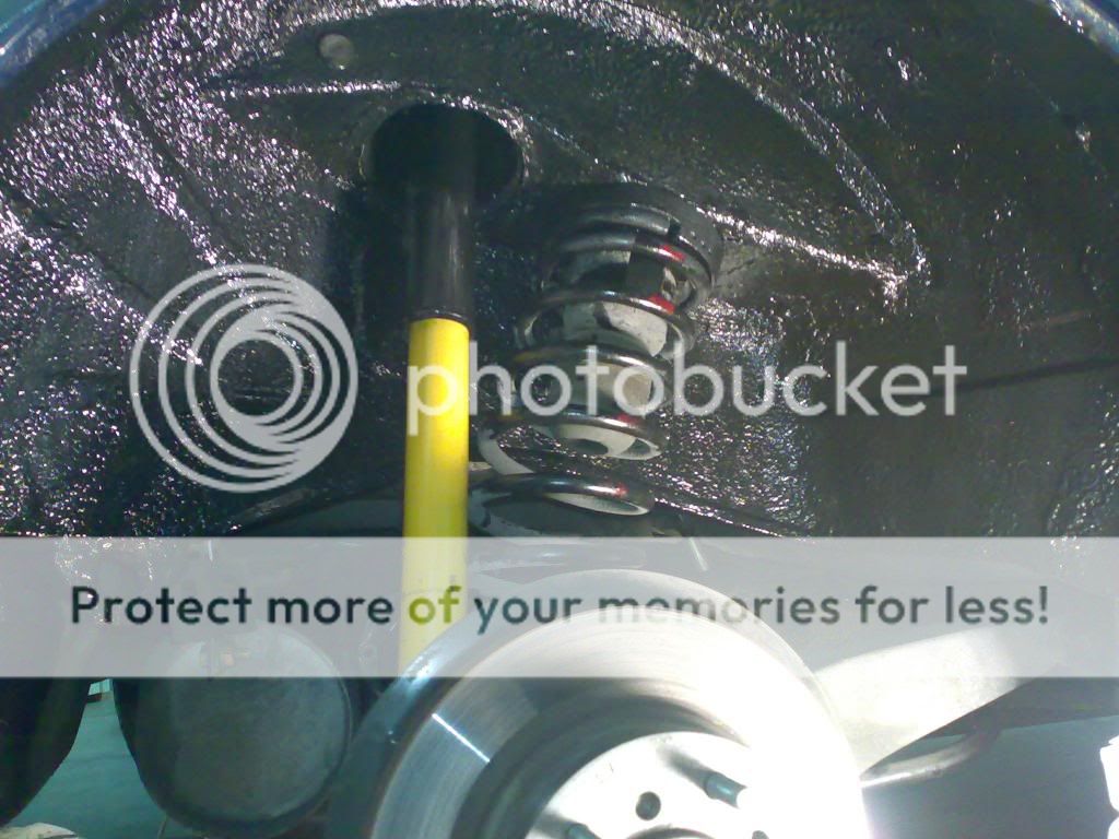

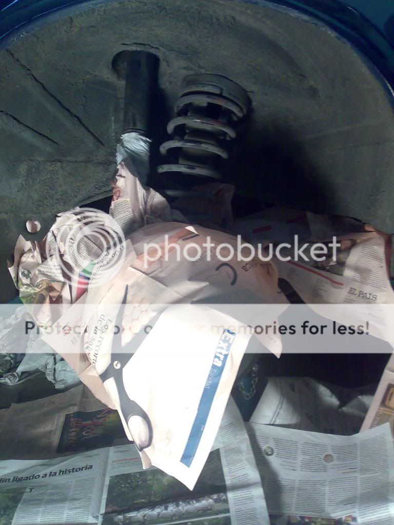

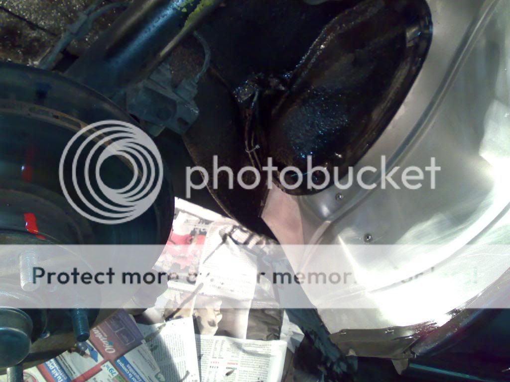

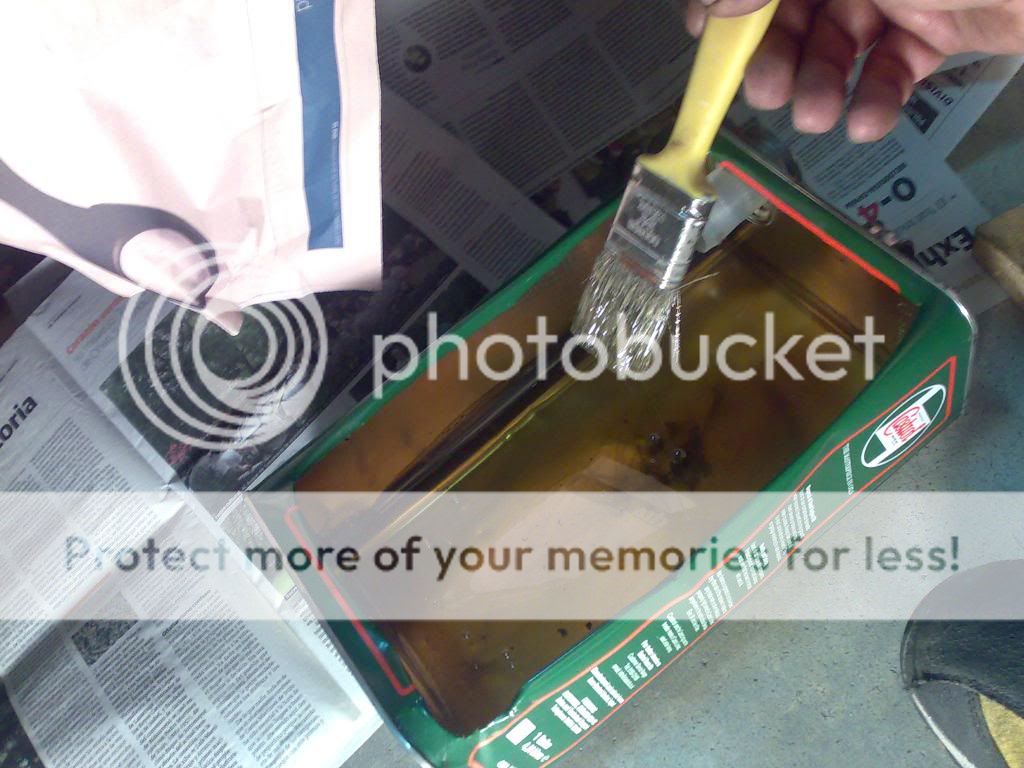

first preparation of the surface, using a peculiar product:
Esta imagen ha sido redimensionada. Haz click aquí para ver la imagen completa. El tamaño original es 1024x768 tamaño 101KB.

Great photo spread as Usual. Those fender liners look almost structural. Fluid Film is sold locally in a spray can. Great stuff.

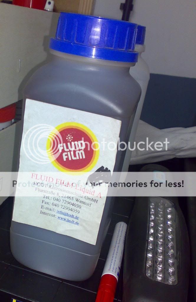

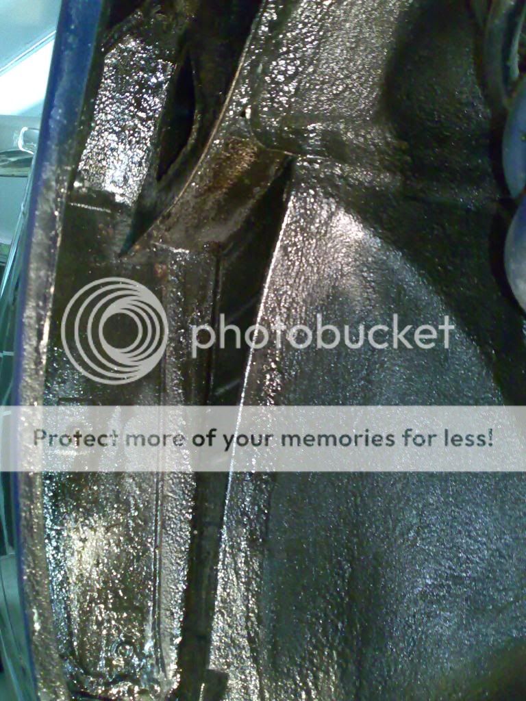

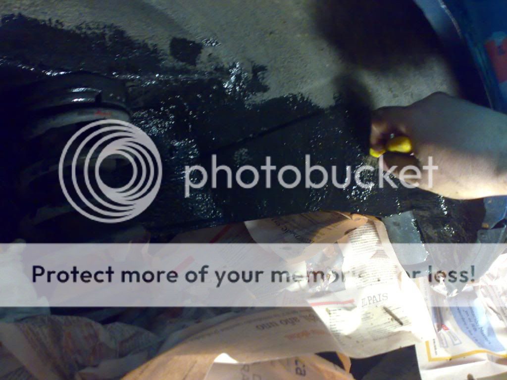

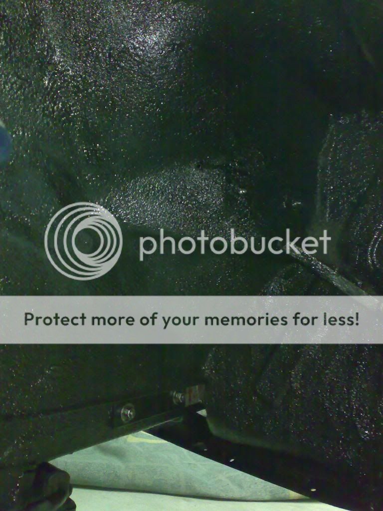

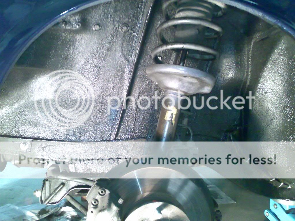

thanks,
FLUID FILM, and PERMA FILM, are really great, only need to blow away dust prior to application, they cover evenly the surfaces, and sit there preventing air or moisture getting in contact with car body
here we can find 5liter cans at reasonable price, and just spay it over all underbody and fenders
the people of LOKARI told me about it.when i visited them in munich. nice guys, they repair, and renew mercedes ponton cars

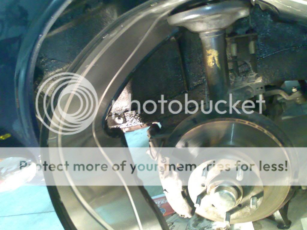

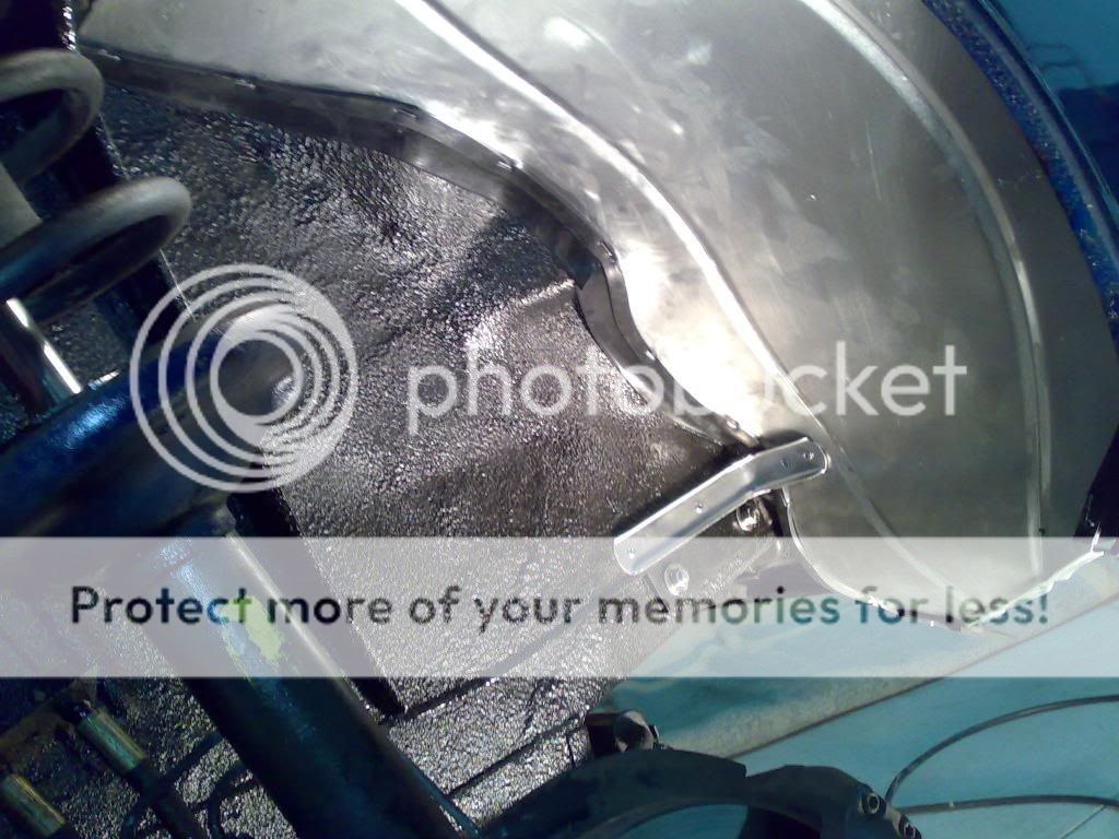

Nicely done! About the same as mine although I didn't do the sheet metal spray. I did, however, spray the insides of the fenders so it hopefully will slow down the rust from the inside out.
I didn't realize Lokari sold liners for the rear. Are they worth it? Are there rust issues in the rear?

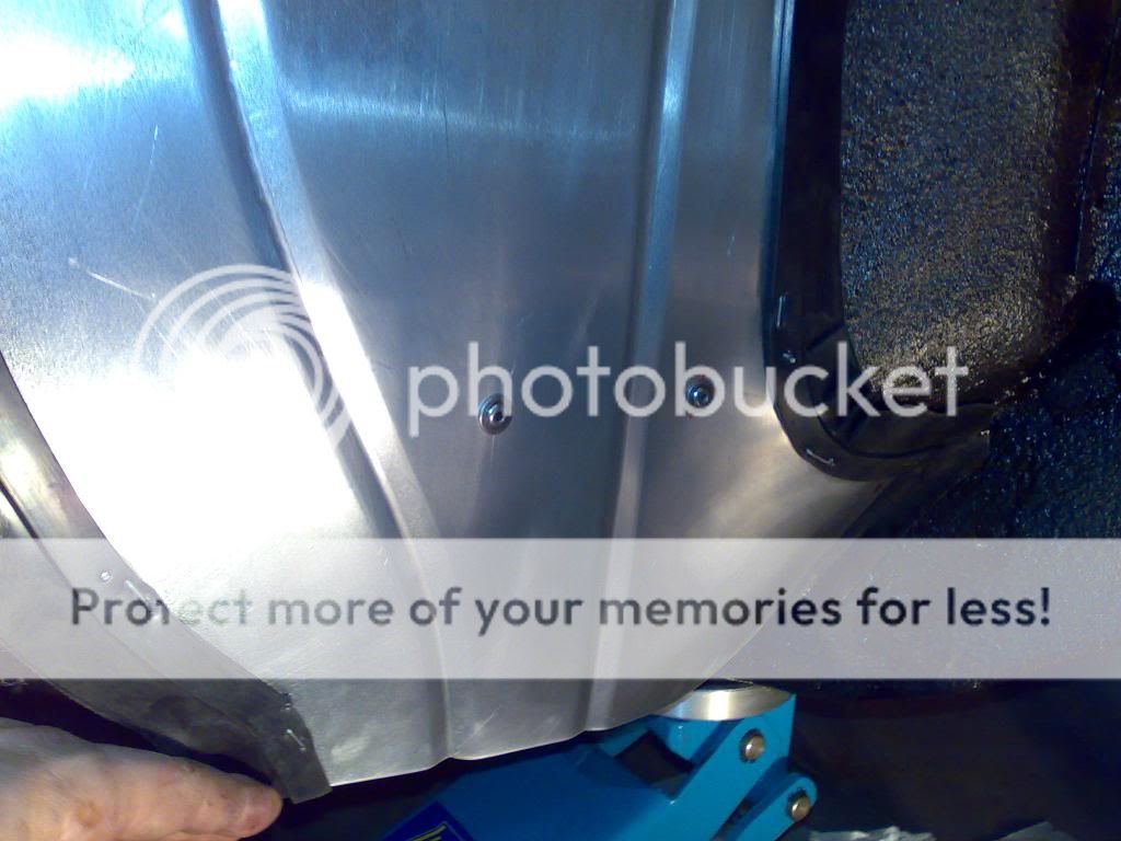

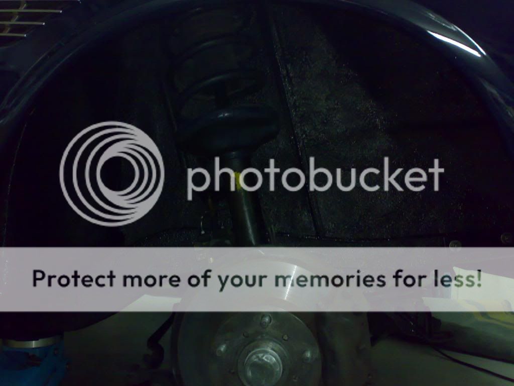

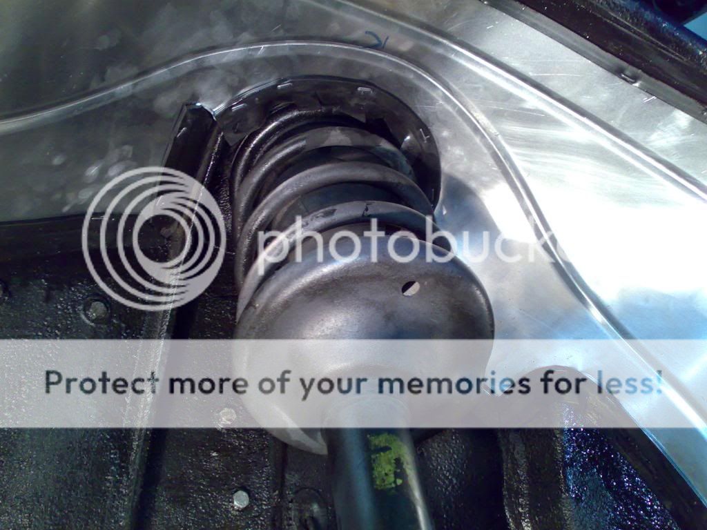

hi, rear liners?, no, they do not sell rear liners, probably my thread is a little bit confusing at this point, i prepared the rear side with the same anti-rust product, but there were no liners to install there ! you can see that there are no hidden cavities in the rear area, so that is the reason for not need of liners there, any way it is worth to spray some LIQUID FILM there
next week i will receive a big order of LIQUID FILM, and PERMAFILM form germany, and i will finish all the underbody
i will use a pistol and air compressor

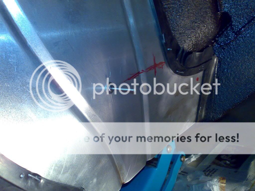

i will also (as the lokari instructions state) open two holes in the liners to be able to spray product into the cavity formed by the inner fenders and the lokaris
i only need to find a suitable cap to close those holes afterwards
regards

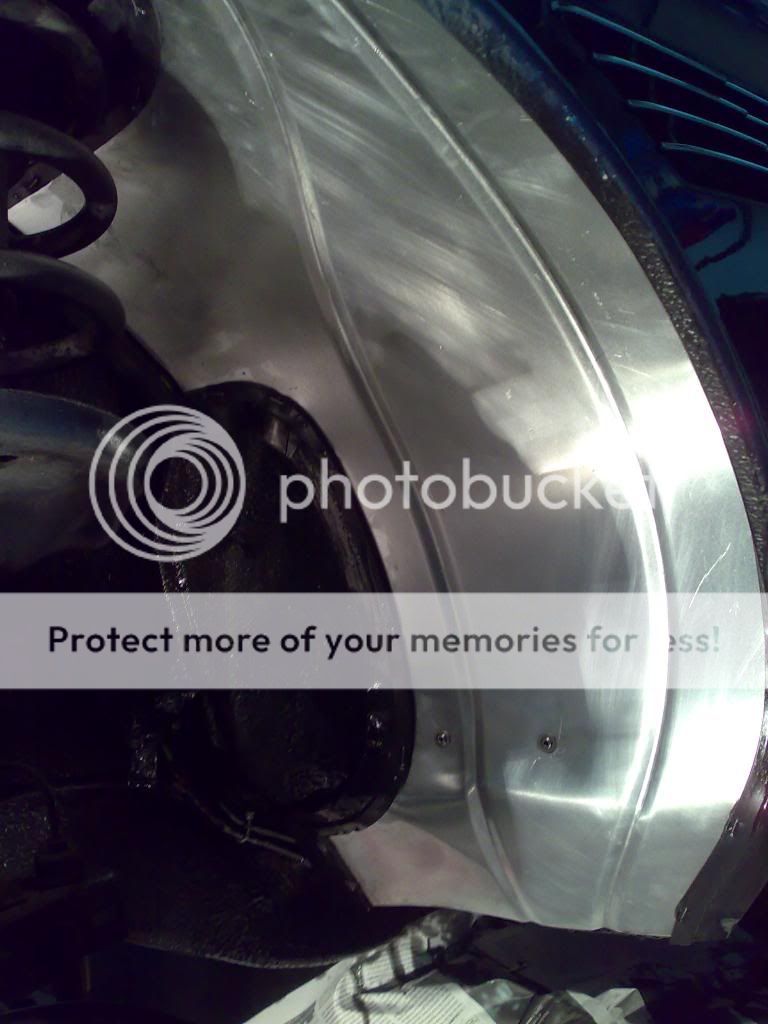

Not bad and certainly a country mile better than doing nothing. Without actually using the liners that’s my best & most honest endorsement. American cars used rubber edged baffles like that on many of the cars in the fifties. After the undercoating broke down and the rubber dried out they ended up rotting where the rubber gasket touched the inside of the quarter panels. Because of that I would suggest going a slightly different route on the installation. I would suggest spending extra time on the mounting system and make the liners so they can be un-bolted and easily removed. That way they can be removed every so often to blow out whatever road dirt has accumulated and you can also inspect and maintain or freshen up the fender’s undercoating. I would also lightly abrasive blast the down side of the liner so undercoating would have a chance of sticking. Once I had the liners installed I’d caulk the edges of the rubbers to the aluminum using “3M fast & firm” to actually glue the rubber edges to the liner. After allowing the caulking to set up for a day or two I’d undercoat the aluminum to kill the race car look. AGAIN, I’ve never installed or even seen these liners but that’s very likely what I would do if I did. ~ John Buchtenkirch
P.S. I will just add that our coupes are sort of strange in the eyes of a body man :roll:. The front fenders are built open style (no fender skirts) like a fifties American car. The rear has a full wheel house that’s spot welded in just like any late model car. So in my eyes, unfortunately it’s a car constructed with 2 completely different eras of manufacturing. Imagine how many more coupes would be around today if they had plastic front fender skirts installed from the factory. Many people love the coupes and think they are worth saving, it’s just that rust repair costs become too expensive.
