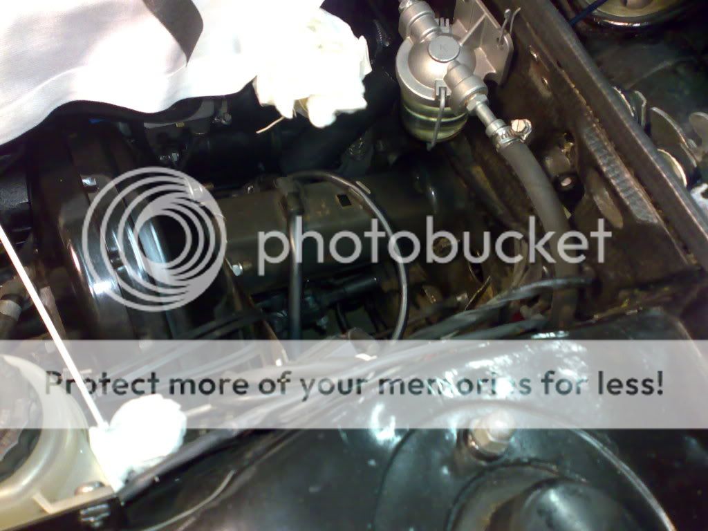

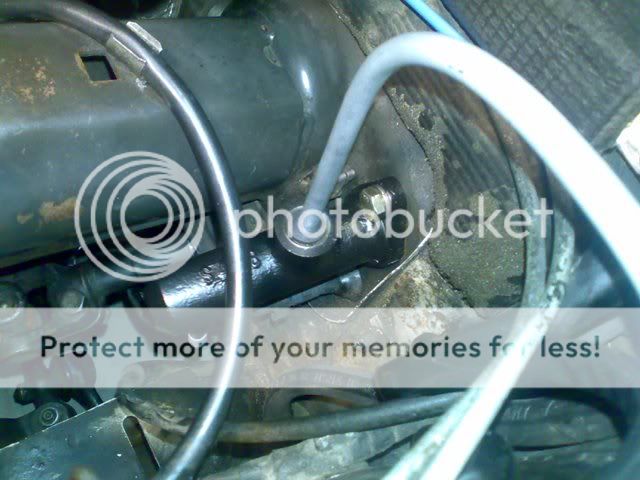

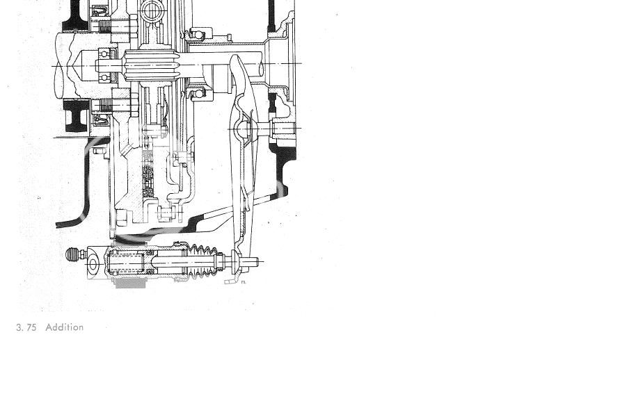

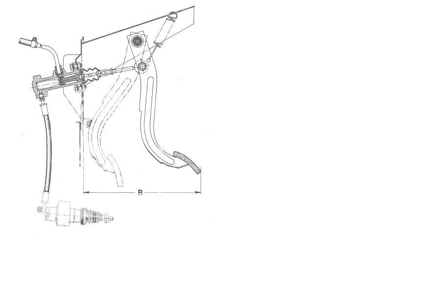

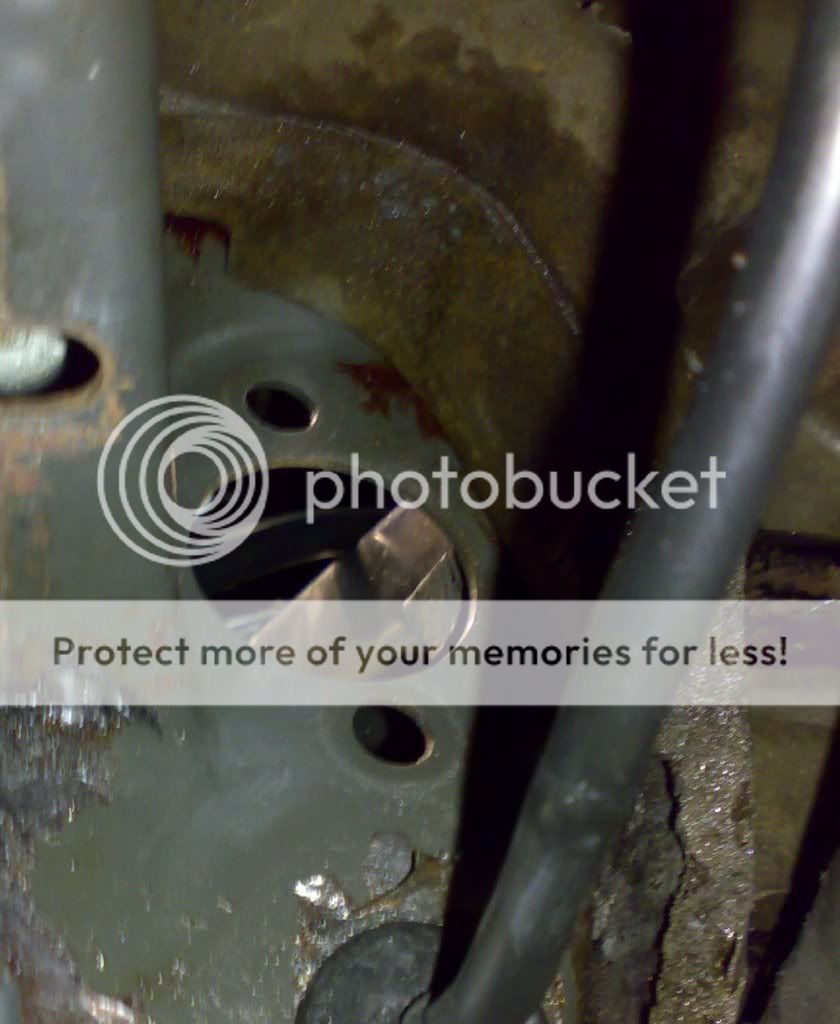

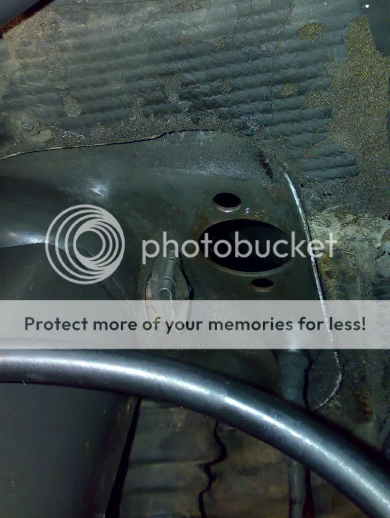

problem: leaks from the master cylinder inwards the pedals area
my car was made in 1971, so this is the old system:
removed, out from the car:
got the replacements in bmw

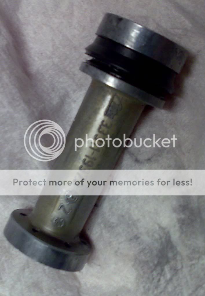

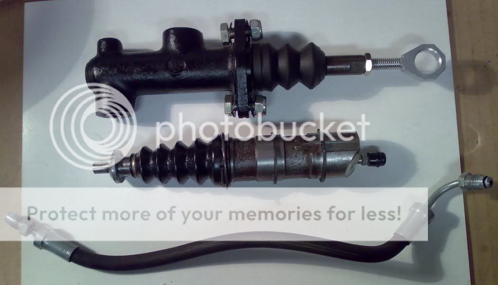

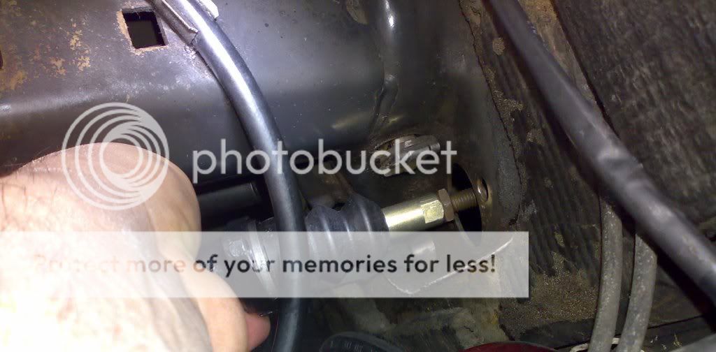

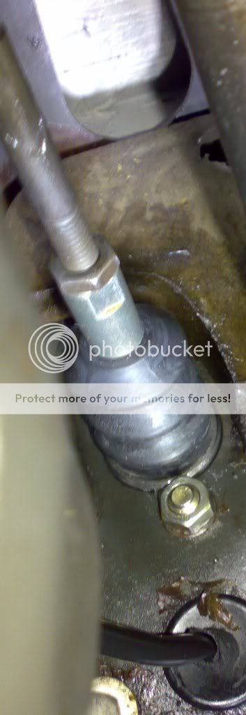

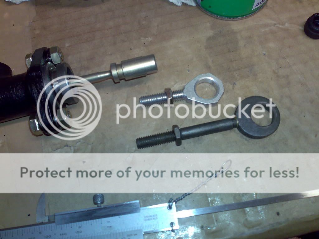

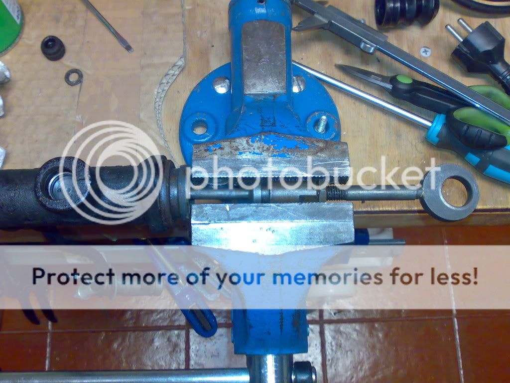

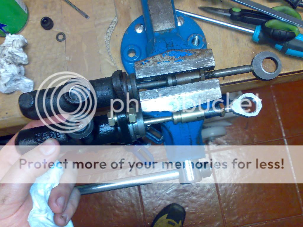

i found that the actuators were different
the new one is too short
so i swaped the old and the new, maintaining the dimmension from the plate to the pedal attachement: 140mm
done

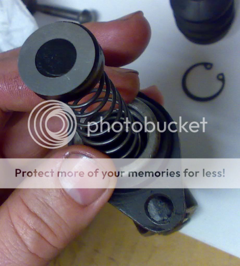

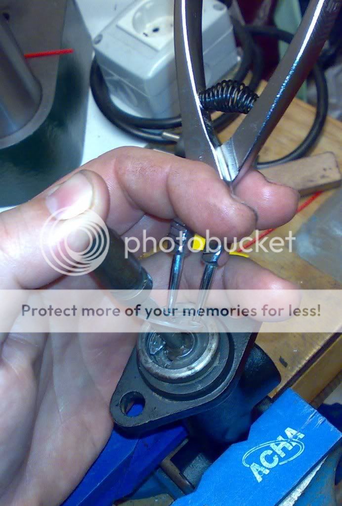

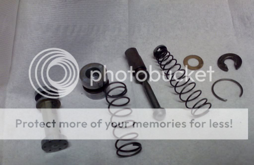

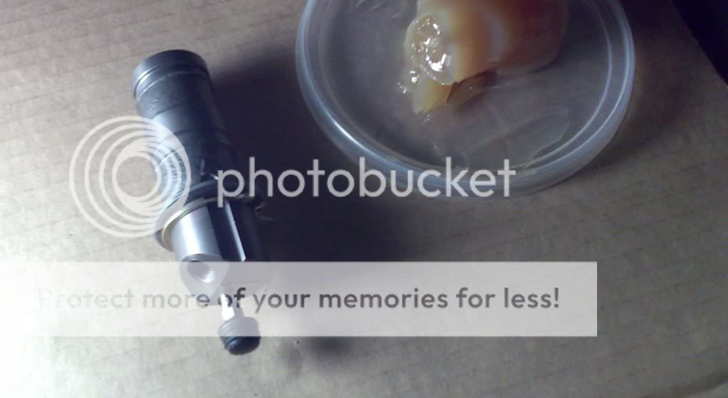

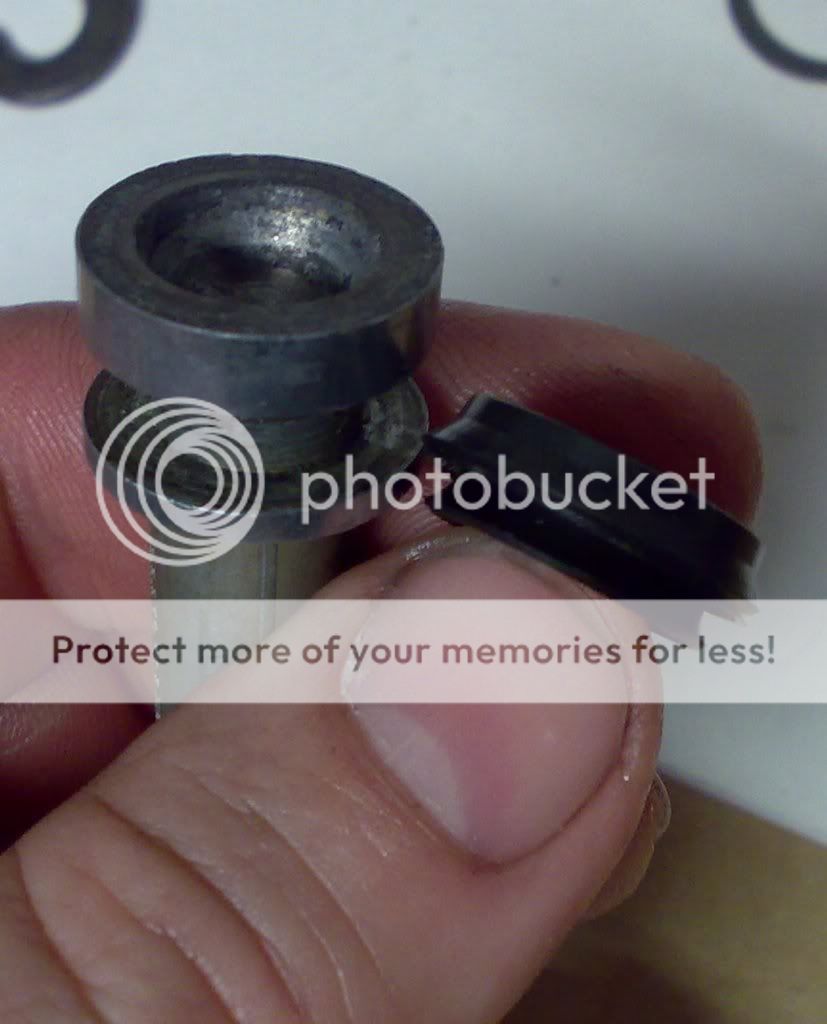

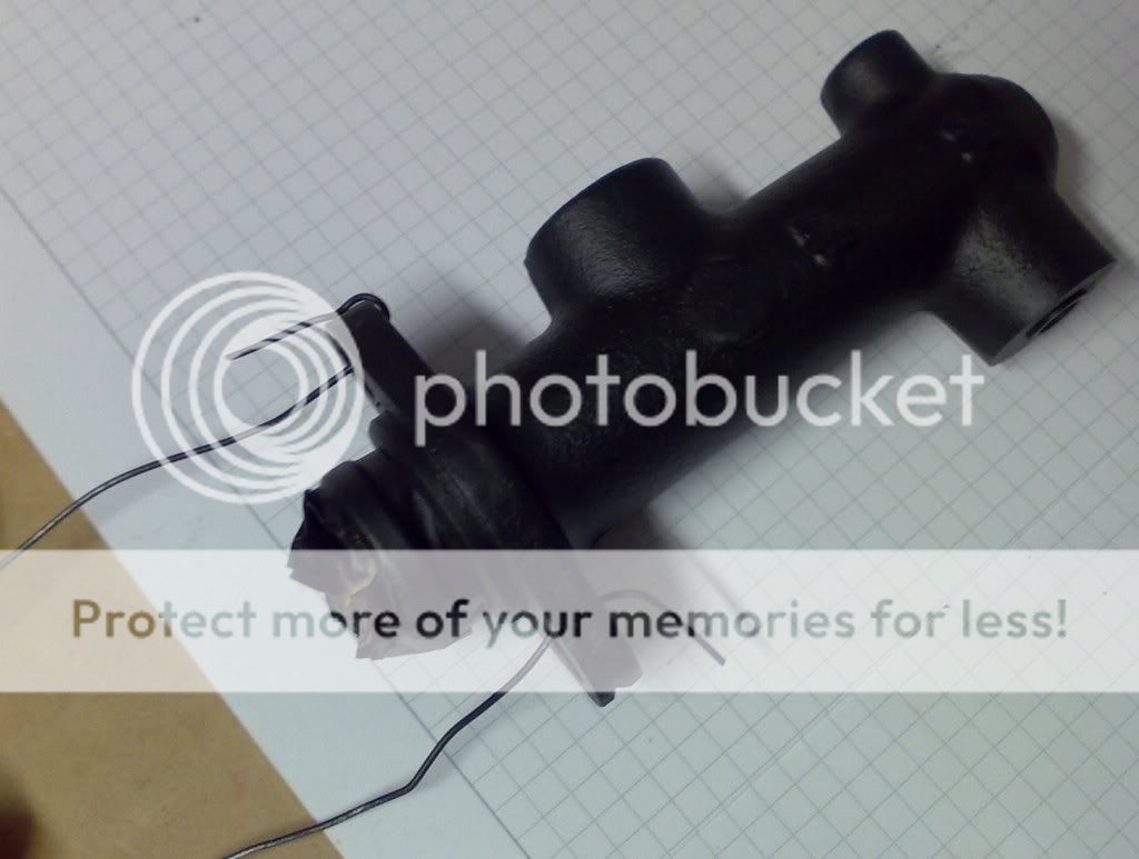

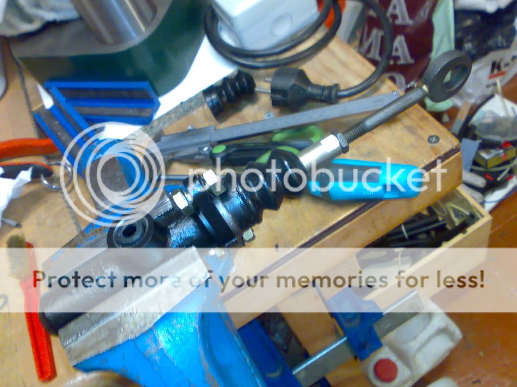

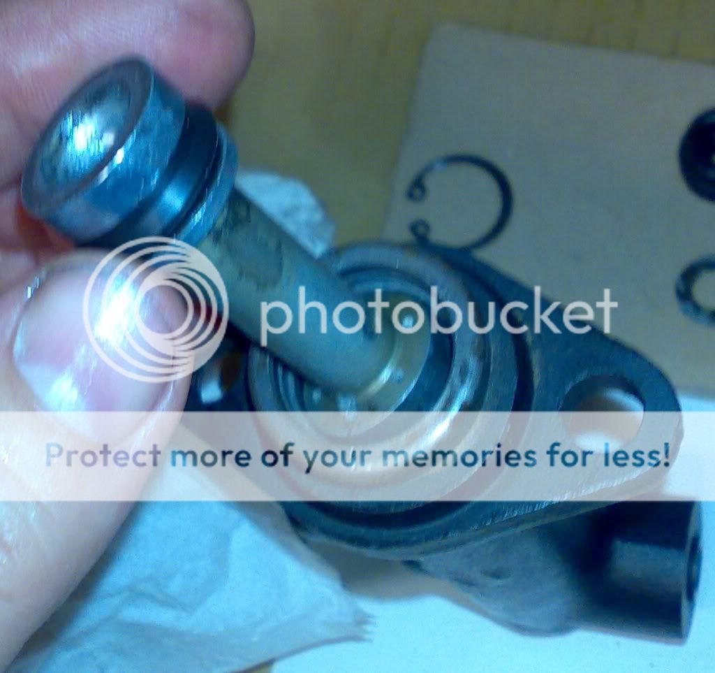

renewal of the existing parts

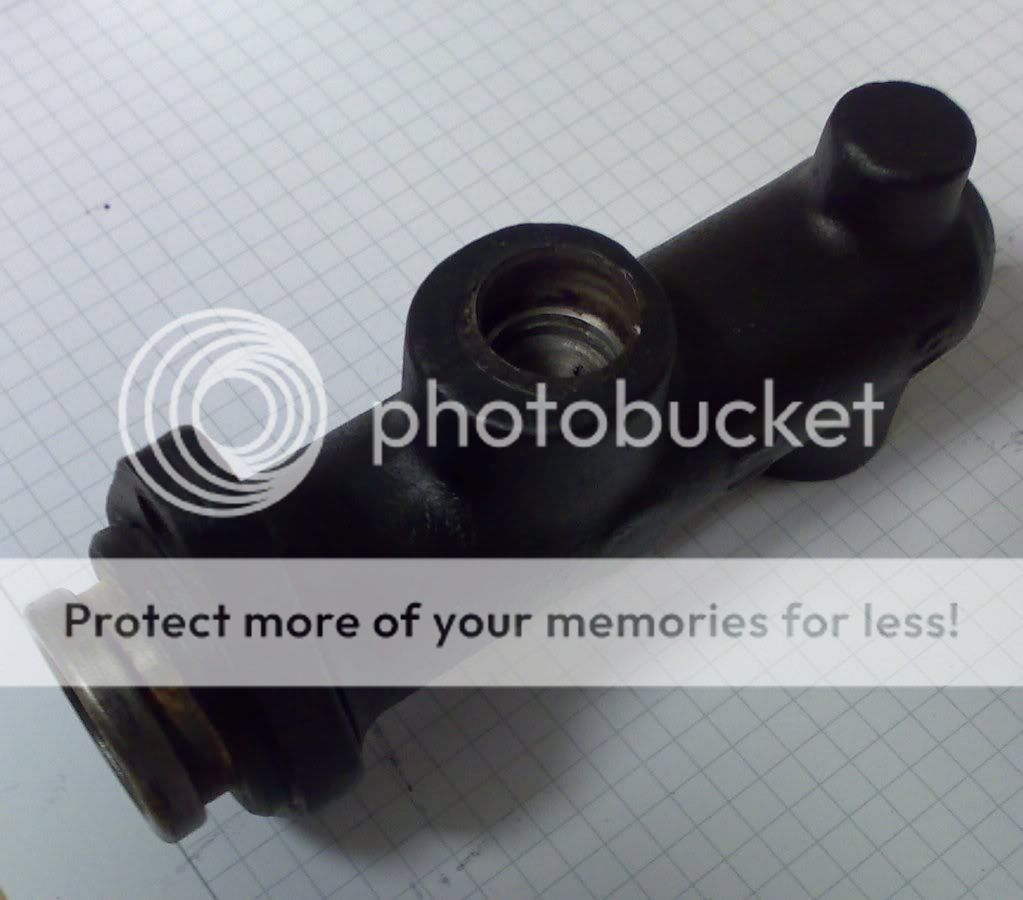

by the way, there is no really need of buying new parts, you can renew the old ones using appropriate kits from walloth&nesch:

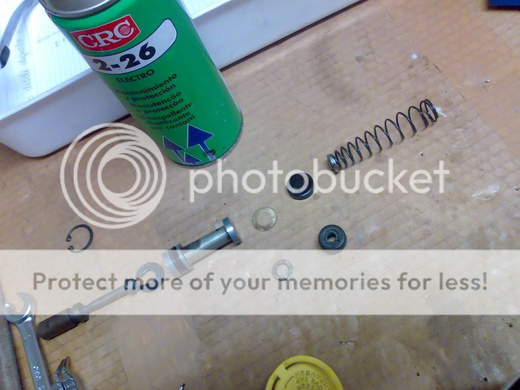

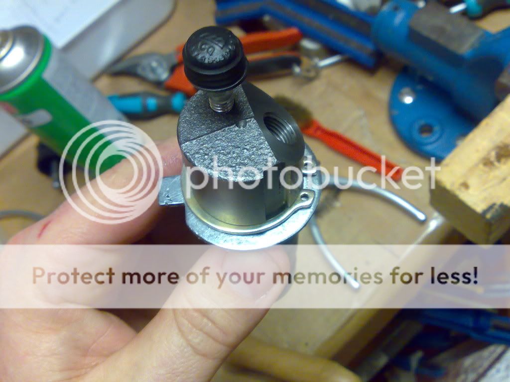

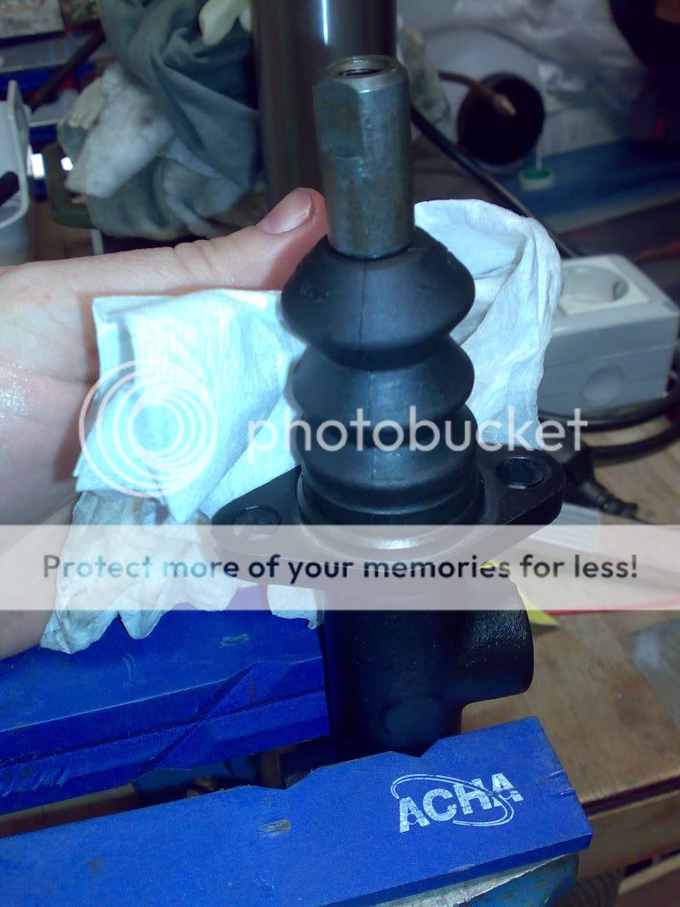

master cylinder:
here right-top you can see the w&n kit
correct posi
tion

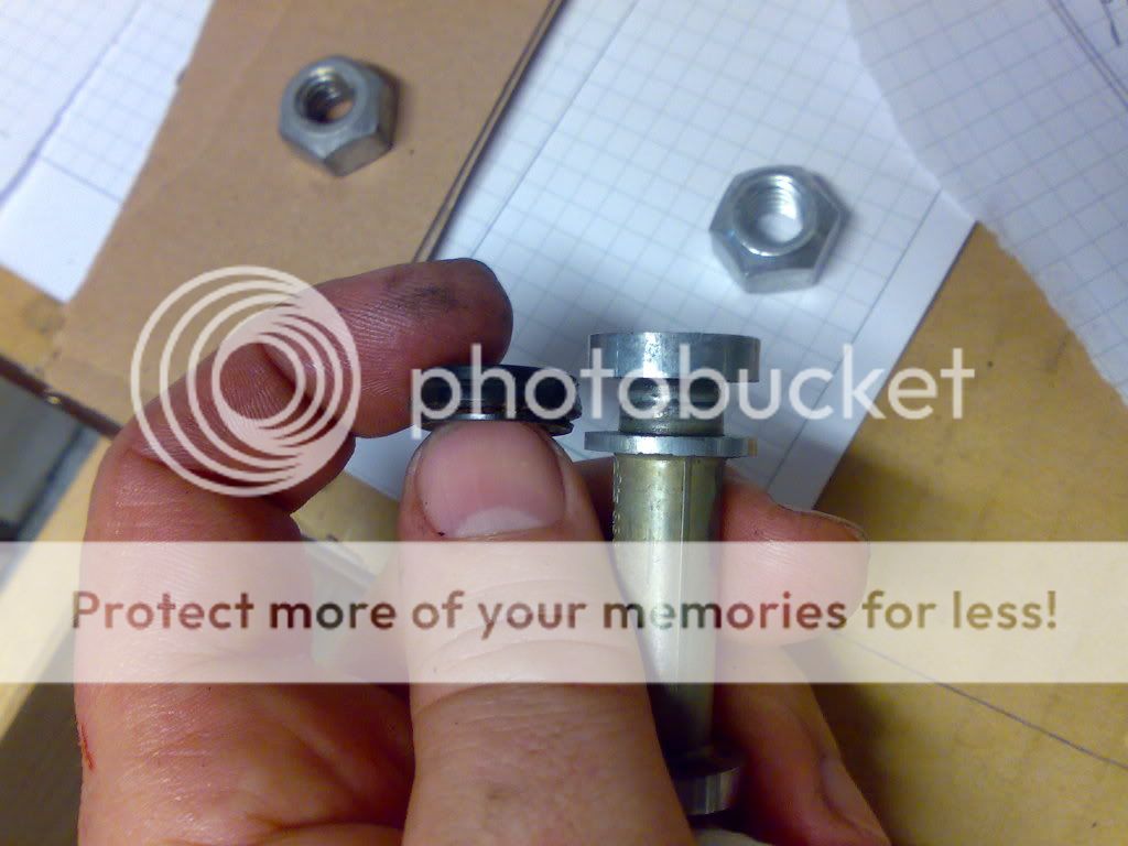

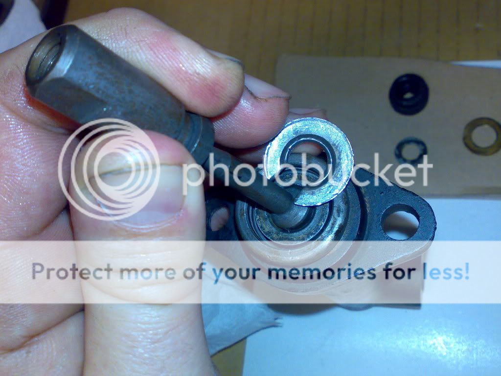

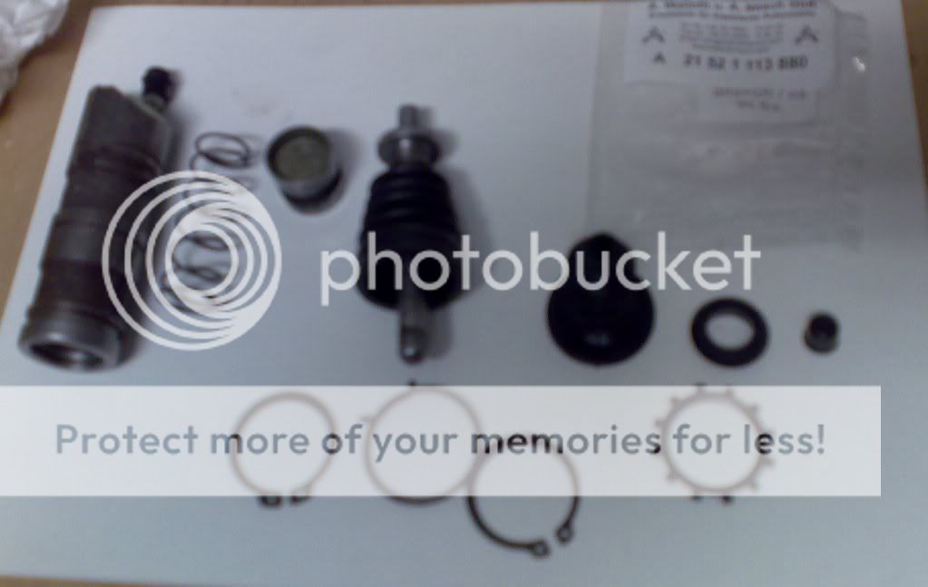

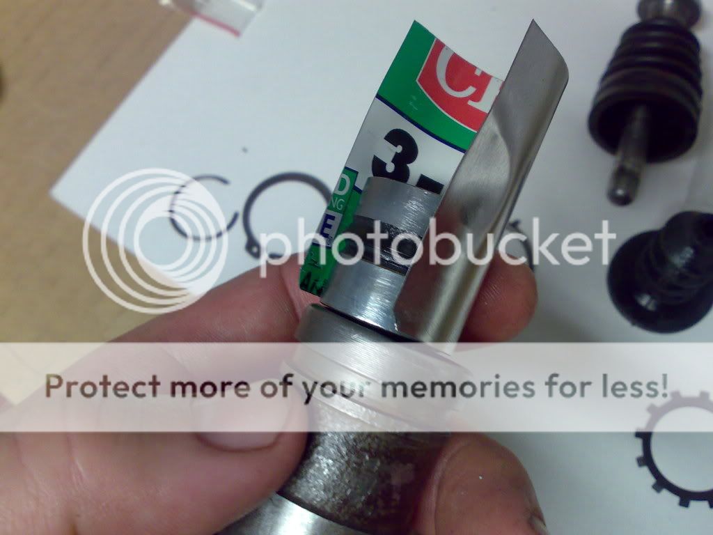

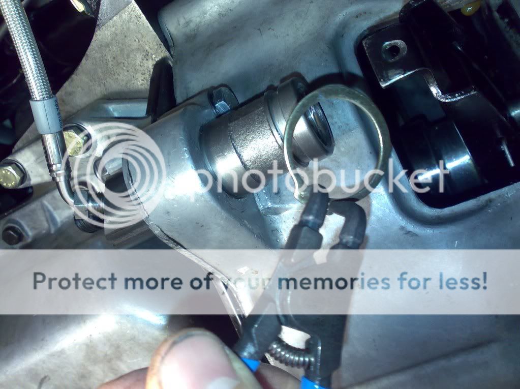

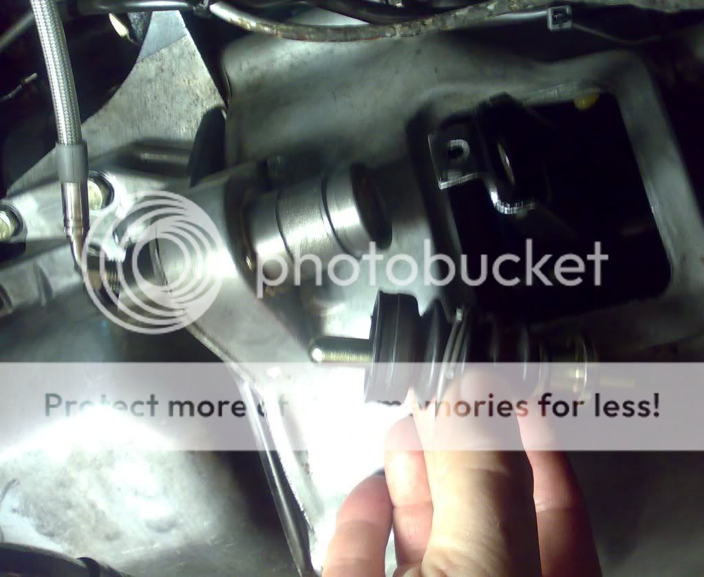

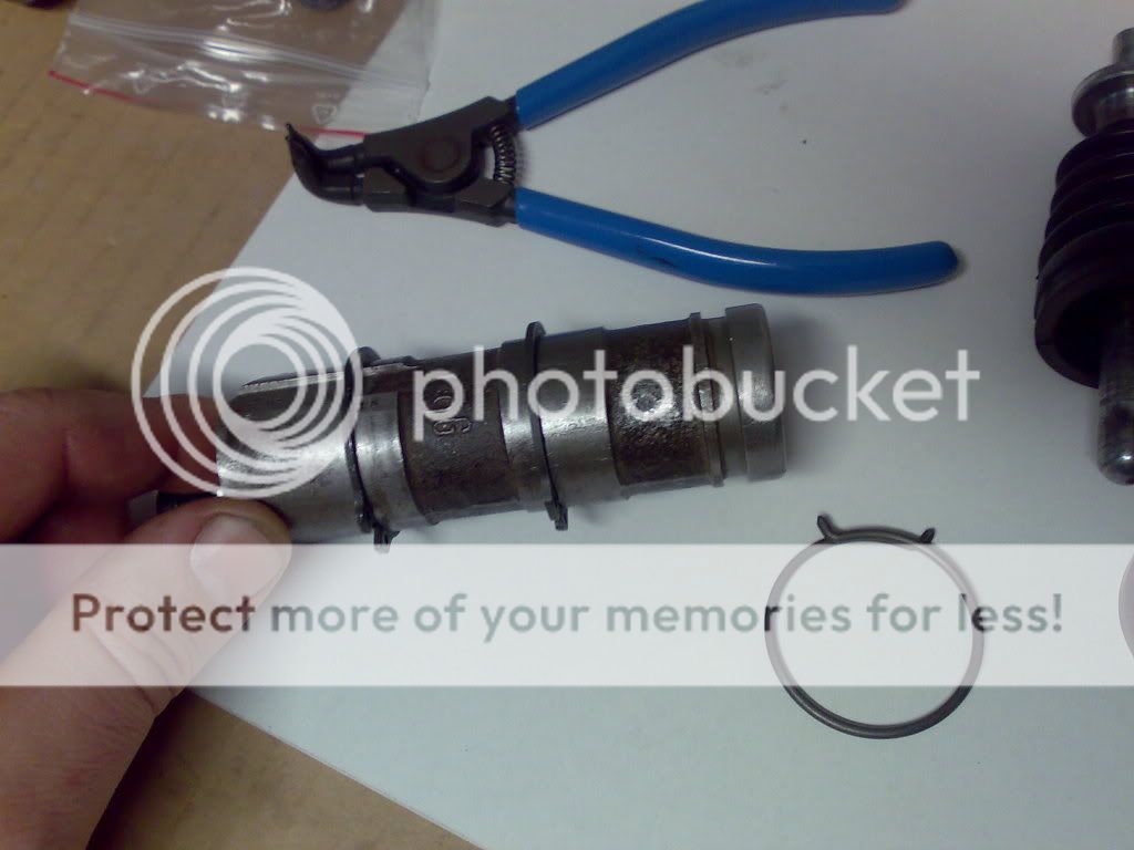

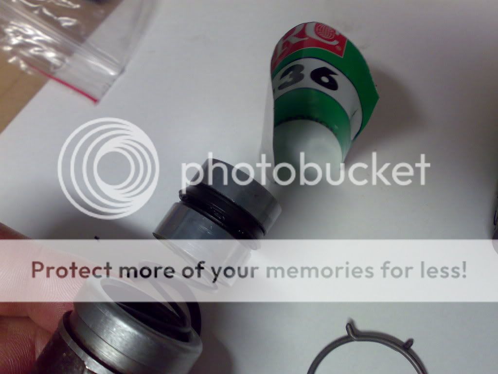

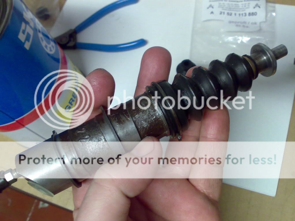

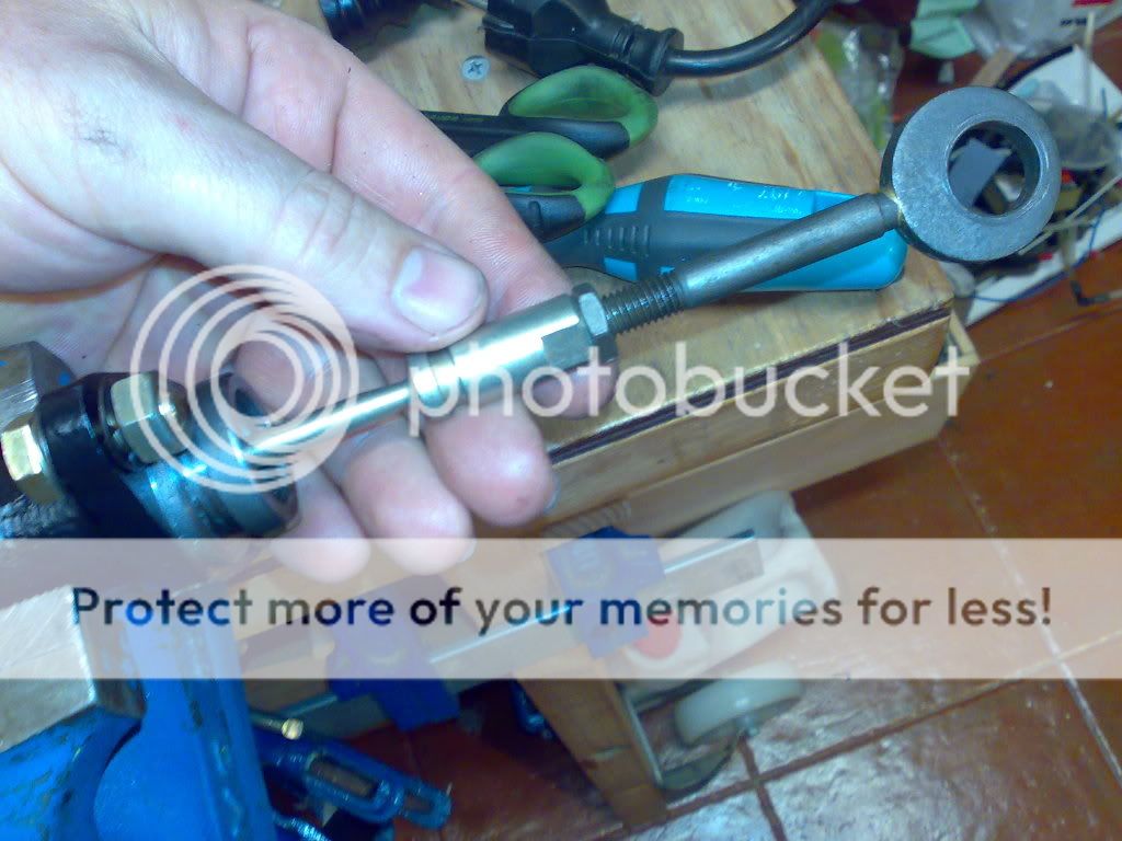

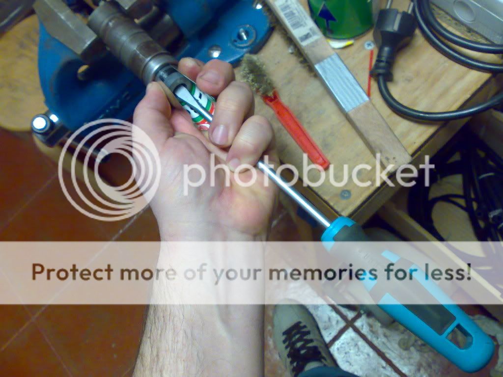

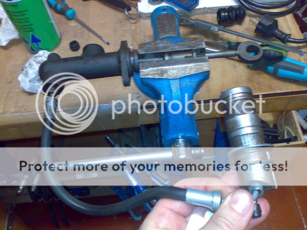

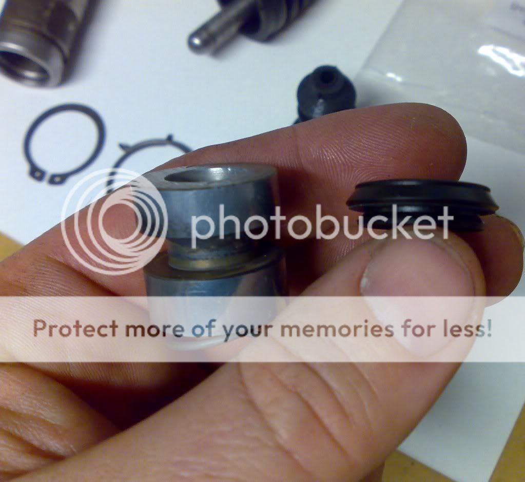

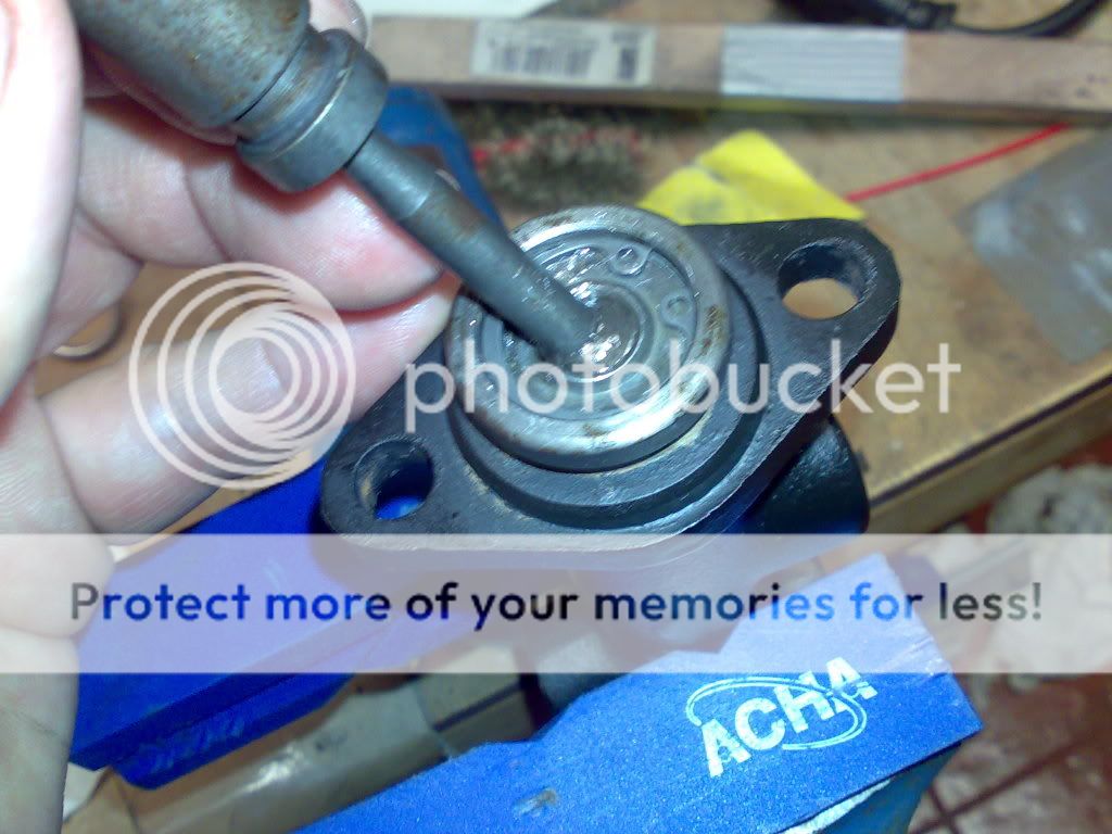

slave cyl
w&n kit right-top of the pic

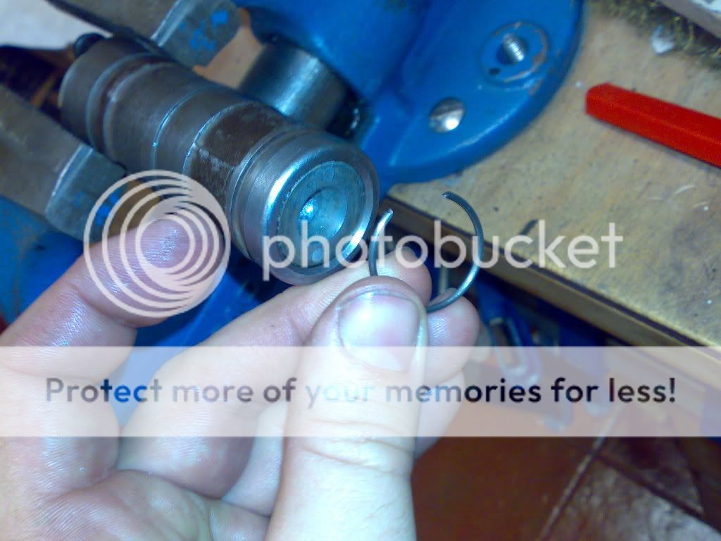

this one is difficult to introduce in the cylinder, so this tip will help

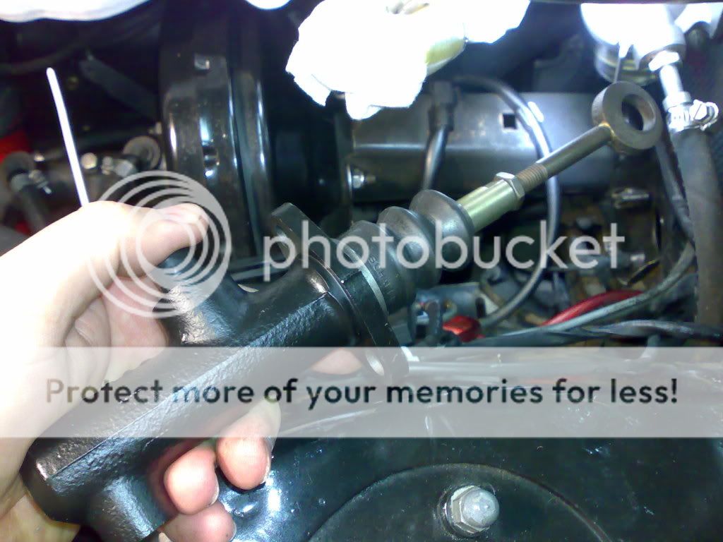

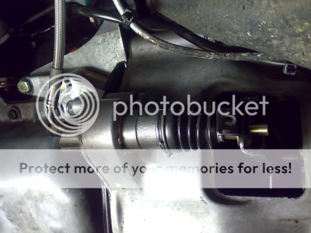

the renewed old set, prepared for a friend:

On Penske and Maximillian the 880 part number repair kit is listed for the other style "inside" slave cylinder - this kit also fits the old style "outside" cylinder too? I have same setup as you.
of course: (the last figure is the price in EUR)
the rebuild kit parts are:
A 21 52 1 102 625 repair kit master cylinder 19,50
A 21 52 1 113 880 Repair kit for slave cylinder
15,00
deQuincey
Quousque tandem...?
8,442
2,462
well, yes, i have used this 880 kit in the old style slave cylinder, and the result was good, the only drawback, is that i do not know how to install the flexible cover that comes with the kit (the one that should go in the push rod), fortunately my old flexible cover was quite usable, so i didn´t replace it

Great write-up and photos! Some comments to assist others giving it a go. The condition of the bores in both the master and slave cylinder should be inspected closely. Typically very minor pitting can be removed with a hone attached to a power drill. Anything deep enough to catch with your finger nail will require a specialist to re-sleeve. This is common and shouldn't cost too much. Stainless steel sleeves will resist further pitting from the moisture in old fluid.
There is also a two piece nylon bush that goes in the pedal pivot bolt hole. Costs only a few cents and should be replaced as a matter of course.
Repair kits are available from ATE directly or BMW dealers. Prices vary so W&N can be a good bet.
bet.
+1, thanks for remembering this,
yeah, the nylon bushes are unexpensive, available at your favourite bmw dealer, and really necessary to complete a good renewal of this key system
together with a new self locking nut, and the correct torque setting, 25 to 30 N.m
do not forget to pour a little long term grease in the points specified in the blue manuals too

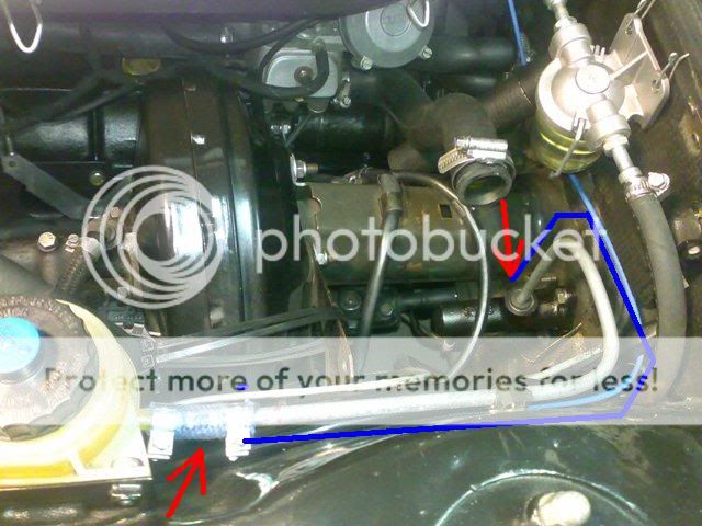

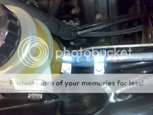

adding some info on the rigid hose that goes from the brake fluid reservoir to the master cyl
difficult to assembly, lubricate a bit with brake fluid to insert the hose into the master cyl
