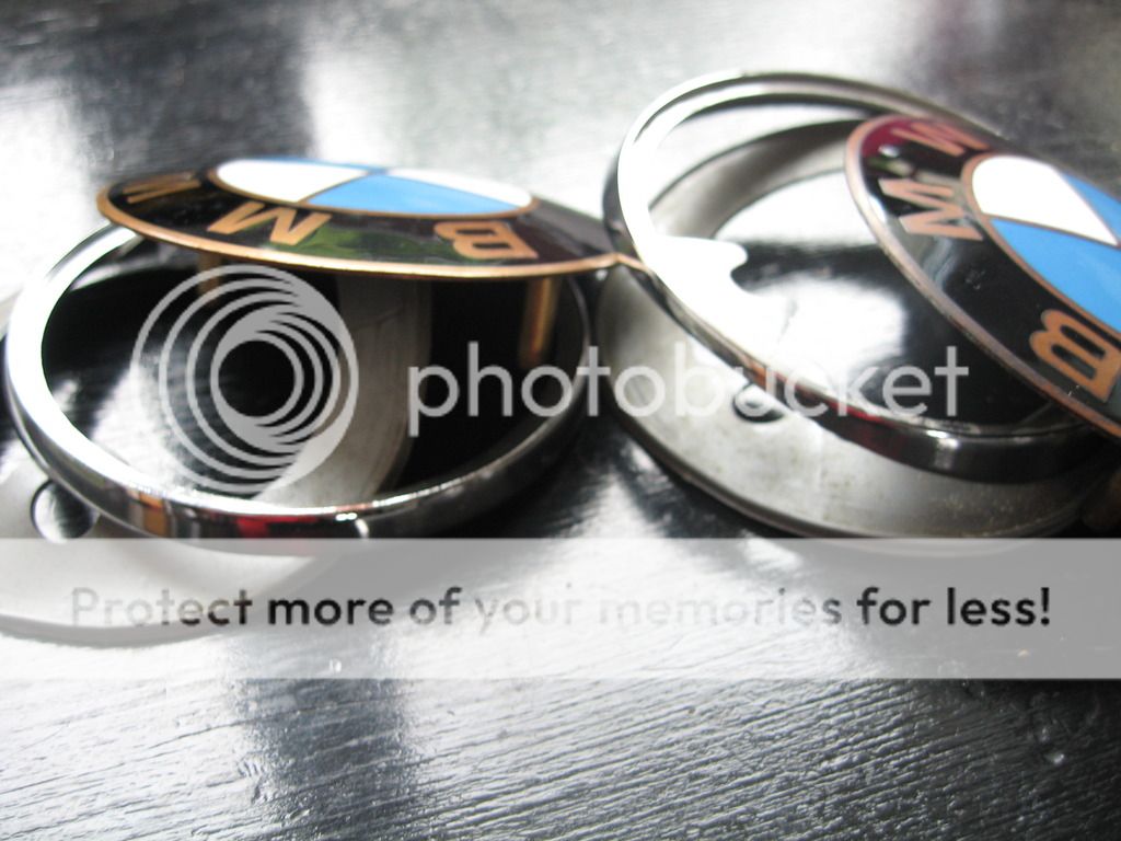

5 years ago I decided to change my front and back roundels.

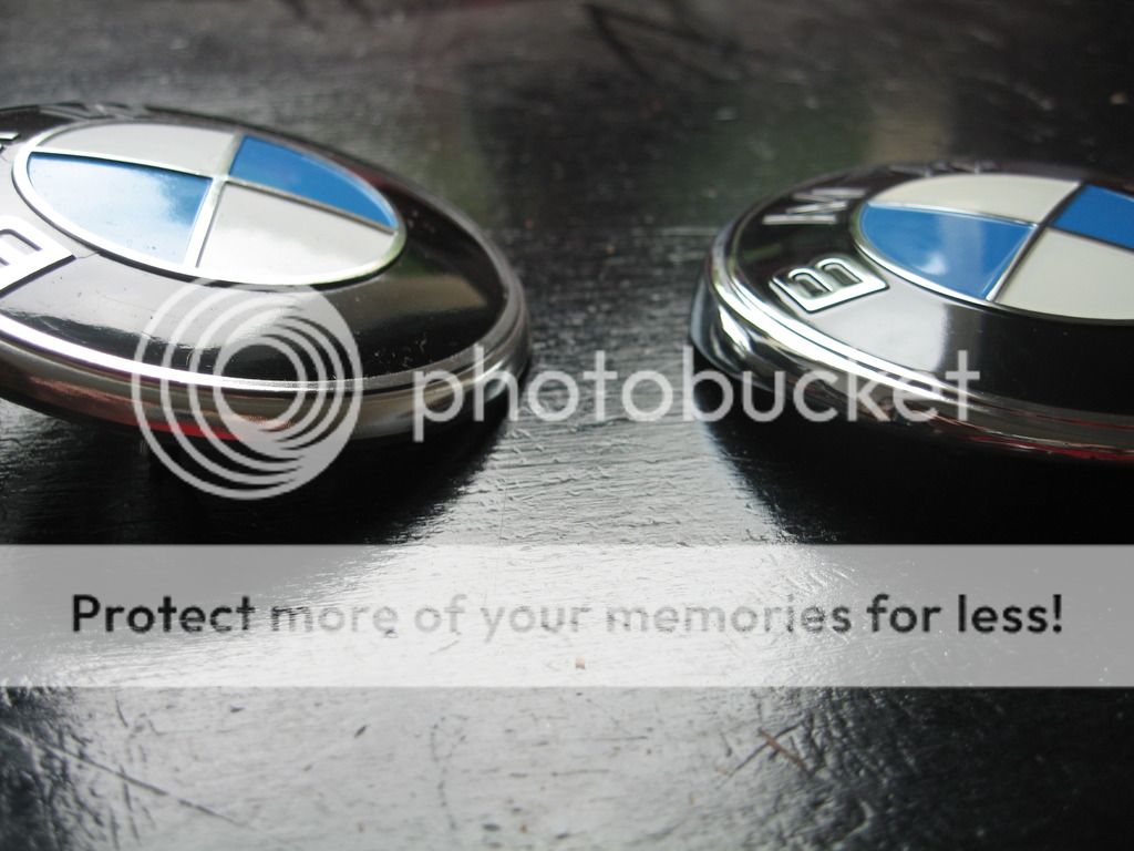

Original mounting was this one (Front and back) gasket-socle-emblem.
I tried to buy new emblems by BMW dealer and was given following "integrated" socle-emblem..
But the curve of the "integrated trunk" item did not fit correctly the shape of the beauty.

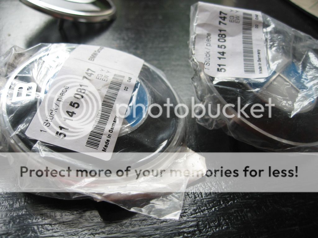

I then decide to buy the universal raised-letter emblem (right on pic..) 51 14 5 081 747.
I had to insist by the dealer, as both integrated items were bought on the latter ref !!!! (see pic where you have one front integrated and single universal emblem, under same ref)...
There can not be 3 same ref for 3 different items...
I think this must have been a bit confusing for dealers for a while...
This is the solution, I suggest you...
Marc..

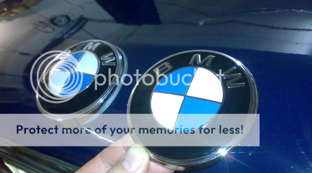

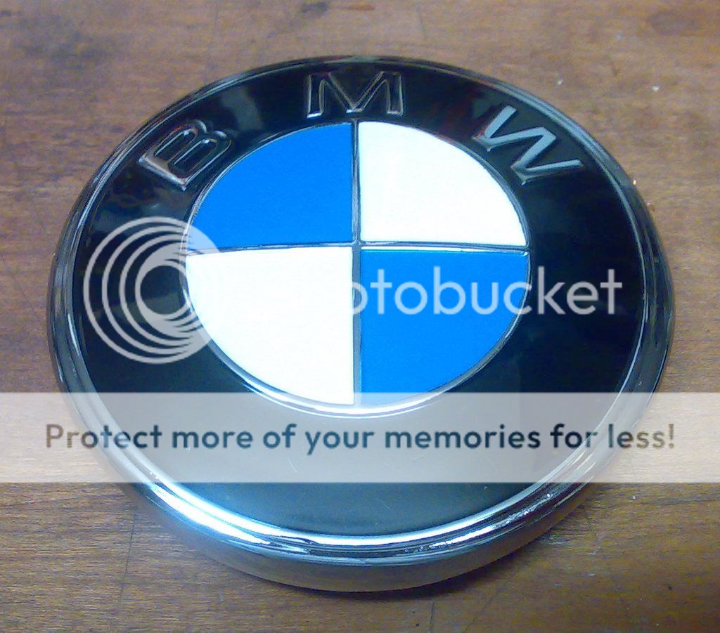

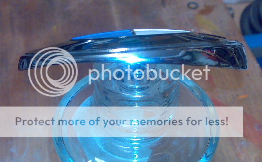

conclusions, the 833
IT IS ALUMINIUM WITH RAISED LETTERS
IT IS NOT A SINGLE PLATE OF THE EMBLEM, IT INCLUDES THE SHAPE TO MATCH THE TRUNK, SO THIS PART IS NUMBERS 7 and 9 together (be aware of the mistake in the drawing, as 8 is the gasket)
the gasket 8 is NLA
here are the pics:
a very good match to the original old style one: (they are the same size, consider that objects closer to the camera appear a bit bigger)
BTW: the dealer, mistakenly, ordered 2 ítems, I have bought only one for rsporsche, but if anyone is in need of the second unit i will be happy to buy it for him and ship it worldwide
